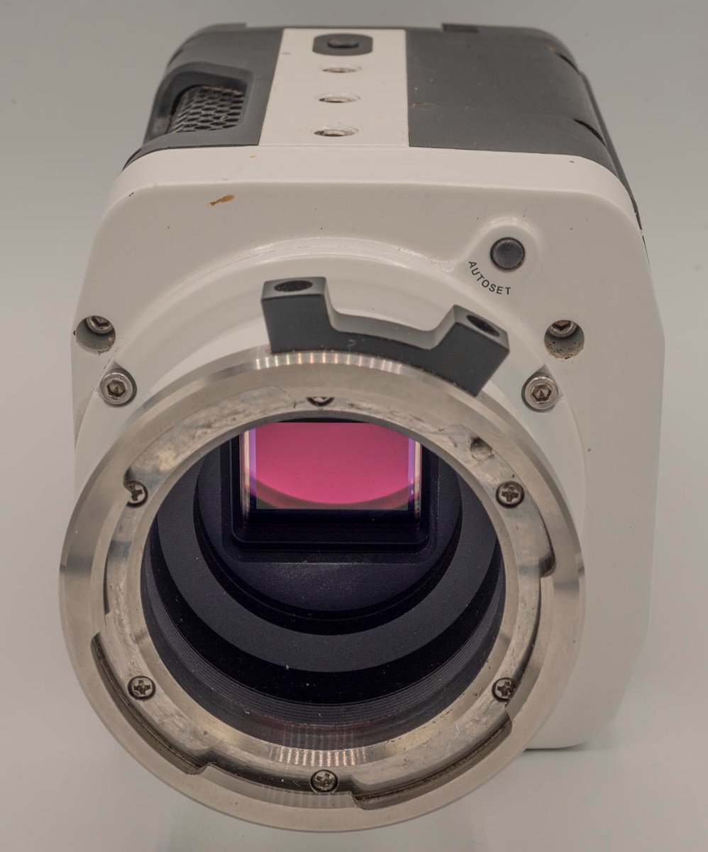

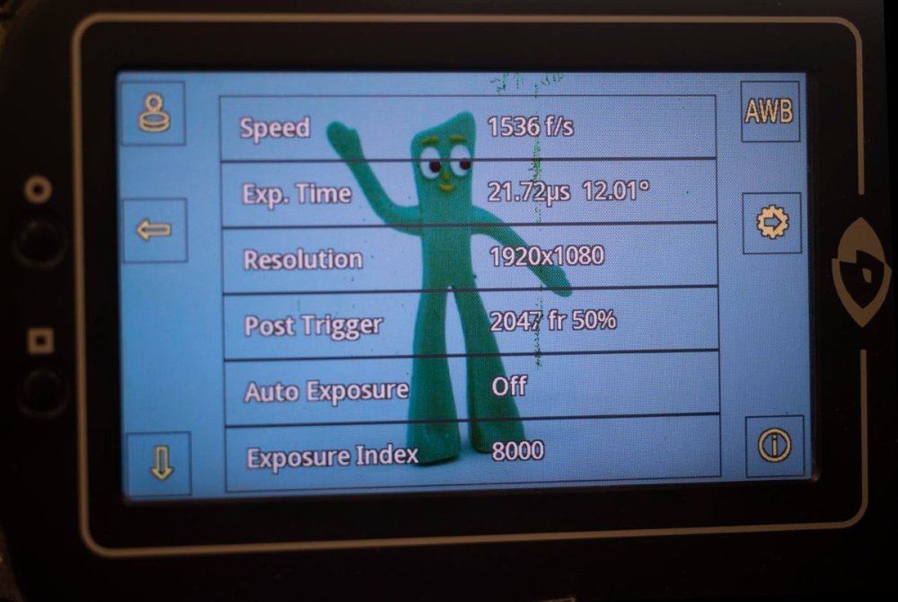

Premium Member Duncan Brown Posted April 8, 2024 Premium Member Posted April 8, 2024 Now that these are getting old enough to be afforded by mere mortals (or companies whose main business is not high speed cinematography) I thought I'd start a thread where we could share tips and tricks on these. I realize for many of you, I'm probably asking you to dredge up knowledge from a long time ago! We have one camera with a PL mount and one with an EF mount. Anything anyone needs to know that they think I could answer, I'd be happy to. My previous high speed experience was with 16mm film but I think I've come up to speed (oof) on these pretty quickly, so I hope I could be a resource. Questions for existing/past users: -- The touch screen is flaky, to put it mildly. It generally seems to be a matter of calibration - the touch area and the screen image don't line up well. Sometimes turning the screen off and on again seems to help, so maybe it recalibrates when you do that? If you figure out the right offset to touch, to do what you want, then the next thing you want to do you'll find the offset is off-screen somewhere so that doesn't help. The most commonly frustrating thing is trying to change the capture rate. Many other things can be done remotely from the app on a PC, but seemingly not that. -- The PL mount seems to be thicker than spec. I haven't taken it outside to see if I can reach infinity, but other clues, like a zoom that changes focus massively when zooming, lead me to believe that's the case. I got several shim kits with the cameras, but adding shims seem to make the problem worse. It came with no shims installed. Thus my guess that the lens is too far away from the sensor, not too close. -- I'm still working on getting a computer set up to read the Cineflash cards so I may be able to answer my own question eventually but it would appear to me that there is no way for the camera to format a new blank card, is this correct? (It's new and blank because I replaced the dead micro-SSD inside it). Also, anyone know if you solder on a second connector on the circuit board inside and install another micro SSD in it (and reformat it), if it will magically become a 240GB Cineflash? Or is there more to it than that? Duncan

Jaron Berman Posted August 10, 2024 Posted August 10, 2024 Great camera, capable of tying itself in knots pretty quickly. You've already discovered that the PC software is VITAL to making it function, and that includes the every-so-often need to reset it. Especially with the paint stuff - you can be looking at a miserable image via SDI / LCD and it can sometimes spill onto the RAW file as well. Some issues do some don't, hard to know which will ruin your footage. The screen issue is a KNOWN issue. I tried to send mine in to Vision Research and they got on the phone and talked me through some troubleshooting (PC reset). But the bugginess in the touchscreen is "in-spec" - and the screen is meant to "sometimes" be used but not relied upon. So yours is not broken, it's working as expected. From what I could figure it was a grounding issue and maybe I'm remembering wrong, but I would sometimes have luck operating the screen with left hand while holding the shell of one of the BNC or LEMOs with the other (I recall them being all tied to ground). Find a good USB (+ external power) to SATA cradle - the power is 100% necessary. Download and make a "portable" ubuntu USB thumb drive so you can use any computer to file manage the drives. Have fun with it!
