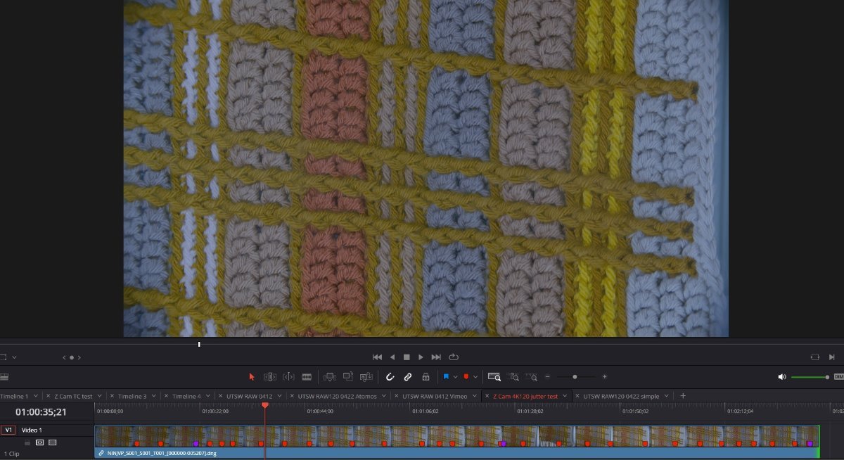

Nicholas Mirro Posted April 24, 2024 Author Posted April 24, 2024 (edited) Here's what the juddering looks like... It's 4K so lots of detail. I was thinking that much panning detail might overwhelm either the camera or Ninja's processor. But I found some footage showing mostly sky and it had the same problem. Edited April 24, 2024 by Nicholas Mirro
Premium Member Aapo Lettinen Posted April 24, 2024 Premium Member Posted April 24, 2024 4 minutes ago, Nicholas Mirro said: Here's what the juddering looks like... It's 4K so lots of detail. I was thinking that much panning detail might overwhelm either the camera or Ninja's processor. But I found some footage showing mostly sky and it had the same problem. seems it drops complete frames but l would suspect it is the camera and not the recorder. kind of like shutter/framerate mismatch but probably something else. how it looks like when you inspect the jitter frame by frame, is there a repeating pattern and how it behaves when counted the frames?
Nicholas Mirro Posted April 25, 2024 Author Posted April 25, 2024 Quote how it looks like when you inspect the jitter frame by frame, is there a repeating pattern and how it behaves when counted the frames? There are two types of jutters. For the red markers, the frames seem to follow this sequence... 1, 2, 3, 2, 3, 4, 5 For the purple markers, there is a partial frame at the top. The top ~5% of the image is from another frame, or maybe the bottom 5% stuck on the top. Easier to see this screenshot if opened in a new tab. The shot is a continuous vertical tilt (pretty fast) over this fabric. It's shot at 4K120 and played back at 30.
