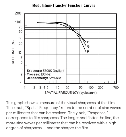

Premium Member Aapo Lettinen Posted August 18, 2024 Premium Member Posted August 18, 2024 with video you would get pretty flat MTF response whereas with film it first resolves great and then starts to fall quick in contrast the smaller details you try to capture. If having larger film format you will fit larger amount of the image's smallest details to that flat-ish part of the curve, thus having them higher in contrast, thus appearing sharper. screenshot from V350D technical paper
