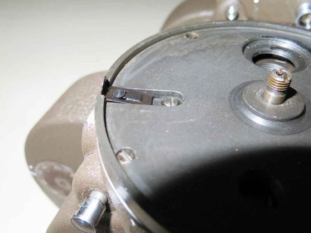

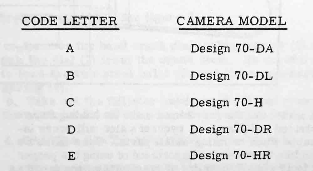

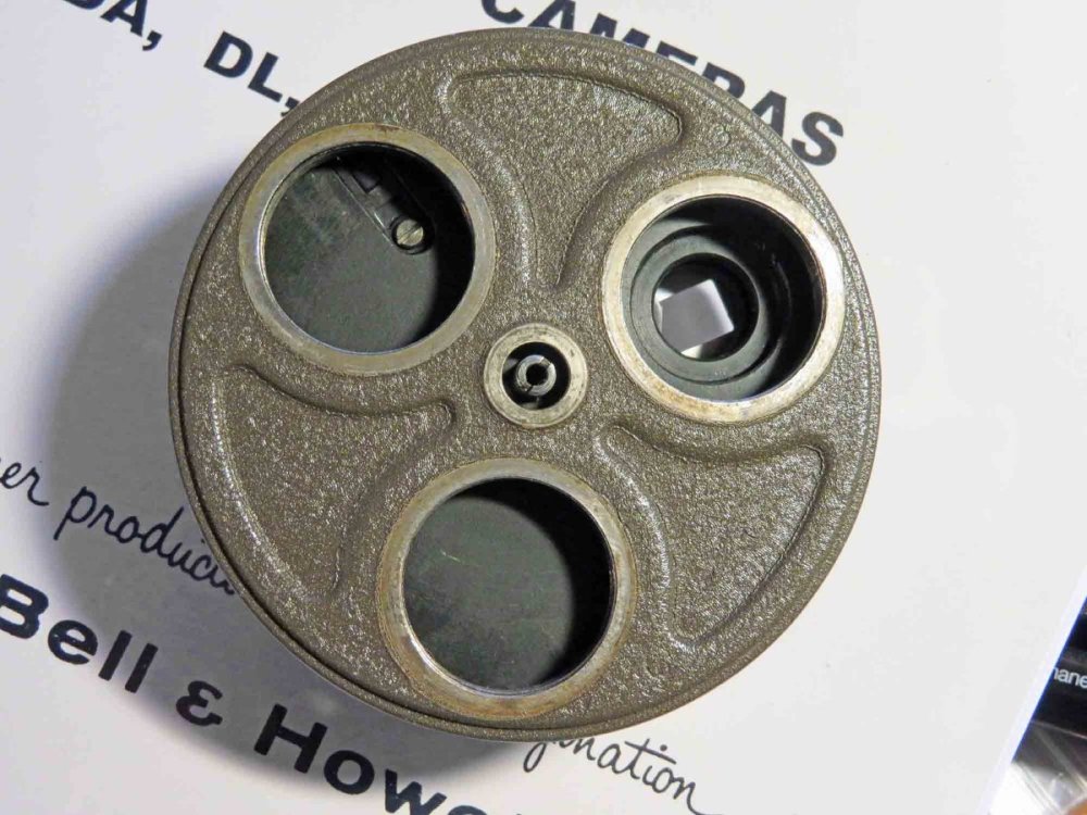

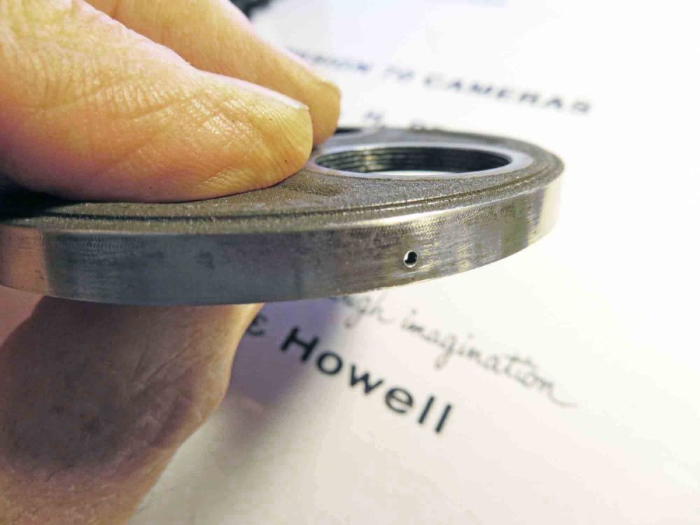

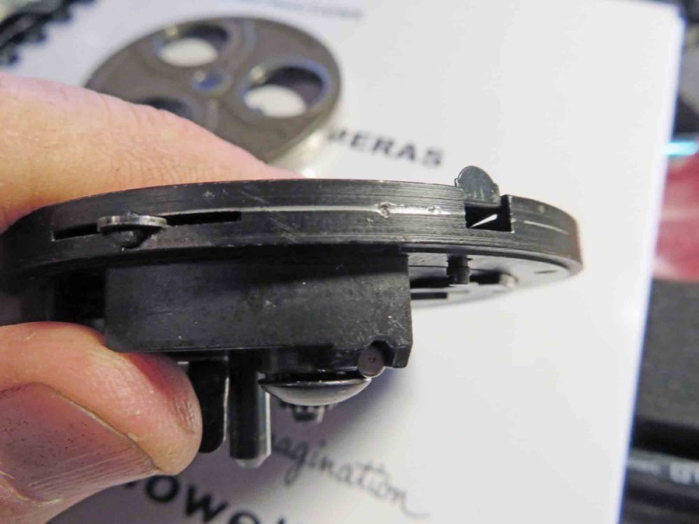

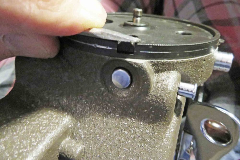

Matthew Hall Posted November 24, 2024 Author Posted November 24, 2024 (edited) I don't know if this affects the trigger mechanism and is causing the problems I am experiencing, but I have discovered something about the history of this camera. It came with a 115 volt motor attached, which as Simon pointed out indicates that this was an indoor camera, likely used in a studio setting. The question that I have always had was why the turret exchange? What was the desire to dis-engage the lens turret from the viewfinder turret? Well, I have found a few clues on the body of this camera that point to an explanation. I noticed that a hole has been drilled into the side of the turret. Upon inspection using a loop it appears that this hole is also threaded. I then looked at the front plate and noticed an indentation in the side of it that corresponds to the hole in the turret. As you can see in the photo, when the hole and indentation are aligned, the turret is lined up with the shutter as when set to the RUN position. This small indentation was apparently made by a set screw (or grub screw as some call them). Whoever was using this camera did not want the turret to be rotated and apparently made sure that this could not happen (although notice the line on either side of the depression indicating that the turret was turned slightly with the set screw still protruding a bit. This line is only directly on either side of the depression and does not run around the front plate). Likely this was used with only one lens and did not need the option to rotate to various other focal lengths. The reason for the turret swap is now obvious. The toothed turret is MUCH thicker at the edges to accommodate the toothed notches, and as such it would have been impossible to drill the small hole for the set screw as there was just too much metal to deal with. The non-toothed turret has a thin wall perfectly suited for this set screw. So what we have is a camera that was used in a studio setting, with just one lens, set to a particular setting and never changed. The internal gearing in this camera show little wear and it runs extremely quietly. So it does not appear to have been used extensively and worn down, as one might expect from a commercial setting in which this camera apparently existed. What this was used for may never be known but it is interesting. Edited November 24, 2024 by Matthew Hall
Matthew Hall Posted November 25, 2024 Author Posted November 25, 2024 (edited) After playing with this a little more I have discovered that if I tighten the nut on the turret just hand tight, and by that I mean snug but by no means tight, I can get the trigger button to function properly in the LOCK position when tensioning the spring. It will pop out and lock so you cannot depress the button. If you loosen the nut even slightly, the button will pop out but you can depress it and the camera will run in the LOCK position. Tighten it just slightly and the button will not pop out and the camera instantly begins to run as soon as I release the winding lever. So there is a very small range of torque on the turret nut that will allow the camera to function correctly at ALL settings, but it is incredibly narrow. I also feel that the nut is so loose that it will begin to loosen further by itself after just one or two rotations of the turret. I guess I could put some sort of locking compound on the nut to keep it from turning (or remember to never turn the turret counter-clockwise), but just make sure that none gets down the oiling hole in the center of the axle. I feel that the proper solution is to get the correct turret for this model. I need the 70-DR version that has the toothed rim as that is the only version rated by Bell & Howell for this model. The one I have installed just seems to have a clearance issue with the plunger located in the leaf spring assembly. I have tried using various thickness washers under the turret to give it slightly more clearance to allow the plunger to pop up enough to release the trigger button but none have worked with consistent results. The service manual even states that the front plate and stop pawl assembly are different for the DR/HR models vs. the DA/DL/H models. So if I have a DR front plate/stop pawl and a DA/DL/H turret (which it appears that I do) the book says it work work properly. Actually it's kind of cool . . . . I found a way to get them to work together. It is not an effective method, but it will work, just under very limited conditions. Edited November 25, 2024 by Matthew Hall

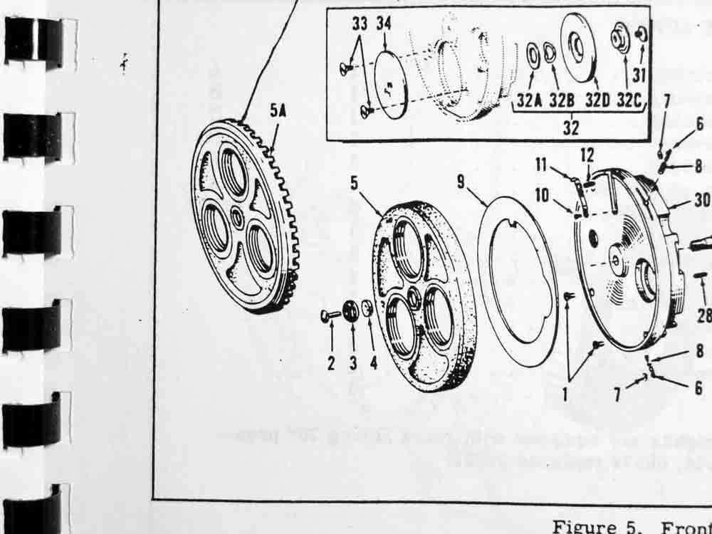

Premium Member Simon Wyss Posted November 25, 2024 Premium Member Posted November 25, 2024 Thanks for the photos Now I see that this was a -R turret the teeth turned off. The earlier turret is a piece of sheet steel drawn or pressed to the form, lacquered over. (the R stands for Revolver, in German; another Bell & Howell secret that puzzles me; K stands for Kassette, also in German, meaning film magazine; I continuously do research on the company and its products; it has perhaps to do with Bruno Stechbart, a Polish-German immigrant and B. & H. assignor) My English is not as precise as I wish it were. If I can put it like that: let the release plunger roll over a smooth flat surface such as a pane of glass or a measuring stone. That way you can detect hickups, bumps, nicks. This is a chromium plated brass part, if I remember correctly, so it’s wise to smoothen it out non-abrasively. The shaft of a screwdriver can be used or a pin driver’s. Work it over the burr in order to form the metals back to shape. Check, repeat until satisfactory. The bore in the camera frame can also be ironed out a little, the combination of both sides should give the desired result. As already said, less (to one side) is often more. Work to the main frame should be done away from the innards. —— Right, everything should be removed from it. 🤪

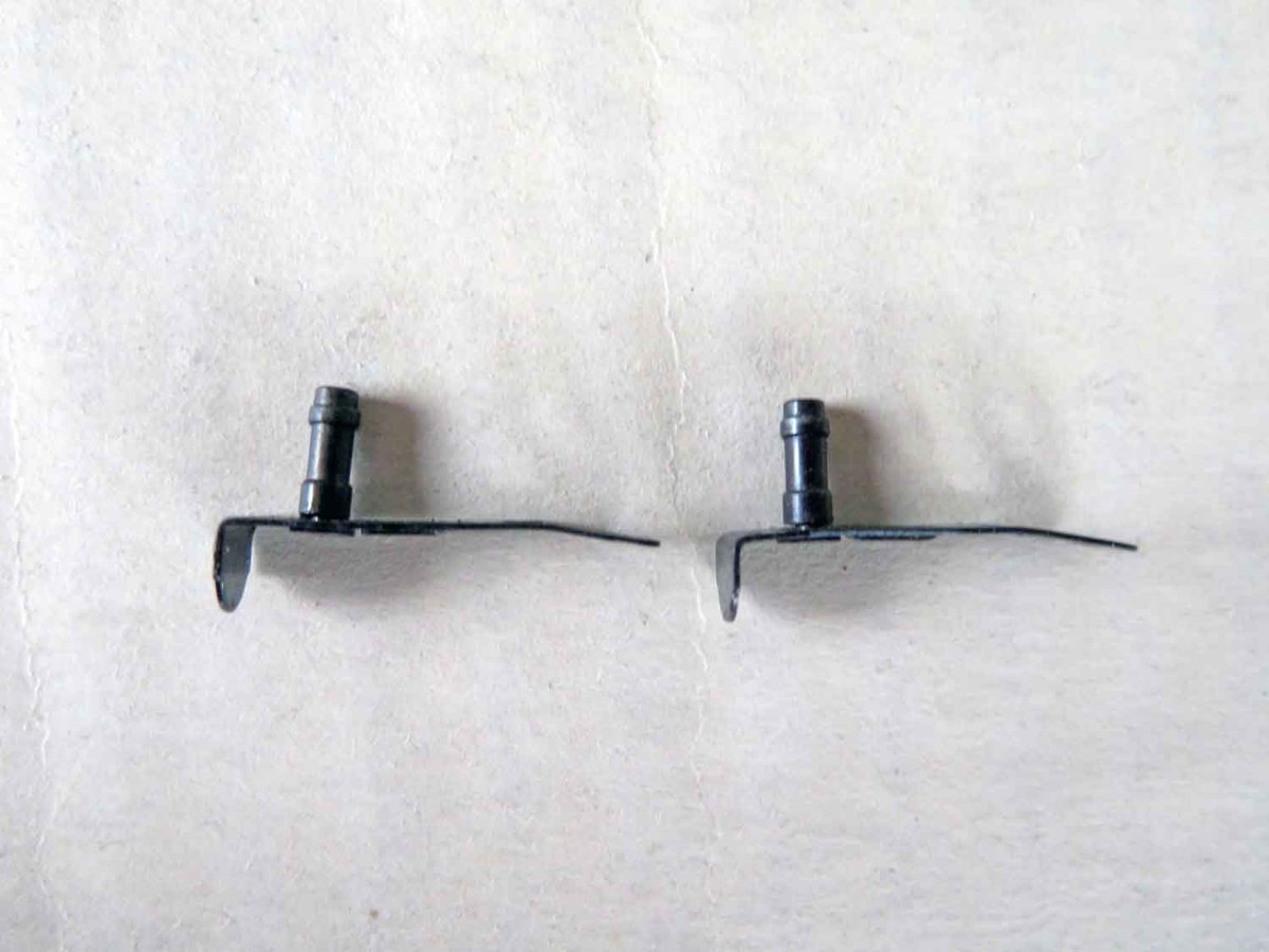

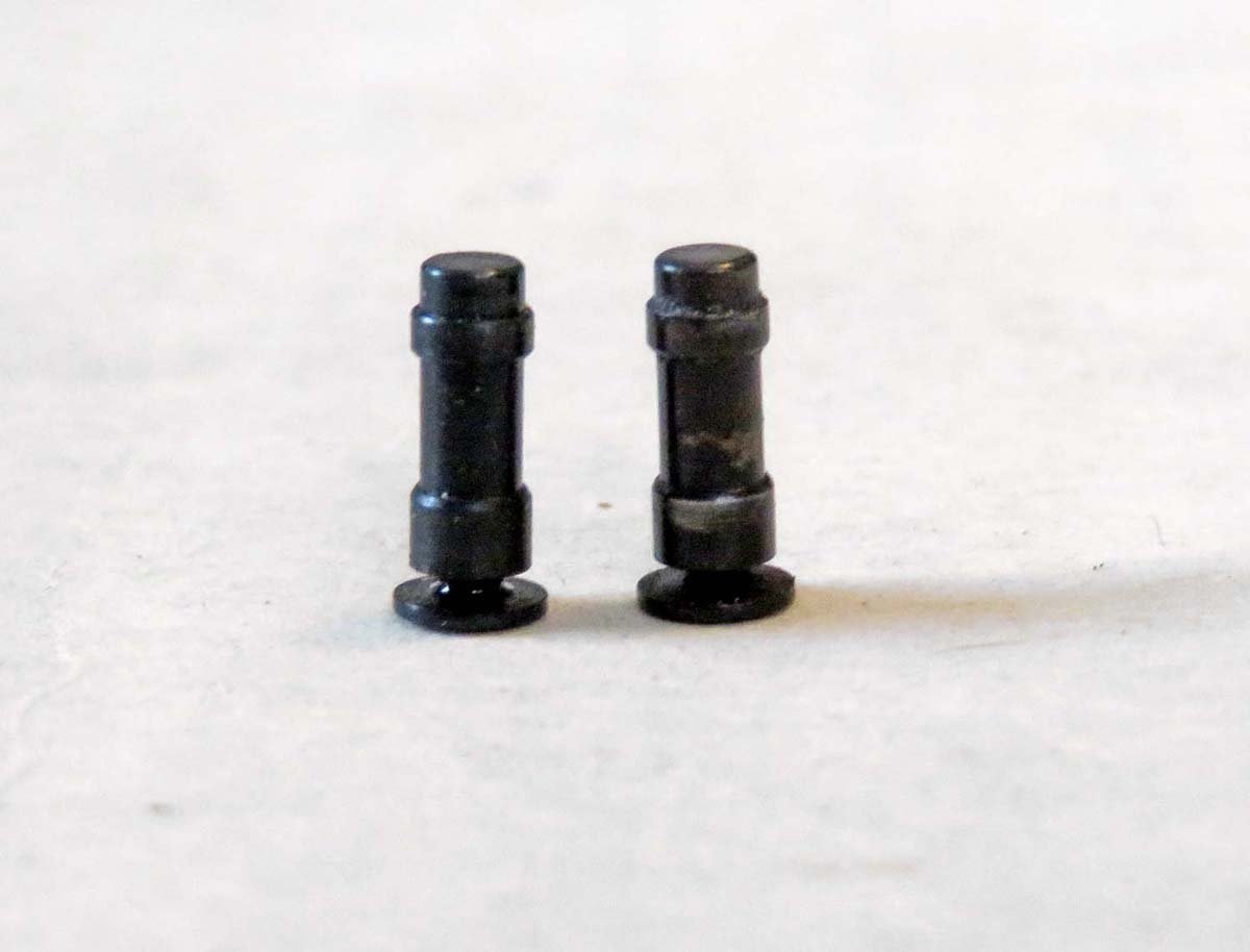

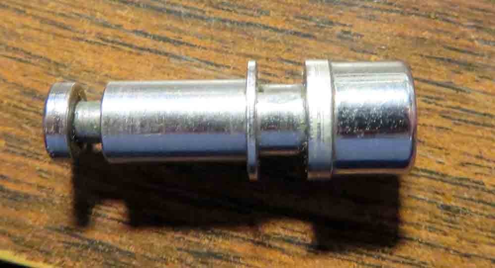

Matthew Hall Posted November 25, 2024 Author Posted November 25, 2024 (edited) So I did as you suggested and cleaned and rolled the release plunger. I detected no burrs or bumps but did as you suggested. Then after removing the inner mechanism I worked on the bore hole as well. Again, did not detect any burrs or rough spots. Put it all back together . . . no change. So, one of my cameras works and the other one does not, so there must be a difference between the two. Time to rule out which parts are not at fault and the one left over must be the guilty party. I switched turrets and placed the cast toothed one onto the camera with the trigger problem (the cast one is 100% functional on the other camera, release plunger and all). After swapping turrets I tested again. Even with the turret that works on the other camera, the release plunger is still not working. So the turret is NOT the problem. I then decide to swap out the leaf spring/plunger assembly to rule that out. Viola . . . , the release plunger now pops out in the LOCK mode and will not release as it should. SO, this part is the problem. I have included a few photos to illustrate what I found. The first image shows both cameras and their front plate. The one on top works 100% good, the one on the bottom is the problem. Note that the bottom one has no filter slot -- does that mean it is also not original to the body and may have been sapped out with the turret? The next several images show the two spring/plunger mechanisms. When laid side by side the mechanisms appear identical, But if you remove the plunger and stack them next to each other you can see a subtle difference. The plunger that works in BOTH cameras (the one on the right) is slightly longer than the other one. It is minimal but I can visually see a difference when held side by side. Short of obtaining a new part I don't know how to fix this. Edited November 25, 2024 by Matthew Hall
Premium Member Simon Wyss Posted November 25, 2024 Premium Member Posted November 25, 2024 Really good work. I think you nailed it entirely. It’s now about either finding a replacement plunger or making a new one/have one made that is long enough. MTE may have spare parts.

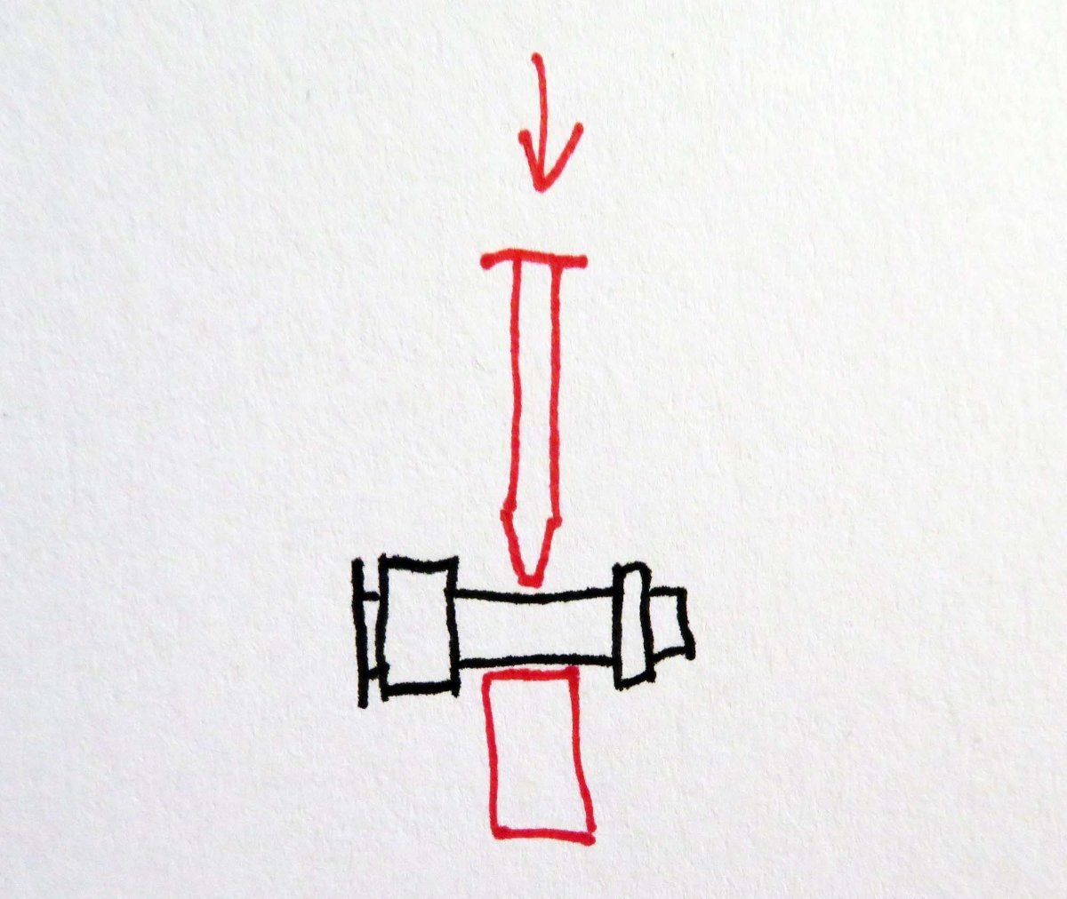

Matthew Hall Posted November 25, 2024 Author Posted November 25, 2024 Well, you will all probably laugh at this but I have solved the problem, using brute force. The plunger in the mechanism not working was just slightly too short. Turns out it is from a camera with serial #K17498, an older camera which might account for the wear. I was able to lengthen it just enough so it would function using the following method. You can see what I am talking about in the photo included below (please excuse the crude drawing). I supported the center of the plunger on a piece of steel while positioning a screwdriver directly above this on the opposite side. A couple of strong impacts on the screwdriver put a mild "dent" in the center of the shaft without bending it (hence the support from below). By creating this dent it lengthened the shaft slightly. Turns out it was just enough to get the assembly back to functional order. I double checked that the plunger rode smoothly in the bore hole before final assembly. The release plunger now pops out just like it should in the LOCK mode and cannot be depressed until the turret is turned to the RUN position. I know the repair it is a bit clumsy but it worked! Both cameras are now working as they should. I don't think the dent I put in the plunger shaft is enough to weaken it so it should last for awhile longer. I guess time will tell.
Premium Member Simon Wyss Posted November 26, 2024 Premium Member Posted November 26, 2024 Method Califorcia?
