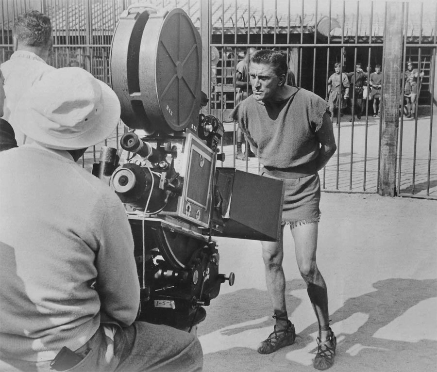

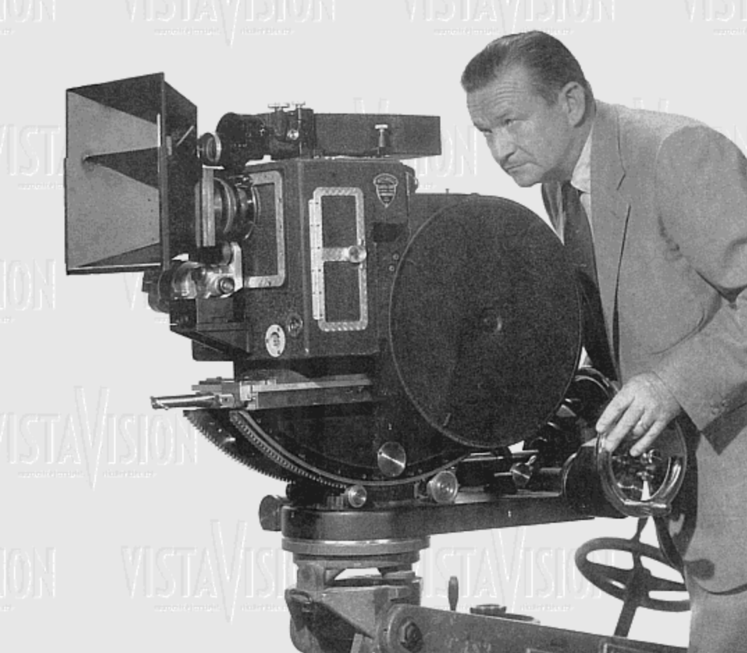

Steve Switaj Posted March 8 Posted March 8 (edited) 22 hours ago, Jon O'Brien said: I wonder how they got around what must have been a pretty noisy camera. Think about it: all that 35mm whizzing through horizontally with those wide frames. And not a physically huge camera apart from the slightly awkward sideways configuration of the mags. I think almost all of the Vista productions were shot with the Mitchell 'elephant ear' cameras. There were earlier proof of concept cameras built by converting old technicolor bodies, but these were unwieldy even by the standards of the 50's. I shot a lot of Vista in my VFX days, but never got to actually use one of the old elephant ears. Every one I ever handled already had it's movement removed for use in a 'new' spinning mirror body. There were at least a few blimps made for tight sound work, but the blimps were _huge_ . I know this because I have a friend who has one in his shop. It came in on a pallet with some other gear and he initially though it was an underwater housing until he examined it closely. It's clearly a production unit though, with a body and hardware similar to the blimps for the normal rackovers. Lot's of access doors because the camera opened up on all sides for loading. It did not have the feel of a one-off, so I suspect there were probably a handful built by whatever company was making the rest of them. But I suspect the cameras were not all that loud to begin with. Even though the movements looked like an overgrown Standard, I think they might have sounded more like an NC, more muted, you might just throw a couple of blankets over the thing an live with it. I base this on fact that when I see a BTS photos of, say, a Hitchcock production, as often as not the camera is unblimped on the dolly, even though it's clearly a dialog scene. (I'm a VFX geek, I always look for the camera). Also, from my personal experience with the format, the sound of film going through a VV camera is different. It's more of a flup, flup thing and less the sewing machine of a Standard or GC. Maybe the bigger loops pitch it down a little bit? dunno, but it's different, and I could see where it wouldn't carry as far. The sheer _mass_ of the elephant ear cameras probably didn't hurt when it came to damping out the sound. You really have to see one in person to appreciate it, but here's some links... http://www.mitchellcamera.com/forum/viewtopic.php?t=25 http://www.widescreenmuseum.com/widescreen/wingvv2.htm Also, if you absolutely must have one for your very own, you're in luck right now because The Prop Store has one up for auction. Sadly, it's missing it's movement, but it would look great on a set of sticks in the corner of your office anyway https://propstoreauction.com/lot-details/index/catalog/449/lot/157100 It's serial # 21, which is the highest I've ever seen, so by VistaVision standards, it's brand new. Gotta hurry though, the auction ends March 26th. Also, if you want the matching blimp to complete your set, contact Joe Lewis at General Lift. I'm pretty sure he would entertain offers. Or maybe tours, if you want to check it out in person. Actually though, if people here are really interested in seeing the blimp, I'll ask him to post a few photos. Edited March 8 by Steve Switaj
Premium Member David Mullen ASC Posted March 8 Premium Member Posted March 8 The Technicolor camera bodies were converted to 8-perf 35mm for the Technirama process with the magazines usually on top -- though the Mitchell elephant ear VistaVision cameras look very similar I don't think they were made from a 3-strip Technicolor body. Though I acknowledge that Mitchell built both types of camera bodies.
