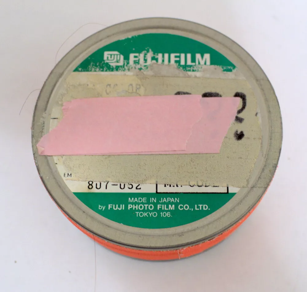

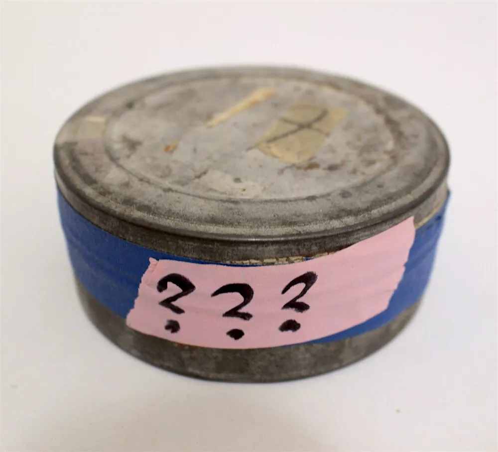

Jeremy Koehr Posted December 31, 2024 Posted December 31, 2024 (edited) Hi everyone, I recently purchased two 100ft SE rolls of expired cinema film that was unlabeled and quite cheap. It was with a group of others that were labeled from 1994, so I'm assuming that's around the age of these as well (Some being Fuji F-400 8582). I plan on bulk loading these into my stills camera and doing tests with each roll, assuming they're different film stocks. My plan: Set up a controlled environment, light at various EI levels while logging the levels on each frame. I've also heard expired stock should be rated at 1 additional stop greater per decade. Assuming it's from 1994, theoretically this would be rating closer to EI50. My question: If you were going to test these what would your process look like? Thanks for your knowledge and input. Best, Jeremy Apologies for posting in the wrong section, I just noticed there is a film stock area. Edited December 31, 2024 by Jeremy Koehr

Mark Dunn Posted January 3, 2025 Posted January 3, 2025 I'm guessing OP doesn't have any of that equipment, and this is presumed to be colour film.
Jeremy Koehr Posted January 3, 2025 Author Posted January 3, 2025 9 hours ago, Mark Dunn said: I'm guessing OP doesn't have any of that equipment, and this is presumed to be colour film. Haha, that's correct. It's definitely color and ECN-2 based on the remjet/color of the stock.
