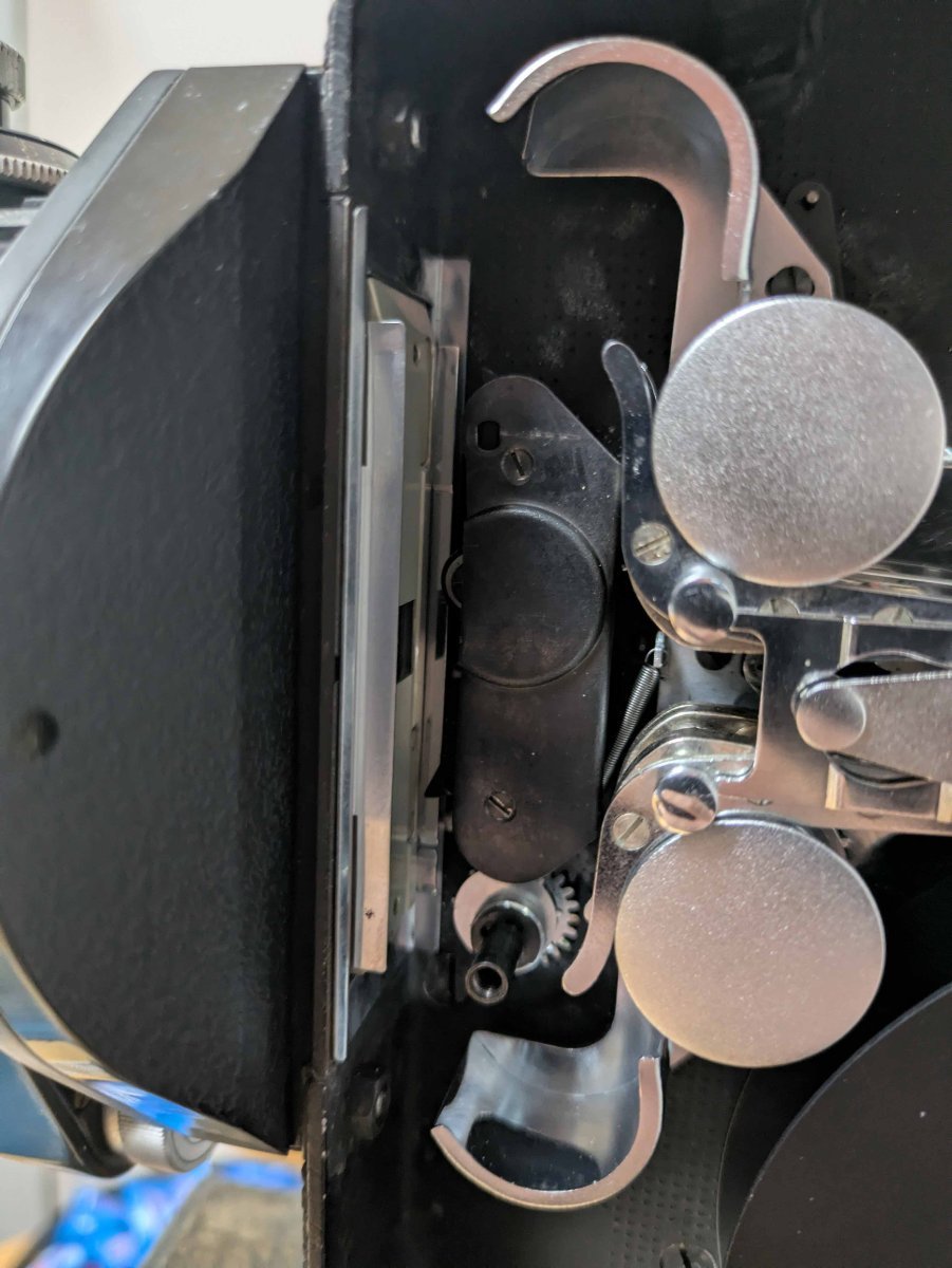

James Hoare Posted January 2, 2025 Posted January 2, 2025 Hi everyone! I recently shot on 16mm for the first time using a Bolex H16 SBM with a Vario Switar 16-100mm zoom lens. After getting the scans back I noticed that it was severely out of focus in a lot of the takes. It would often be sharp for the first couple of frames of the take and then shift focus considerably even though I was not shifting focus via the lens. I was wondering if this might be an issue with the pressure plate in the Bolex, where it might be slightly moving backwards as the film travels through it, affecting the focal plane. I’m certain I had the pressure plate locked into place correctly when shooting. I used a tape measure from the focal plane of the Bolex to measure the distance each time to the subject and then set the lens accordingly. Here are some examples of the film shifting in and out of focus. Footage Examples And here are some stills: Frame 1 of Clip 1 A few frames later from Clip 1 Frame 1 of Clip 2 A few frames later from Clip 2. I was wondering if anyone had any advice on what might cause this and if it is a pressure plate issue? I’ve also attached a videos showing the condition of the pressure plate and how the motor runs etc. Bolex Motor Running Here are is a photo of the pressure plate. I should also note that when the focal length of the zoom lens was set to 100mm it seemed as if the focus didn’t shift for whatever reason.

Don H Marks Posted January 2, 2025 Posted January 2, 2025 (edited) The film would indeed have to move behind the normal pressure plate location to shift the focus closer than intended. The pressure plate is spring loaded and it can move backwards. One way this can happen is if the upper loop is not formed or something happens to the upper loop. In that case the film can pull on the little extended upper lip of the pressure plate and can move the pressure plate backwards. The above happend to me once but the effect was more pronounced than you show. Stiff film stock, as Simon suggested might be more likely. Edited January 2, 2025 by Don H Marks
Premium Member Dom Jaeger Posted January 2, 2025 Premium Member Posted January 2, 2025 Hi James, Hmm, that’s an interesting fault. A loose pressure plate is hard to do on a Bolex because the lid doesn’t close properly if the pressure plate is open, but sometimes it can be not quite latched, or the plate with the hole that it latches into can be bent or damaged. A bad loop can sometimes cause focus issues, but it’s usually accompanied by jitter and instability. The condition and age of the stock is probably worth looking at. If you have a prime lens maybe shoot your next roll with that to rule out any issues with the zoom. I service and calibrate Bolex cameras and lenses in Australia if you ever need your kit looked down the track. Feel free to email me anytime via my cinetinker gmail.

Premium Member Dom Jaeger Posted January 3, 2025 Premium Member Posted January 3, 2025 The prism Simon is talking about is the piece of glass behind the lens port, the beamsplitter that sends some of the light to the viewfinder. Very, very occasionally the spring that holds it in place is misaligned (by bad servicing I always assume) and the prism can be loose. It is designed so you can flip it out and clean the back surface and field lens on top (in the case of an SBM), and then snap it back in place. If you haven’t already done so, you should get hold of a manual and read it through, knowing your camera is quite essential. Here’s a free copy of an SBM manual: http://www.vintagecameras.fr/images/MonSite/BOLEX/H16_Reflex/_Doc/H16_SBM_Manuel_en.pdf Your pressure plate and the plate beneath it seem ok. If the film stock was also ok and the loop seemed good then I’m perhaps beginning to suspect the zoom, though it’s an unusual fault if it always seems sharp at the opening frame. But maybe a loose optic is shifting around, or there is play in the zoom mechanics. It’s usually better to use the viewfinder for focussing, unless you know for sure that the distance marks on the zoom are correct. They should both agree at any rate. With cine zooms, you generally focus zoomed all the way in, and then zoom out to the view you want and the lens should stay in focus. If the focus drifts, then the back-focus is out and needs to be calibrated. Or the lens has a fault within. Honestly I think your kit needs to be examined in person to determine the issue, perhaps there’s something an experienced technician will pick up immediately that you can’t see, or will find with tools like a collimator. The cost of a quick professional check is less than the cost of one spool of film, processing and scanning, and can save you a lot of headaches. Ultimately anything bought off eBay or the like in unserviced condition should be at minimum checked if not serviced if you want to ensure a good experience shooting film.
