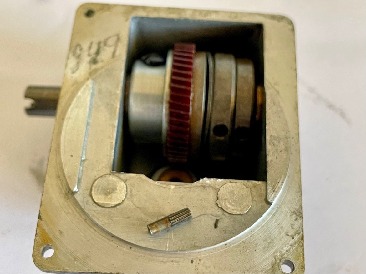

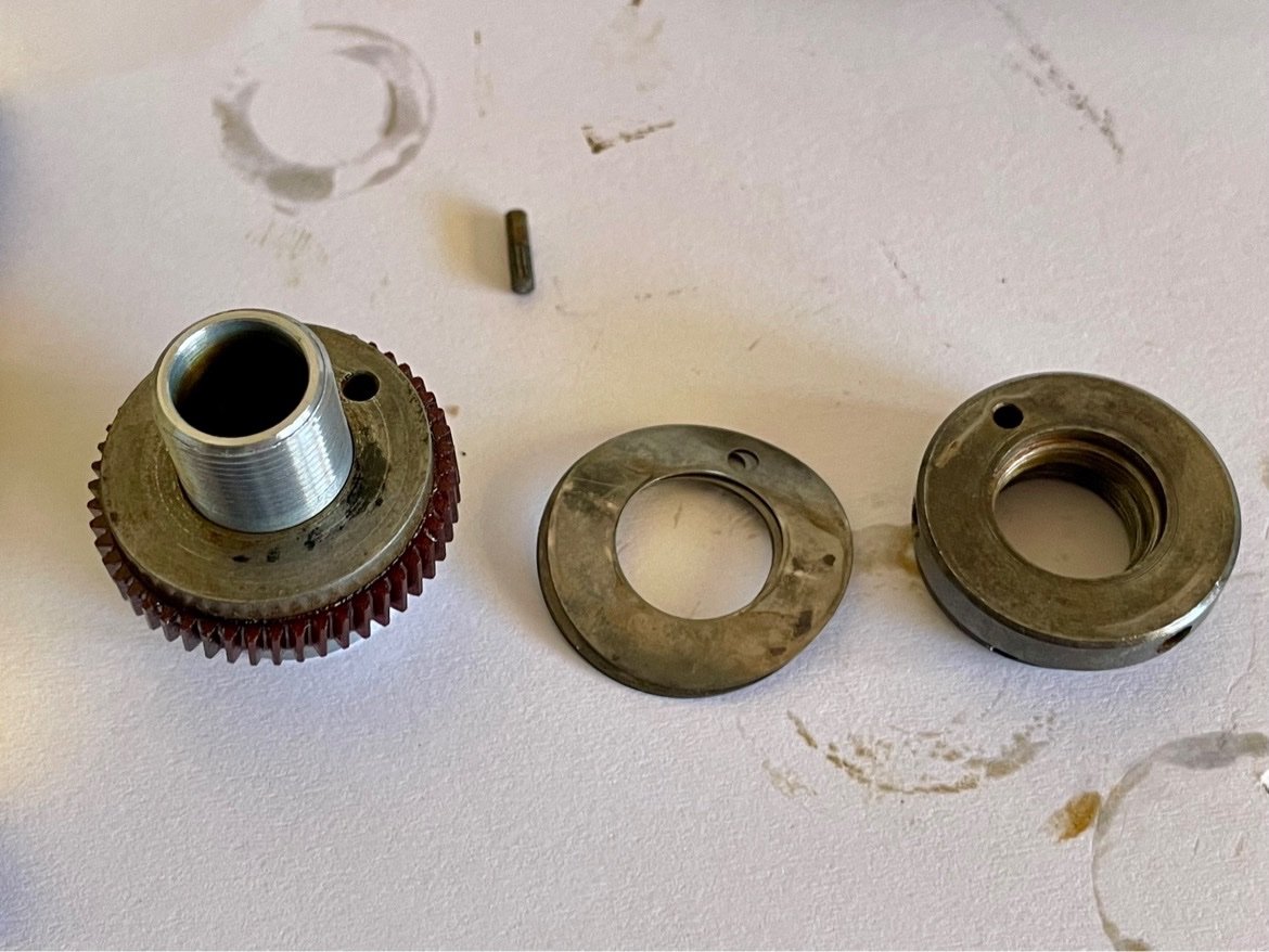

Bill Hunt Posted January 4 Posted January 4 I thought I’d better start a new thread with this, as it’s tangential to the thread it was originally added to: I believe this is an MC-17b motor. I bought it without cables or other accessories in as-is condition. Getting it to run was not difficult, but it was showing signs of corrosion on the fixing bolts so I thought I’d have a peek inside. After dismantling and cleaning I set out to discover how it was meant to work—particularly the “friction drive” mechanism I’d seen mentioned in several related online texts. What I’d originally thought was a clutch/friction mechanism (photo centre) turned out to be something more like a shock absorber made up of several wavy washers and tensioner rings, all pinned to the main gear—which was initially seized onto the outer shaft by corrosion. I’ve studied the manual (which by the way states the motor runs on ball bearings—there are none), and I’m still no closer to understanding what constitutes the friction drive, and how it’s supposed to work. The manual describes mechanical operation: Pressing the motor lever fully home when the motor is not connected to the camera results in the motor running continuously with the drive shaft engaged. When connected to the camera this would mean the camera drive shaft would also be rotating continuously. Is this what’s meant to happen? With the drive motor attached and running, and the camera lever at the “O” position (motor disengaged), is the camera in effect “idling” until the front or side shutter release is engaged? Is this also why the manual advises the motor should not be left on in this state for more than 15minutes (wear on the camera mechanism)? Thank you for reading this far, I’m aware that my assumptions may all be incorrect, in which case I’m happy to be corrected.
Don H Marks Posted January 5 Posted January 5 (edited) If yours is not free to spin with friction it is still seized. Edited January 5 by Don H Marks
Bill Hunt Posted January 5 Author Posted January 5 1 hour ago, Don H Marks said: If yours is not free to spin with friction it is still seized. Hi Don and thank you, I was just about to update… this is has become quite a puzzle. I can assure you the gear is free to spin (and this I think is the key to the puzzle), as long as I remove the pin that secured the tension ring, springs and gear together. What initially had me stumped was the pin looked like it was meant to be there—it may have been done at the factory by special order. Interestingly enough, when I removed the pin earlier today I noticed it looks very much like the pin that goes through the camera drive shaft, with one end cut off. With the pin removed, the clutch assembly is free to slip depending on the tension applied by the adjustment ring. Getting the tension set correctly will at this point be a case of trial and error—unless anyone has some tips. The main thing is (subject to the possibility of me being completely wrong in all my previous assumptions) the gearbox and friction clutch are able to do what they were designed to do.
Premium Member Simon Wyss Posted January 5 Premium Member Posted January 5 I think this is another testimony of the many changes that were made at Paillard. When you study the service manual you see that it’s full of little things differing here and there over time. Regarding these motors I’m under the impression that out of experience somebody said the clutch or shock absorber, which it isn’t because the motor doesn’t start up like a synchronous machine, is unnecessary. We’ll make the thing straight, give it a bore here, place in a grooved pin. The argument was perhaps that the camera mechanism starts up even quicker when driven by spring force. On the other hand, to keep the electric motor turning with the camera at halt is something that only puzzles me. Maybe to produce warmth in the cold? In cold conditions I rather rely on the mainspring than a battery. For a setting of the protective clutch you need to know the shear strength of the composite gear’s toothing. Then you give it a torque about a third lower. That’s how I’d do it.
Bill Hunt Posted January 5 Author Posted January 5 42 minutes ago, Simon Wyss said: I think this is another testimony of the many changes that were made at Paillard. When you study the service manual you see that it’s full of little things differing here and there over time. Regarding these motors I’m under the impression that out of experience somebody said the clutch or shock absorber, which it isn’t because the motor doesn’t start up like a synchronous machine, is unnecessary. We’ll make the thing straight, give it a bore here, place in a grooved pin. The argument was perhaps that the camera mechanism starts up even quicker when driven by spring force. On the other hand, to keep the electric motor turning with the camera at halt is something that only puzzles me. Maybe to produce warmth in the cold? In cold conditions I rather rely on the mainspring than a battery. For a setting of the protective clutch you need to know the shear strength of the composite gear’s toothing. Then you give it a torque about a third lower. That’s how I’d do it. Thank you Simon, Your knowledge is invaluable. From what I can understand from the manual, keeping the motor running and using either the front or side mechanical release is the only way of avoiding exposing frames when the camera stops: This is my preferred method of running the camera with the motor—with a cable on the side shutter release. Once I get a new pin in the camera’s drive shaft I’ll do a bit more testing, taking it slowly until I feel confident it’s reliable, and not going to damage the camera. I know it shouldn’t, but I’m being extra cautious.

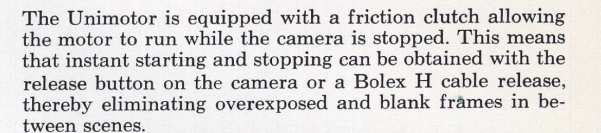

Premium Member Simon Wyss Posted January 5 Premium Member Posted January 5 You can’t damage the camera with the Unimotor, perhaps a roll pin in place of a solid dowel. When you let turn the motor on that one heats up. Sooner or later the motor or the clutch catches fire. 🔥 😜 It’s not professional to keep the electric motor running for the amateurish demand of not overexposed first frames. Again a clash caused by the coining Professional Amateur by Paillard, since 1936. But suum cuique, I can’t alter everybody’s expectations. What I can do is praise the Bell & Howell Filmo 70 models that afford a totally different technical approach. If we compare the H to the 70 we begin with the side finder. Bye-bye, Bolex!

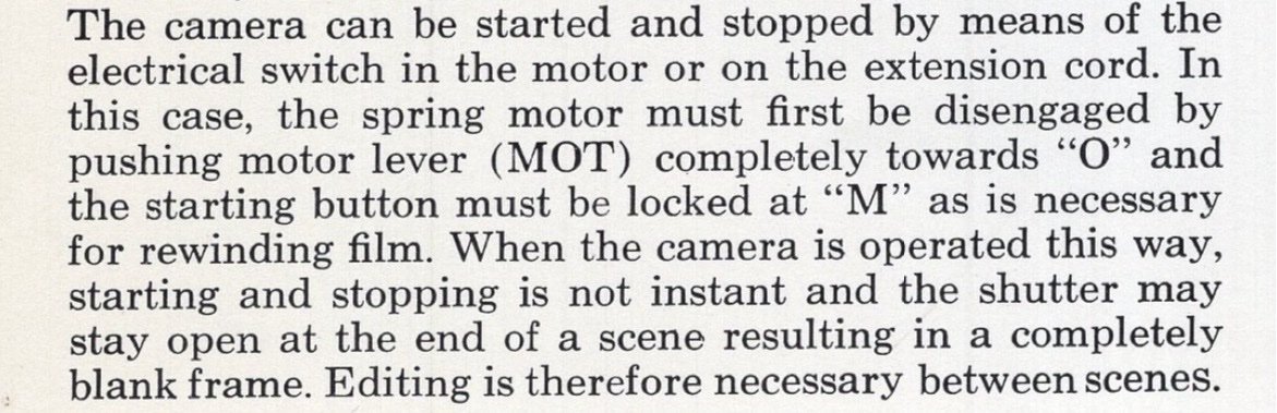

Bill Hunt Posted January 5 Author Posted January 5 44 minutes ago, Brian Drysdale said: I seem to recall starting the motor & camera with an external on/off switch. Yes, that’s the other way of starting/stopping, but according to this description… …the shutter may be left open after a take whereas with the manual release the shutter is always left closed. I’d be interested to hear your thoughts though Brian as you have the advantage of having used the motor. Did you find it reliable?
Bill Hunt Posted January 5 Author Posted January 5 3 minutes ago, Simon Wyss said: You can’t damage the camera with the Unimotor, perhaps a roll pin in place of a solid dowel. When you let turn the motor on that one heats up. Sooner or later the motor or the clutch catches fire. 🔥 😜 It’s not professional to keep the electric motor running for the amateurish demand of not overexposed first frames. Again a clash caused by the coining Professional Amateur by Paillard, since 1936. But suum cuique, I can’t alter everybody’s expectations. What I can do is praise the Bell & Howell Filmo 70 models that afford a totally different technical approach. If we compare the H to the 70 we begin with the side finder. Bye-bye, Bolex! I understand Simon, and I take you point about (my) expectations. This is part of the process of my education which, at this point, is very much lacking in experience in terms of this camera.

Bill Hunt Posted January 14 Author Posted January 14 On 1/5/2025 at 6:07 PM, Simon Wyss said: I think this is another testimony of the many changes that were made at Paillard. When you study the service manual you see that it’s full of little things differing here and there over time. Regarding these motors I’m under the impression that out of experience somebody said the clutch or shock absorber, which it isn’t because the motor doesn’t start up like a synchronous machine, is unnecessary. We’ll make the thing straight, give it a bore here, place in a grooved pin. The argument was perhaps that the camera mechanism starts up even quicker when driven by spring force. On the other hand, to keep the electric motor turning with the camera at halt is something that only puzzles me. Maybe to produce warmth in the cold? In cold conditions I rather rely on the mainspring than a battery. For a setting of the protective clutch you need to know the shear strength of the composite gear’s toothing. Then you give it a torque about a third lower. That’s how I’d do it. Simon, I’ve managed to set the clutch so that it works as it should, however my feeling is that there’s a slight drag (only maybe a second) between when the shutter is released and when the drive is rotating at speed. The camera does start immediately, and anyone else would probably not even notice. Maybe it’s my imagination—or maybe I’m expecting too much. My question is: do you know where I could find the information you mentioned (composite gear shear strength) so I could do the maths and torque the drive correctly? Then at least I know it’s working as designed and if that means a little lag at shutter release I can manage it accordingly. Using guesswork with these things makes me nervous.
Premium Member Simon Wyss Posted January 14 Premium Member Posted January 14 47 minutes ago, Bill Hunt said: Maybe it’s my imagination—or maybe I’m expecting too much. Yes. Only synchronous electric machines do jump-start. 47 minutes ago, Bill Hunt said: My question is: do you know where I could find the information you mentioned (composite gear shear strength) so I could do the maths and torque the drive correctly? The strength of such a material depends strongly on its state, I mean whether it’s dry or greasy or oily, and wear. From what I’ve found after a quick research I’d say 2900 psi. 1 megapascal equals 145 pounds per square inch. https://aseckunststoffen.nl/wp-content/uploads/2016/05/Datasheet-AS-PF-CP-206.pdf
