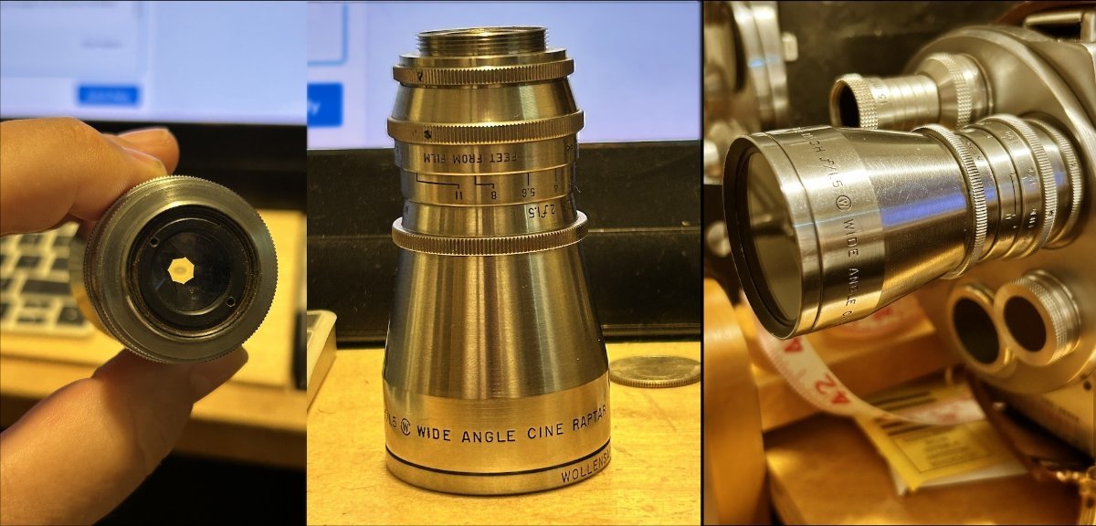

David T. Nethery Posted August 17 Posted August 17 (edited) On 3/29/2025 at 6:53 AM, Dom Jaeger said: "A lot of older lenses tend to be lower in contrast, which gives the appearance of being softer, but Switars were renowned for their high contrast. You can use non-RX lenses that are 50mm and below, but at fast apertures you will likely get some introduced aberrations. Generally around f/2.8 and below. Mainly spherical aberration and astigmatism, which cause soft focus and corner fall off." Always informative posts from Dom Jaeger and Simon Wyss. Thank you , gentlemen. Referring to the "older lenses that tend to be lower in contrast" I suppose those lenses include SOM Bethoit, Angenieux, Wollensak, Elgeet , Kodak Cine Ektar (although among older lenses I have found the Cine Ektar lenses can capture very crisp, rich images -- I have Cine Ektar lenses on my Cine Kodak K-100). I think nowadays with digital finishing the contrast can be boosted enough using filters in DaVinci Resolve or Adobe Premiere to mitigate the original lower contrast properties of some of these older lenses. I recently picked up a Wollensak Cine Raptar 12.7mm f/1.5 c-mount that appears to my eyes to have the desired "deep exit pupil", so I'm curious to try it out on my Bolex RX4 (ideally stopped down to f/4 or more , although I notice Dom Jaeger mentions "f/2.8 and below" is where the aberrations become a problem, so maybe it will be ok as long as it is set between f/2.8 to f/4 or more, with best sharpness in the f/5.6 - f/16 range). The Wollensak 12.7mm works fine on my non-reflex Cine Kodak K-100. On the K-100 the widest viewfinder available is 15mm , so using the Wollensak 12.7mm I have to compose shots allowing for the additional area that will be captured outside of the borders of the 15mm viewfinder (somewhat easy to do with the K-100 viewfinder system, which allows you to see some area that is outside of the camera framing.) Edited August 17 by David T. Nethery
Premium Member Simon Wyss Posted August 17 Premium Member Posted August 17 That won’t work on a RX-Bolex H due to the longer flange-focal distance of the camera. It’s 0.8175 in. or 20,7645 mm opposite the 0.69 in. or 17,526 mm of the A-, B-, and C-mounts.
Premium Member Dom Jaeger Posted August 18 Premium Member Posted August 18 5 hours ago, Simon Wyss said: That won’t work on a RX-Bolex H due to the longer flange-focal distance of the camera. It’s 0.8175 in. or 20,7645 mm opposite the 0.69 in. or 17,526 mm of the A-, B-, and C-mounts. Sure it will work. All C mount lenses , including RX ones, are collimated to form an image 17.52mm behind the mount flange when focussed at infinity. Reflex Bolexes still have an optical flange depth of 17.52mm, but the physical depth is extended by the glass prism because it refracts the rays coming from a lens and causes the image to be formed further back, but that happenes to any lens. RX lenses are simply computed to negate the aberrations that the prism induces at wider apertures, due to the shallower exit pupil and more angular ray cone that wider focal lengths often have. Lenses longer than 50mm are never RX, but clearly still work on a reflex Bolex. That wouldn't happen if the RX optical flange depth was actually over 3mm different. The same logic applies to non-RX lenses 50mm and below, it's just that they can be susceptible to aberrations depending on their exit pupil depth.
Premium Member Simon Wyss Posted August 18 Premium Member Posted August 18 Right you are, Dom, I had a mental slip yesterday. Stop down the Cine Raptar to f/4 and everything is fine. 1
