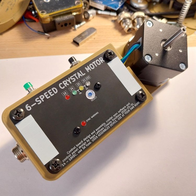

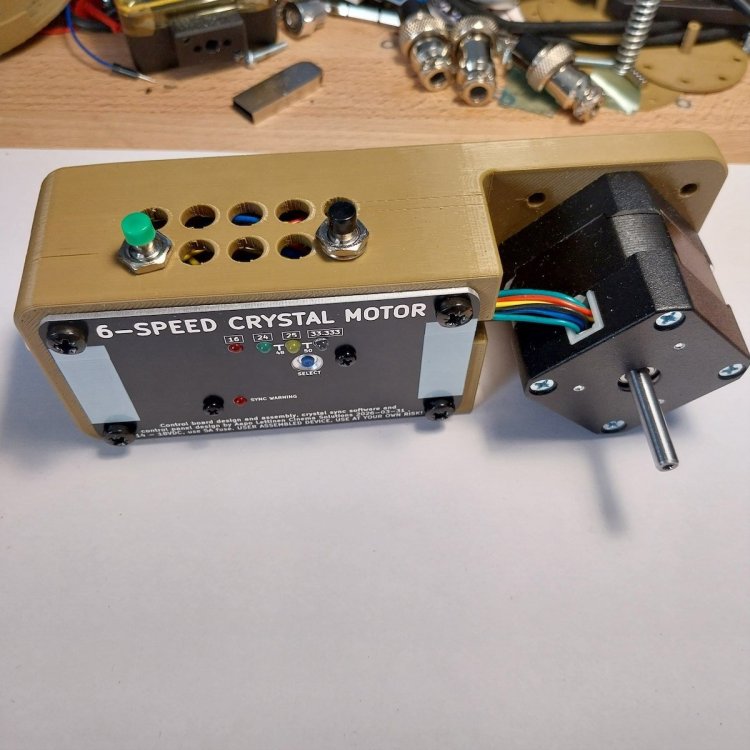

Premium Member Aapo Lettinen Posted March 29, 2025 Premium Member Posted March 29, 2025 (edited) I am working on a design which is compatible with ACL, Kinor and other cameras with 1:1 drive axle. Wanted to make it as compact as possible and relatively affordable. Just speeds of 16fps, 24fps, 25fps and 33.333fps and works at 14.8v so vlocks work fine for powering these. Other camera motors and items are for scale. 3d printed first draft, the final motor body will be cnc machined aluminium with aluminium control panel. Price 650usd without mounting parts (but cad files for Kinor and ACL mounting parts are included) or 850usd with one set of mounting parts for either Kinor or ACL camera. Let me know in April2025 if wanting to order these, I will make one batch in May2025 to use the rest of the parts I have in stock and likely these won't be available later. DM here on the forum or on Instagram (aaplet14). Edited March 29, 2025 by Aapo Lettinen

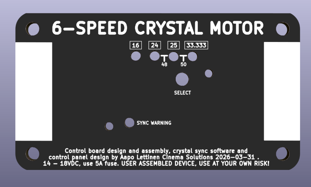

Premium Member Aapo Lettinen Posted March 29, 2025 Author Premium Member Posted March 29, 2025 Control panel design. Sent these to manufacturing yesterday. 1
Premium Member Aapo Lettinen Posted May 7, 2025 Author Premium Member Posted May 7, 2025 I will add 48fps and 50fps to the 4-speed Universal Motor! So it will have a total of 6 crystal speeds now: 16fps, 24fps, 25fps, 33.333fps, 48fps and 50fps. it will have the same user interface, I will just add the extra speeds in between leds so that they light up differently when 48fps or 50fps is selected. there is no room for extra lights which is why I originally made this 4-speed as there is only enough room for 4 leds, but I determined now that it is not too confusing to add the two extra speeds in between of the existing ones to have the requested 48fps included for the same price. Over 33.333 will need 18v battery, the other speeds work at 14.8v if needed. The price will be the same (650usd without camera specific axle and mounting parts, 850usd with the mounting parts and axle adapter included). I will send the motor body to cnc machining in late May, if wanting to order these let me know asap. Possible to pay in two parts if needed (50% when placing the order, the other 50% in mid June. The motors will ship in late June). dm here or on Instagram (aaplet14). Facebook messenger does not work.

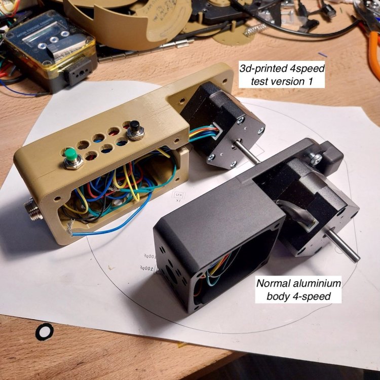

Premium Member Aapo Lettinen Posted June 17, 2025 Author Premium Member Posted June 17, 2025 cad designing the 4-speed motor's aluminium body. will 3d print a test piece of out plastic to ensure dimensions and motor drive fitting, possibly this version can be sent to cnc machining already but we'll see 🙂 (circuit board cad model intentionally altered to not show all the details. I already have the final circuit boards and working on the software at the moment)
Premium Member Aapo Lettinen Posted June 17, 2025 Author Premium Member Posted June 17, 2025 Final Kinor adapter to mount the 4-speed and 10-speed motors to the Kinor16 cameras! cnc machined aluminium. one can order the motor with this mounting adapter and axle adapter or get the bare motor and use the included cad files to make these adapters elsewhere. Or if you want to make some super special "add a huge cheeseplate to the adapter with v-lock mount and integrated light" then you can use the cad file and just add to it the stuff you need 🙂
Premium Member Aapo Lettinen Posted June 18, 2025 Author Premium Member Posted June 18, 2025 16 hours ago, Aapo Lettinen said: cad designing the 4-speed motor's aluminium body. will 3d print a test piece of out plastic to ensure dimensions and motor drive fitting, possibly this version can be sent to cnc machining already but we'll see 🙂 (circuit board cad model intentionally altered to not show all the details. I already have the final circuit boards and working on the software at the moment) the 3d printing test was ok and I ordered three of these motor bodies in aluminium now. Should receive them in the end of next week. Because I have tons of other projects at the same time, I need to make smaller batches of these than originally intended. The June2025 batch of three motors is already sold but if you want a motor from the Late July / Early August 2025 batch let me know asap and I will order another batch of parts in mid July. Will need to know how many motors needed, if you need mounting parts or not and which mounting parts for which camera. usually I only stock one or two kits of mounting parts so will need to know 3 weeks beforehand if more mounting parts needed. DM here or on Instagram (aaplet14)

Premium Member Aapo Lettinen Posted July 2, 2025 Author Premium Member Posted July 2, 2025 Final 4-speed motor aluminium bodies arrived today! Will assemble these first 3 next week. There is one test motor for me and the other two are already sold, but if needing a motor like this I will make more in August2025 and you can order from that batch 🙂

Premium Member Aapo Lettinen Posted July 8, 2025 Author Premium Member Posted July 8, 2025 Testing the prototype unit with Kinor and fine tuning the software for best stability and response. Assembling the final motors later this week but will need to test the software with ACL camera too before can lock the final version and fully assemble all the motors in the batch
Premium Member Aapo Lettinen Posted July 11, 2025 Author Premium Member Posted July 11, 2025 motor working with Kinor16, testing the crystal sync software version. this version was running about 0.015fps underspeed and corrected the difference in later versions. The final one is running very exact.
Premium Member Aapo Lettinen Posted July 11, 2025 Author Premium Member Posted July 11, 2025 2 hours ago, Aapo Lettinen said: motor working with Kinor16, testing the crystal sync software version. this version was running about 0.015fps underspeed and corrected the difference in later versions. The final one is running very exact. longer video with some talking about what I am doing
Premium Member Aapo Lettinen Posted July 11, 2025 Author Premium Member Posted July 11, 2025 (edited) final software version and how the speed presets are arranged etc. the front panel is not final on the prototype, the final panel has larger hole for the button so that one can use it with finger easily Edited July 11, 2025 by Aapo Lettinen
