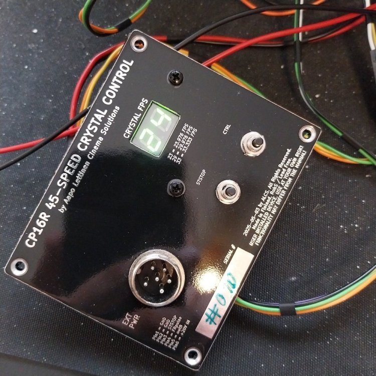

Premium Member Aapo Lettinen Posted April 8, 2025 Author Premium Member Posted April 8, 2025 New back panel will look approximately like this. It has one button to select speed and has a start-stop button. Typically the user would install a main start-stop button somewhere on the front of the camera like seen in the previous post where the start-stop and inching buttons are installed on the small detachable panel under the lens mount. The single 6-pin connector on the back panel is used for external power and accessories. The original onboard batteries are easy to route to the main circuit board so that the camera has dual power capability, it takes power from the highest voltage source and allows hot swapping battery etc.

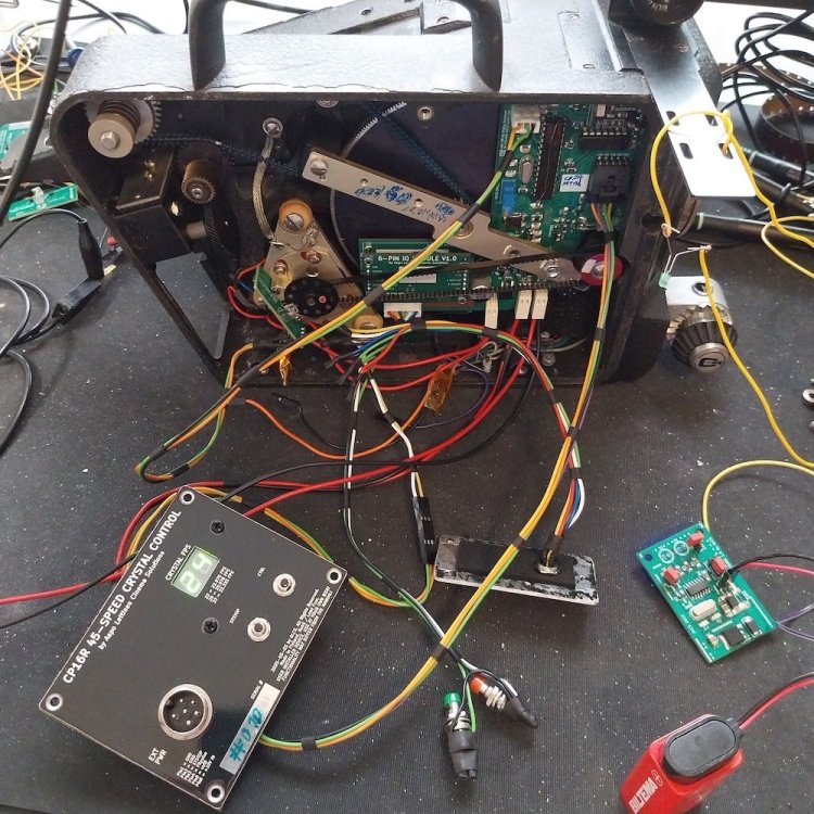

Premium Member Aapo Lettinen Posted April 12, 2025 Author Premium Member Posted April 12, 2025 Removed the old 1-speed crystal sync system from my own camera today and installed a cardboard print of the new 45-speed panel in place of it. The dimensions of the panel seem to be correct and will send them to manufacturing soon. The 45-speed back panels will be black with silver coloured markings like the 3d rendering in previous post.

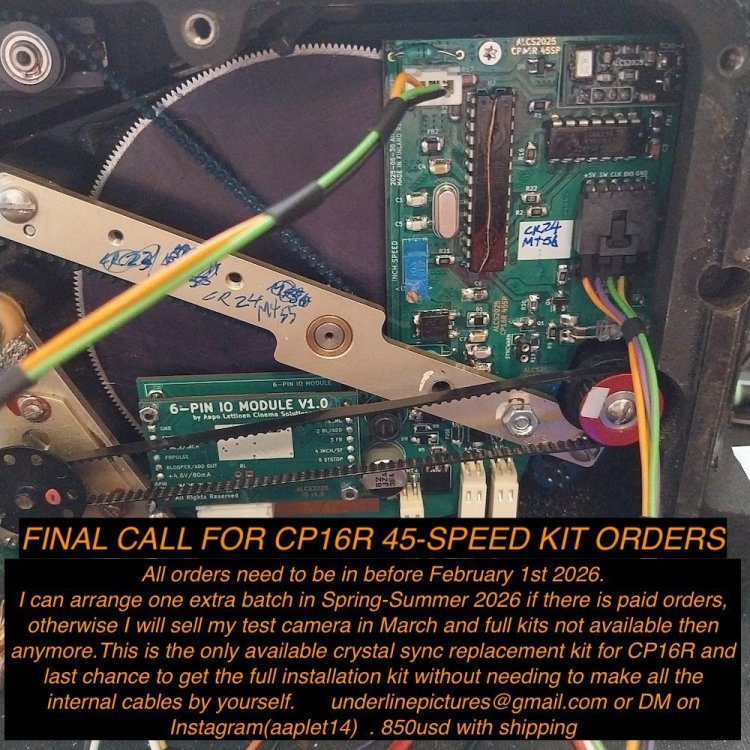

Premium Member Aapo Lettinen Posted May 20, 2025 Author Premium Member Posted May 20, 2025 Designing the IO-module for the 45-speed system. I was able to make this small enough that it can be shared with my NPR camera motors to make these in larger batches to reduce costs and improve quality. The CP16R main circuit board is relatively large and I am intentionally using larger sized components on the main board for mechanical strength. Using tiny parts is reliable if having them on separate circuit board like this, I am using from 3x to 4x smaller components on this module than on the main circuit board so that I can stack more features in the same board area. This IO module contains optocouplers and other parts isolating the 6-pin accessory connector from the sensitive microcontrollers on the main circuit board. If there is large electrostatic discarge, misconnection etc. on the 6-pin connector they will likely just destory components on this IO module and one can swap the module to new one instead of desoldering and swapping similar-functioning components on the main board. board dimensions about 48mm x 28mm and the smallest components are 1.6mm in length. I am assembling these by reflow soldering and only manually soldering the connectors in place.

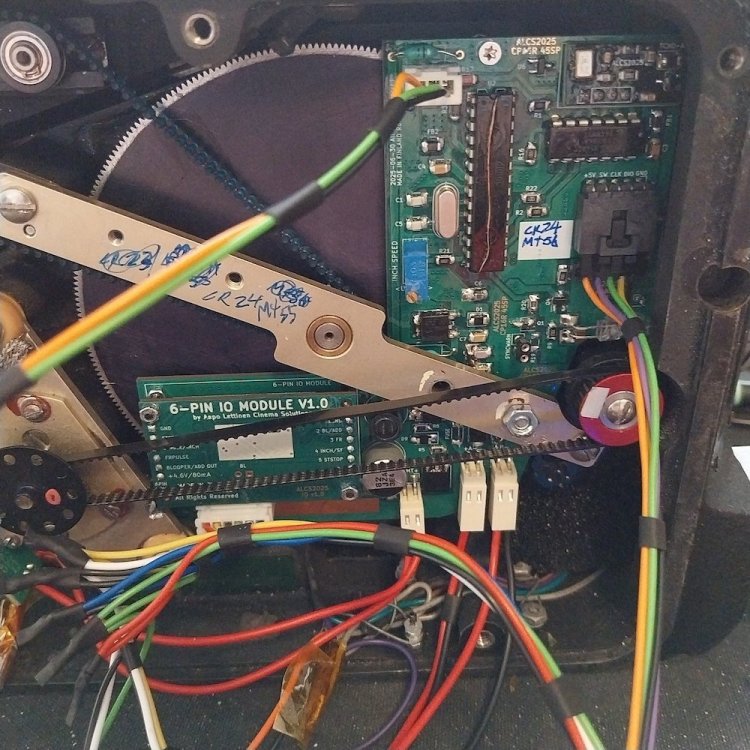

Premium Member Aapo Lettinen Posted May 28, 2025 Author Premium Member Posted May 28, 2025 Working on the main circuit board design for the 45-speed system. This is a draft which will change, I have not tested the exact component placement with the camera mechanics yet and need to make sure nothing is too close to the belts etc. (There is more components on the backside of the board and this is a 4-layer circuit board with quite a lot of connections on the internal layers so not possible to copy anything from the images, thus can post some work-in-progress screenshots 😄 ) Like mentioned before, the "normal" version of this control system will only be available as a preordered item. I will try to make couple of extra kits for later sale which are all with the tcxo module. Preorder prices: 750usd with shipping with normal crystal. 850usd with shipping with the tcxo module. Later sales: only tcxo module version available, price either 900 or 950usd with shipping depending on the world politics. Hopefully something like 5 kits will be available later and I may not make more of these after that so if anyone here needs the 45-speed update for cp16 camera, please preorder rather that waiting for too long.
Premium Member Aapo Lettinen Posted May 29, 2025 Author Premium Member Posted May 29, 2025 Got the circuit boards back for the first version of the IO board. this board protects the inputs/outputs of the 6-pin accessory connector from ESD and misconnections so that the main board electronics won't get damaged if there is static electricity etc on the external connector. the same board will be used on my NPR camera motors so that I have more resources to develop and test this module 🙂 will assemble a test board next week and then test with high voltage sources etc to see how well it works. 4-layer circuit board, will assemble a batch of 20 or 30 when having done all the tests and determined if this is the final version or if changes are needed.
Premium Member Aapo Lettinen Posted June 3, 2025 Author Premium Member Posted June 3, 2025 I sent the main circuit board to manufacturing now. When getting the board bases back will assemble the first prototype and start testing. This first board may not fully work with the camera yet as there is some board edge and component clearance stuff because of the belts etc. which I can only verify by testing with the actual circuit board. If it happens to work perfectly with this first board version I already ordered enough to make the sales boards quickly. If changes are needed, then will order another updated batch. Will see when getting the first boards back and have installed components on them and done some basic testing with the camera body.

Premium Member Aapo Lettinen Posted June 10, 2025 Author Premium Member Posted June 10, 2025 Testing circuit board fitting! seems to work fine, just making a very small cutout to the motor holder so that it surely clears the IO module. will assemble a prototype board next and start software testing

Premium Member Aapo Lettinen Posted June 21, 2025 Author Premium Member Posted June 21, 2025 Working on the CP16R software now. The 45-speed system will have PHASE CORRECTION function too, tested it today and works fine! so lots of value for the money I think Current feature list: 45 crystal speeds from 5fps to 50fps. will test if 3fps and 4fps work, if they do then they are included too very accurate tcxo crystal oscillator for extremely good sync accuracy even if shooting the full 400ft roll at once automatic shutter parking after shooting a take electronic inching with adjustable inching speed. makes it possible to check the gate by inching the mirror open after shutter parking possibility to feed external power to the camera and use the onboard battery at the same time (two power inputs on the circuit board only original electric motor drive needed, other stuff is replaced by newly made boards including the tachometer board, main circuit board, back panel and connectors as well as switches start-stop button and inching button when running, the inching button works as PHASE button bloop marker output to use with visual and audible bloop marker devices 1 pulse per frame output for external footage counters connector on the main board for sync warning led light back panel 6-pin connector (gx16 type) has start-stop, frame pulse out, bloop marker out and power in front panel 6-pin connector (hirose 10A type7 fm) has start-stop, inching, frame pulse out, blooper out and 4.6v 80mA power for external counters, switches etc. the 45-speed kit has the belt drive gear type (24fps black gear/25fps red gear) changeable from the display menu so it is compatible with both type of camera mechanics out of the box external footage counters available separately if needed, prices approx. 160usd to 350usd depending on features the 45-speed kit is user installable. Includes the circuit boards, new back panel and the small front panel with 6-pin Hirose, necessary switches, wire bundles and connectors. Possible to get without the wire bundles for cheaper (from 150usd to 200usd cheaper) . One gets good discount if purchasing more than one kit at once. the first batch of 6 is already sold out but one can order a installation kit from the next batch which will ship in August-September. If ordered before 1st July it is possible to get the kit from the second batch for 850usd including shipping. Later orders are 900usd including shipping. Only tcxo version available, there was no demand for the normal crystal version so will make all the circuit boards with tcxo dm on Instagram (aaplet14) or here . Facebook messages don't work
Premium Member Aapo Lettinen Posted June 22, 2025 Author Premium Member Posted June 22, 2025 Prototype board for CP16R has slightly different connectors than the final ones will have to ease testing and the ICs are socketed whereas on final boards the ICs are directly soldered in place to make the board more reliable. functionality is the same so will finish the software with this easier-to-test board and then assemble the final ones when the software is final.
Premium Member Aapo Lettinen Posted June 26, 2025 Author Premium Member Posted June 26, 2025 Had to make a small change to the main board to enhance shutter sensor mechanical fitting and move a mounting hole a tiny bit. Waiting for new boards to arrive and working on the software in the meantime. Estimated shipping date is between 12th and 15th July for the preordered kits. I will make couple of extra ones half assembled and can finish them in late August/early September. If wanting to order those next batch ones one can get them for 850usd a piece including shipping if ordered now. Later on they cost from 900 to 950 with shipping. Looks like availability will be limited all the time so necessary to preorder if wanting a installation kit from future batches
