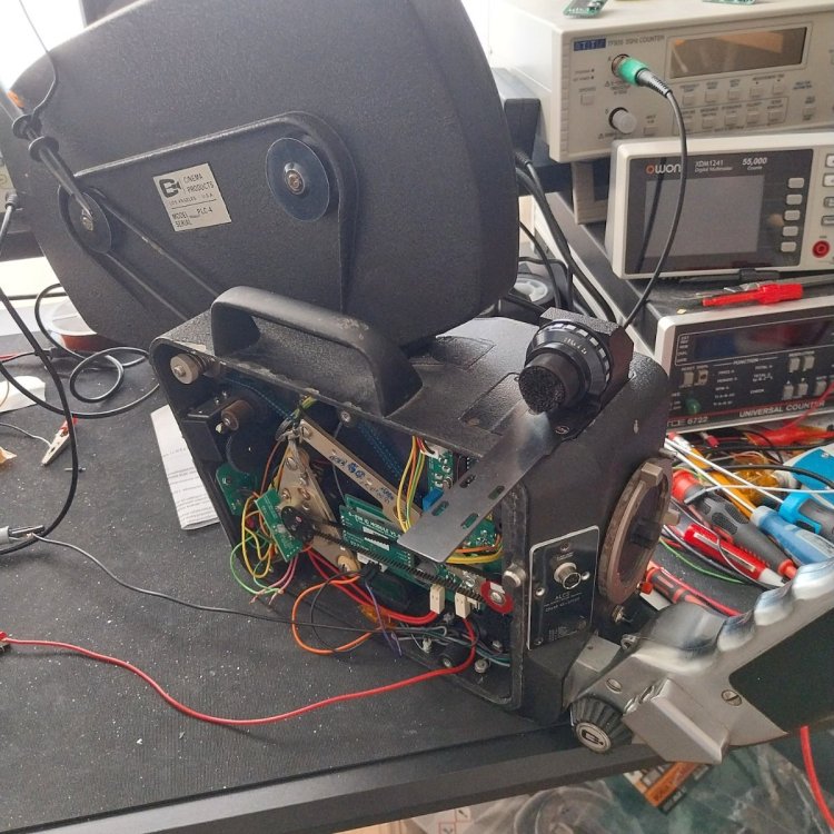

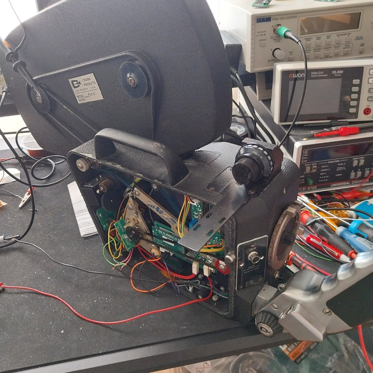

Premium Member Aapo Lettinen Posted July 1, 2025 Author Premium Member Posted July 1, 2025 Testing the frequency response of the 6-pin IO module which is shared with the NPR and CP16R projects. doing couple of more tests and then starting to assemble the IO-modules for the final motors https://www.youtube.com/shorts/MSnojN3ciAY
Premium Member Aapo Lettinen Posted July 2, 2025 Author Premium Member Posted July 2, 2025 longer video with explanation https://www.youtube.com/watch?v=awlTwf3nyZA
Premium Member Aapo Lettinen Posted July 3, 2025 Author Premium Member Posted July 3, 2025 short circuit testing the IO module! if you are interested about some more detailed explanations and thermal imaging stuff then would be worth to watch https://www.youtube.com/watch?v=h1HIezIFwLY&list=PLXvIUtmF3OxtXFJWzSw8QLiw7tE6wisO_&index=1

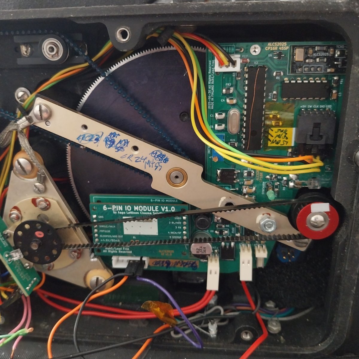

Premium Member Aapo Lettinen Posted August 9, 2025 Author Premium Member Posted August 9, 2025 Soldering the tricky shutter parking sensor assemblies to the main boards Â
Premium Member Aapo Lettinen Posted August 10, 2025 Author Premium Member Posted August 10, 2025 removing flux residues from the circuit boards  1

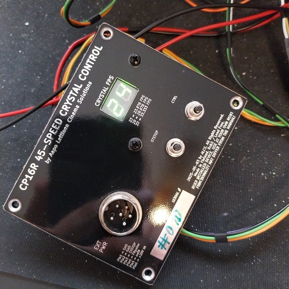

Premium Member Aapo Lettinen Posted August 16, 2025 Author Premium Member Posted August 16, 2025 testing the user interface and explaining what I do when tuning the crystal sync Â

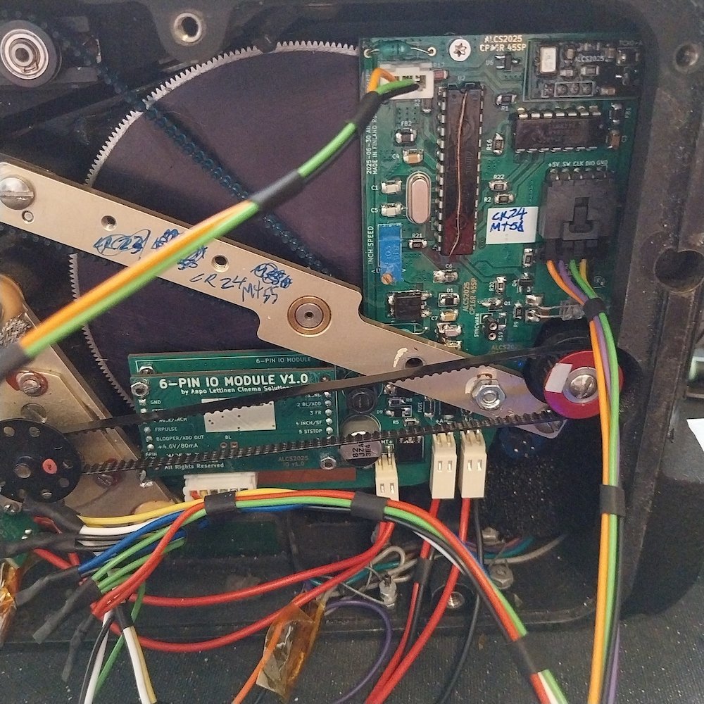

Premium Member Aapo Lettinen Posted September 6, 2025 Author Premium Member Posted September 6, 2025 (edited) Here is lots of testing, showing how to operate and explanation about the system installed to my own camera! really long video, did not have time to edit but can be watched at 1.5 speed 😄  Edited September 6, 2025 by Aapo Lettinen 3

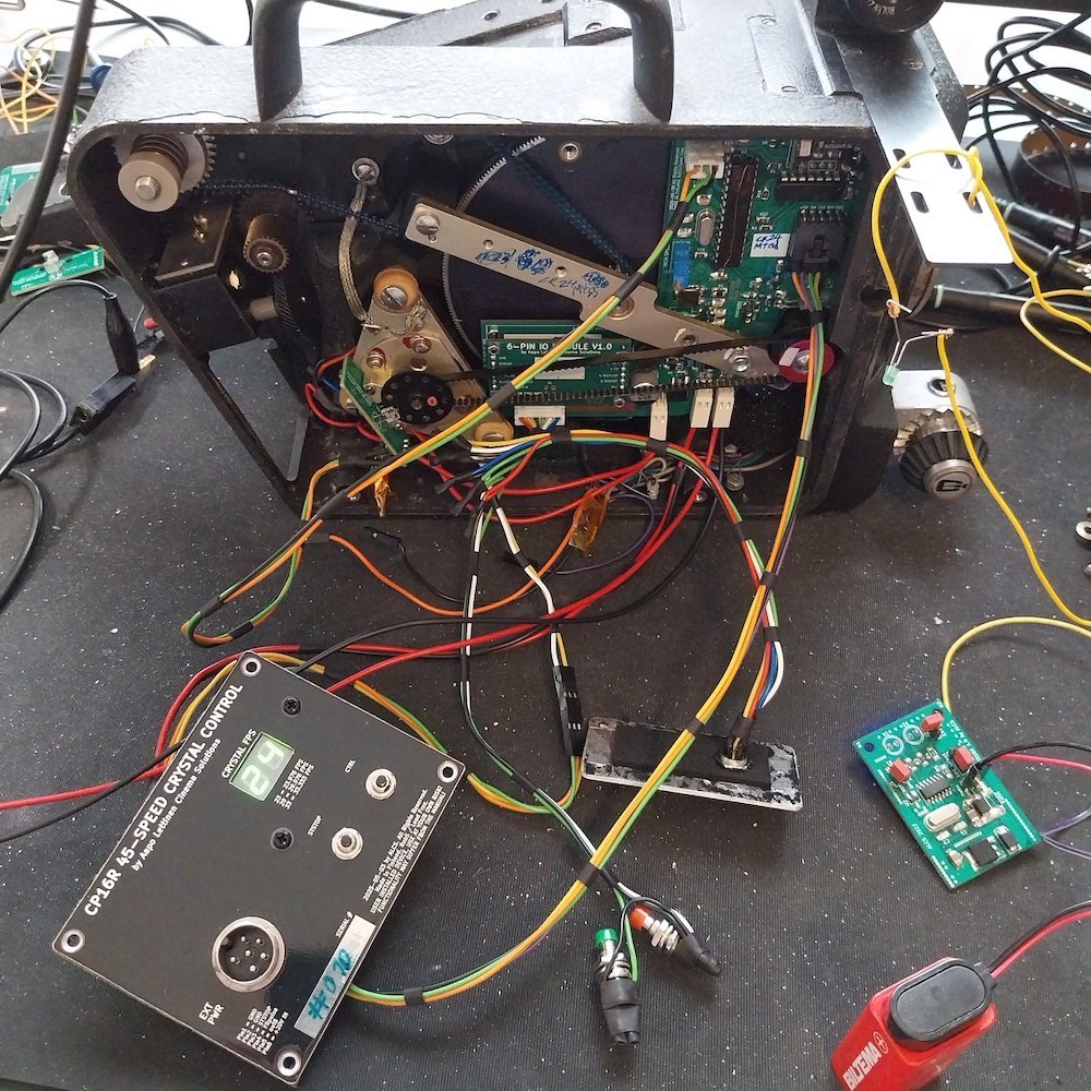

Premium Member Aapo Lettinen Posted September 23, 2025 Author Premium Member Posted September 23, 2025 testing the final kits with my own camera before sending them. It is easiest to test the main boards and encoder boards this way. the panels can stay on the side during testing. Two more to test, should have all kits shipped by Friday. Â
