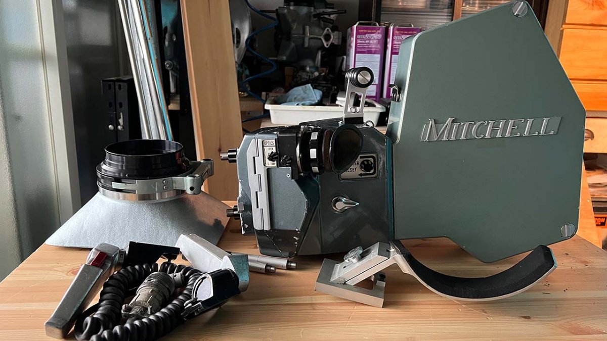

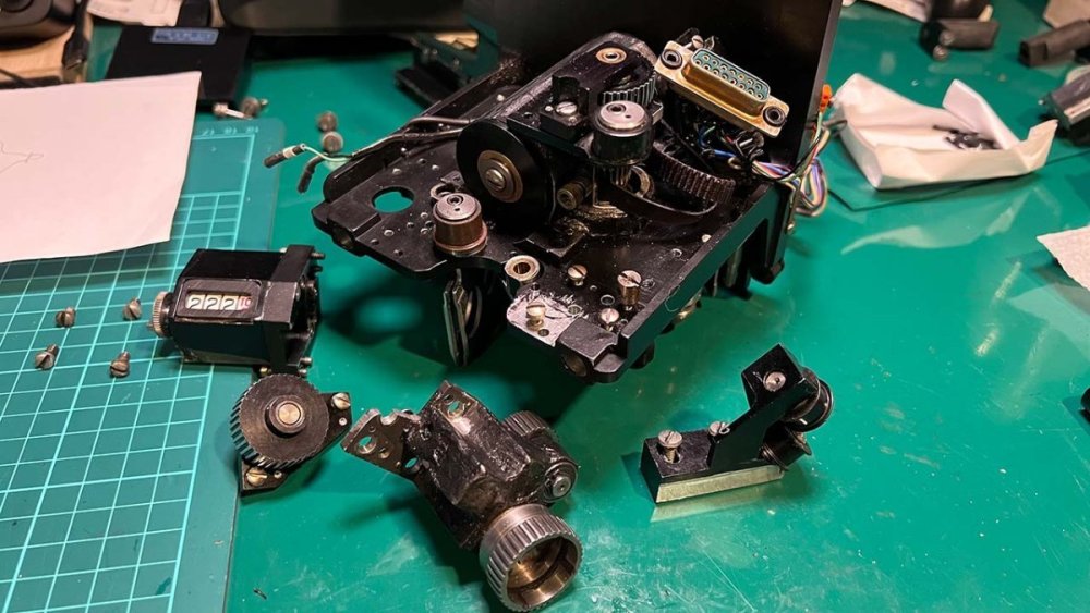

Takahiro Nakano Posted April 11, 2025 Posted April 11, 2025 I recently acquired a "Mitchell Mark III." There is very little information available about this camera. It is currently being restored. With the help of Mr. Bennett from cinemagear.com I was able to determine what type of belt was used. If anyone knows anything about this camera please let me know.

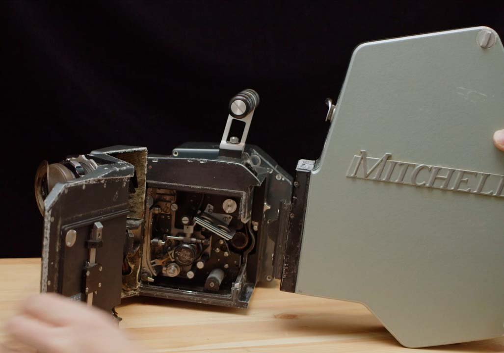

Steve Switaj Posted April 12, 2025 Posted April 12, 2025 This is why I love these forums. After 30 years in VFX I was pretty sure I had seen every single Mitchell product ever released, from the 16mm 'Monitor' instrumentation cameras up to the big 65's, with a couple of missile tracking cameras, aircraft nose cameras, and underwater rigs thrown in along the way. But I have never seen one of these before, and had no idea such a thing as a 'MK-III' even existed. Do you have any pictures of the movement?
Takahiro Nakano Posted April 13, 2025 Author Posted April 13, 2025 (edited) There really isn't much information on the web, just a few posts on the cinemagear.com blog. According to Richard Bennett, only three were made, one of which was purchased by DP John Hora. A book for Japanese engineers notes that several were introduced to Japan in 1975. It is unclear how many were actually produced, but they were very few. My camera's serial number is "1004". Edited April 13, 2025 by Takahiro Nakano

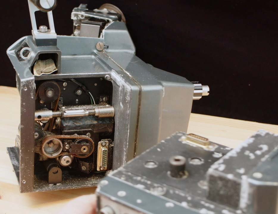

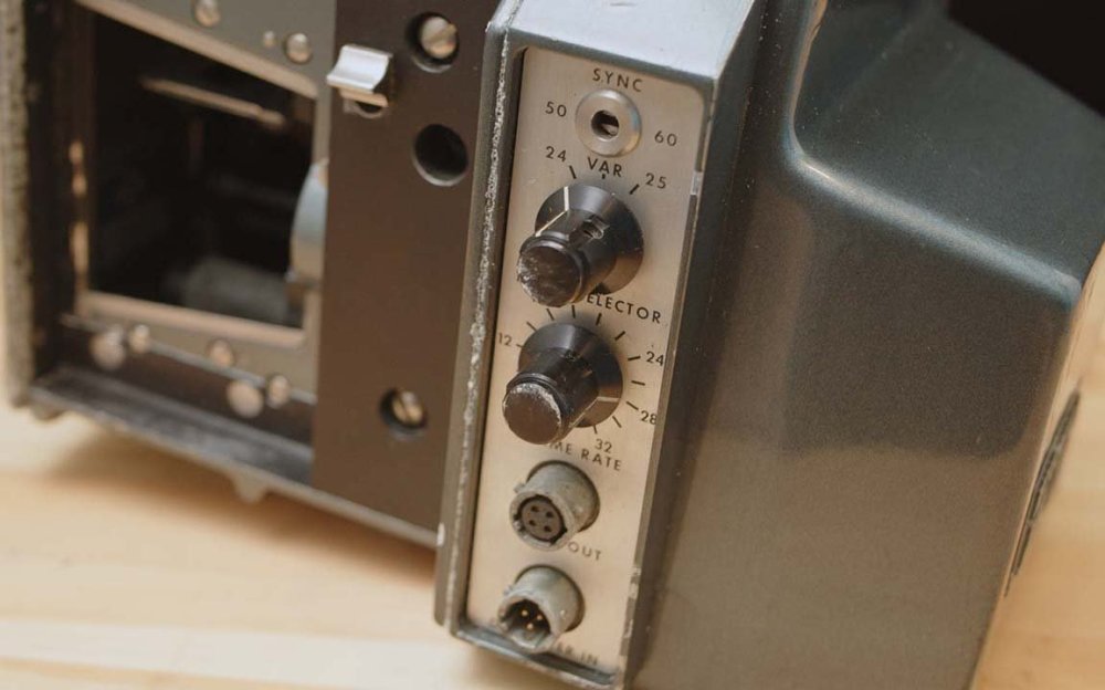

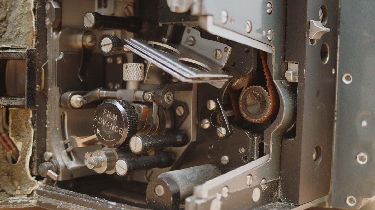

Takahiro Nakano Posted April 13, 2025 Author Posted April 13, 2025 The Mark III is a shoulder-style sound camera. The movement is very similar to the familiar S35R, but the sprocket is in the magazine. The magazine is inserted from the side like the 35BL. The ground glass is the same as the S35R. The film gate also appears to be the same, but there is a hole for the clapper LED. It states that the viewfinder is removable and a viewfinder extension is available. The viewfinder visibility is great! I think it has a higher magnification than the 35BL. It's very bright as there is no video assist splitter. The shutter is fixed at 170 degrees. The motor can be easily removed. I found out that the timing belt is "40DP" and "NO-SLIP POSITIVE DRIVE BELT", but these are not available in Japan so I am currently searching for them.

Mark Dunn Posted April 13, 2025 Posted April 13, 2025 40 minutes ago, Takahiro Nakano said: I found out that the timing belt is "40DP" and "NO-SLIP POSITIVE DRIVE BELT", but these are not available in Japan so I am currently searching for them. https://www.lpgear.com/category/MM.html ?
Takahiro Nakano Posted April 13, 2025 Author Posted April 13, 2025 3 hours ago, Brian Drysdale said: 古い価格表はこちらです: https://www.pacificrimcamera.com/rl/00991/00991.pdf Interestingly, the photo (illustration?) is of a coaxial magazine.
Takahiro Nakano Posted April 13, 2025 Author Posted April 13, 2025 3 hours ago, Mark Dunn said: https://www.lpgear.com/category/MM.html ? https://www.pic-design.com/ https://www.york-ind.com/ I've been inquiring about these companies but there's an issue with minimum orders. Glad to hear they're still available.

dan kessler Posted April 13, 2025 Posted April 13, 2025 40 DP belts also available from Stock Drive Products www.sdp-si.com Holding one in my hand as we speak

dan kessler Posted April 14, 2025 Posted April 14, 2025 (edited) That would be nice, but no, I just happen to have a 40 DP belt that I'm using for another project, which, coincidently, is another camera. 40 DP is one of several standard timing belt pitches that are readily available from suppliers. SDP has a huge selection, so you should have no problem getting what you need. You just need to specify the number of teeth and the width. Edited April 14, 2025 by dan kessler
Takahiro Nakano Posted April 14, 2025 Author Posted April 14, 2025 Thank you. The 40DP is not sold in Japan. (I accidentally bought too many MXL belts...) I think I'll put a new belt on my CP-16R as well.
