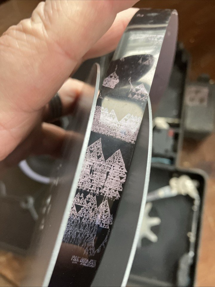

Brandon Paterno Posted May 5 Posted May 5 Another example of this in the wild/on a random eBay listing very beautiful!! would be fun as a traveling matte.
Pilvari Pirtola Posted May 5 Author Posted May 5 8 hours ago, Brandon Paterno said: Another example of this in the wild/on a random eBay listing very beautiful!! would be fun as a traveling matte. Whoa, thanks for this find! very interesting as this is a camera so the patterns would seem to be visible on an undeveloped film. And quite likely it is also some other stock than fujichrome.
Pilvari Pirtola Posted May 6 Author Posted May 6 managed to make a deal with the seller and bought that film roll, will be very interesting to inspect that.
Brandon Paterno Posted May 6 Posted May 6 8 minutes ago, Pilvari Pirtola said: managed to make a deal with the seller and bought that film roll, will be very interesting to inspect that. exciting!! glad it got into your hands. keep us updated! i have to wonder if this is an antihalation backing coming off in that pattern. regardless, cool stuff. occurrences like this support the credence of film material —beyond the screen + montage — as medium.
