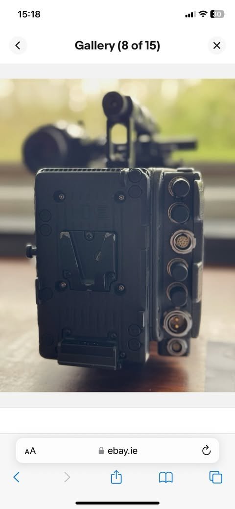

however, i cannot for the life of me find the correct idx or alternative battery plate that will work for the alexa classic with these batteries. I wish to be able to use any v mount battery on the back of it.
attached is the photo i am looking for. does anyone know if i can get a back that can fit directly through the gold connector pins

well the official solution would be to purchase the ARRI K2.72010.0 Battery Plate as mentioned in this document and mount it to the back, however it might be difficult to find nowadays.
Another way could be to use something like the bebop V2AB to adapt the gold mount battery plate to V-Mount: https://bebob.de/v2ab.html
Hope that helps!
