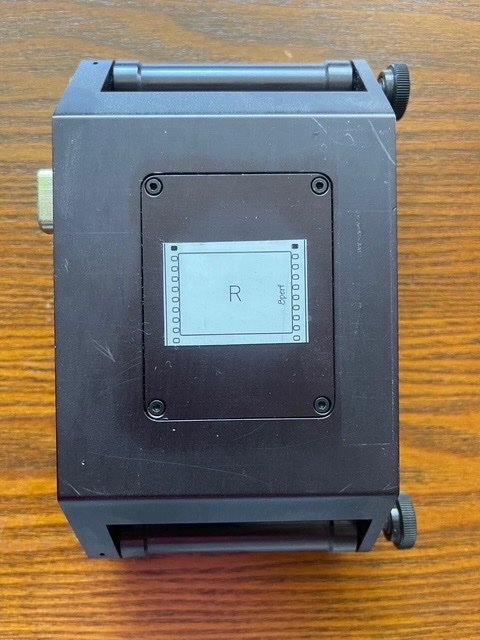

Geffen Avraham Posted May 13, 2025 Posted May 13, 2025 The February 1993 edition of the ASC magazine mentions a series of cameras offered by MSM Design, the company of Martin S Mueller. It mentions the 8812 VistaVision camera, the 8870 8-perf 65mm Iwerks camera, and the 9801 IMAX camera. There is, however, a fourth camera mentioned as well: the 5815, which is described as "65mm, 5, 8, and 15 per 1 fps". This confuses me a bit. Is this truly a 65mm camera with variable pulldown between 5, 8, and 15 perf formats - that can only shoot 1 frame per second? What could possibly be the purpose of this camera? The only application I can guess is Ron Fricke, who used custom 65mm time-lapse cameras for Baraka. Then why the variable format? I was under the impression that Baraka was all 5-perf.
Geffen Avraham Posted May 13, 2025 Author Posted May 13, 2025 I have found no pictures from this camera, but a magazine from it is currently found on eBay: https://www.ebay.com/itm/256389495557 1
Rosc Oshe Posted May 14, 2025 Posted May 14, 2025 MSM built single frame film recorder multi format cameras with interchangeable movements. The photo above is the 65mm magazine from his recorder. I believe Marty built 5, 8 and 15 perf movements for the recorders. 2
Rosc Oshe Posted May 15, 2025 Posted May 15, 2025 MSM built single frame film recorder multi format cameras with exchangeable movements. The photo above is the 65mm magazine. I believe Marty built 5, 8 and 15 perf movements. Here is the 8/65 movement 1
