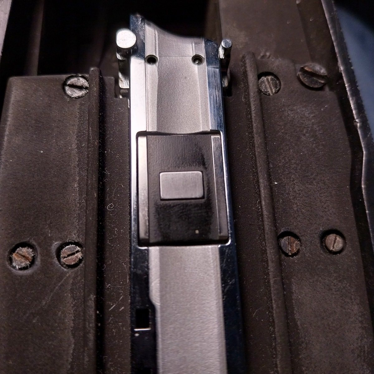

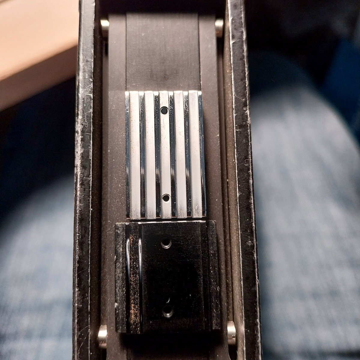

Premium Member Aapo Lettinen Posted June 4, 2025 Premium Member Posted June 4, 2025 (edited) Just took photos of what exactly is the issue with the chrome plating and what would need to be changed. Arri SR2 and Aaton LTR pressure plates. The Aaton stripes are rounded on both ends so it is not perfectly flat all the way. replicating would require replicating that special shape too. probably could be remade black colored if using enough money on it. The Arri has the center rectangle chrome part being the issue, otherwise should be fine as other film frame area is already painted black. the height of the rectangle compared to the side support bars is critical as Tyler noted earlier. if getting that rectangle black somehow without affecting its height compared to the rails it would be solved completely. I would probably try to just find out the exact thickness of the chrome plating if has originally, then stripping that away and applying the same thickness of some other dark grey or black stuff, would be the easiest way to maintain the tolerances. I am not enough expert on metallurgy and coatings to say what kind of coating would work the best on these but they are metal and replicable after all, it just costs if needs to be good. Â Edited June 4, 2025 by Aapo Lettinen
Gautam Valluri Posted June 4, 2025 Posted June 4, 2025 @Aapo Lettinen do you happen to have any example stills of what the "ghost reflections" look like on these chrome pressure-plates when shot without the remjet layer?
