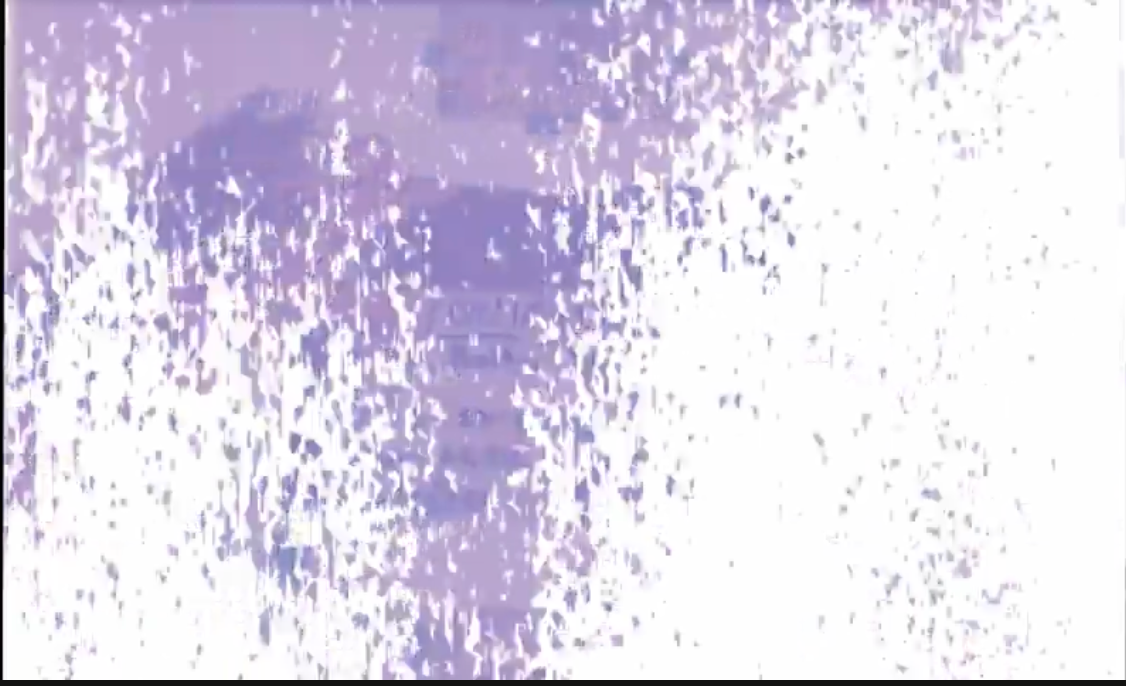

Premium Member Tyler Purcell Posted June 6, 2025 Premium Member Posted June 6, 2025 1 hour ago, Uli Meyer said: Interesting, thank you for sharing the photo! I'll be shooting a short film in a couple of weeks and was told that the material I will receive is still with the remjet layer. I think it might be a little while before the remjet stock gets phased out. While that happens, they'll probably be running a machine that can process it. Yea, they aren't releasing the new stock to the public yet, it'll be a while. They won't be phasing out the older stock anytime soon. The main reason they're phasing out remjet has to do with inconsistencies with the coating and removal, which has plagued many films. They wanted to offer an alternative process to deal with it and now they do have one. Kodak is blaming the labs for the remjet removal issues. The labs are blaming Kodak, so it's all a big cluster.
