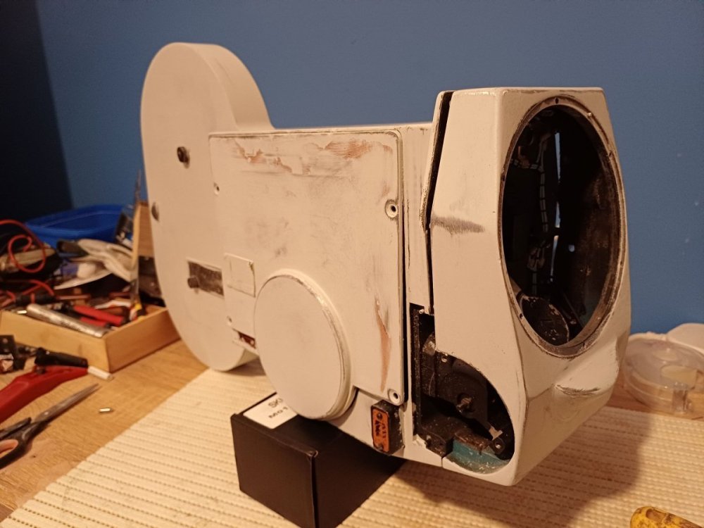

Gareth Blackstock Posted August 19, 2025 Author Posted August 19, 2025 Working on the camera I have been focused on repainting the heavily oxidised parts. I figure I need to coat the magnesium before I start using lubricants on the internals, that way I do not risk staining the metal with oil that will prevent later paint adhesion. The attached picture is a quick mock up, the body, 400ft mag, and turret housing are being repainted. 1

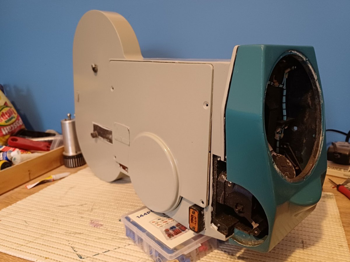

Gareth Blackstock Posted October 1, 2025 Author Posted October 1, 2025 So I have finished painting the camera body, turret, and magazine. Now that the metal is protected I can apply a seal to the rest of the magnesium parts without spoiling the chance of new paint adhering. Then I get to embark on cleaning and lubricating the internals and running the camera. As the camera was designed for sound on film recording I am curious to see how quiet I can get it. G 1

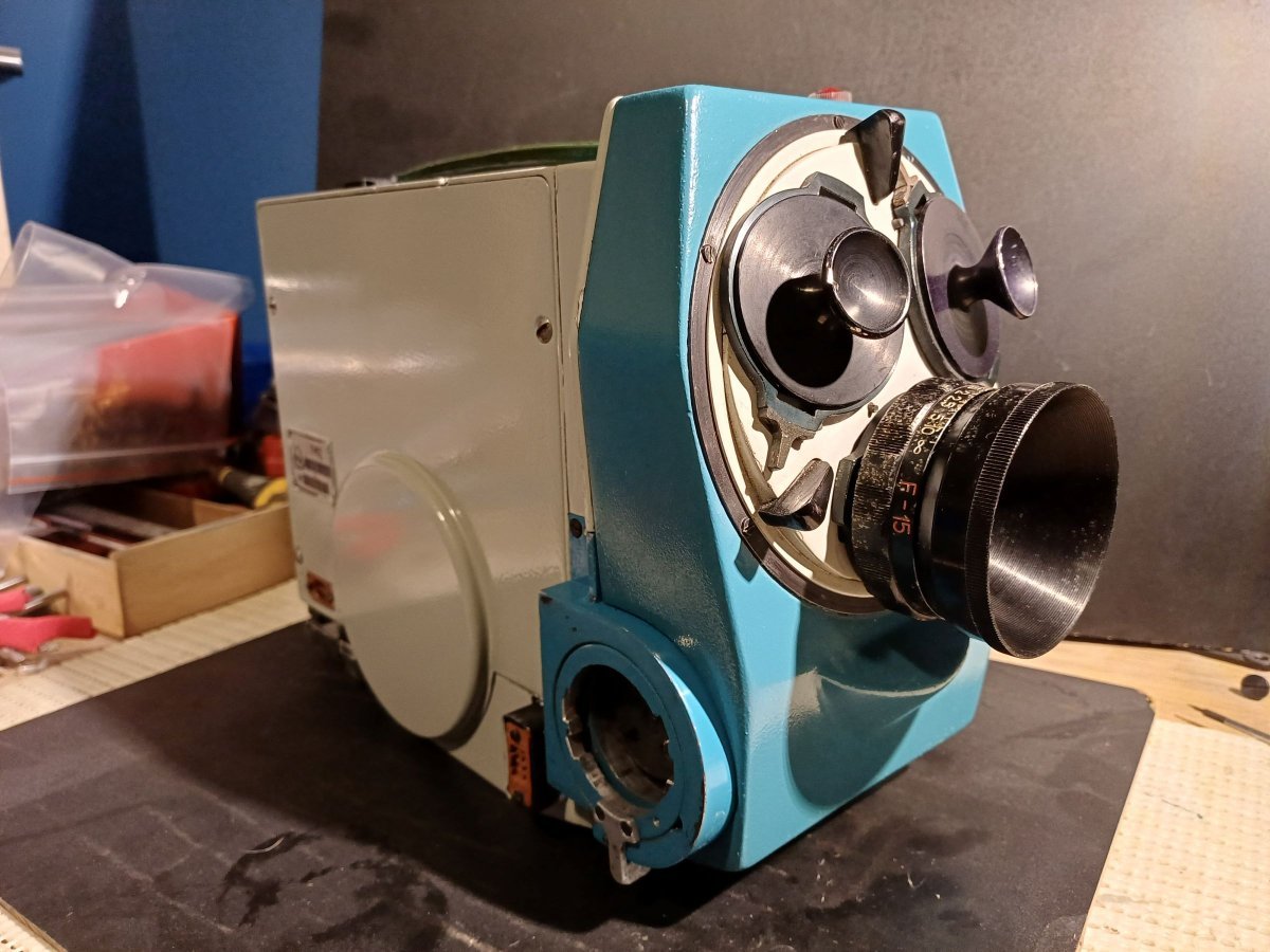

Gareth Blackstock Posted November 9, 2025 Author Posted November 9, 2025 This a recent picture of the camera without it's motor attached, the paint work has come up nicely. I still have found no reason behind the blue and white colour scheme.

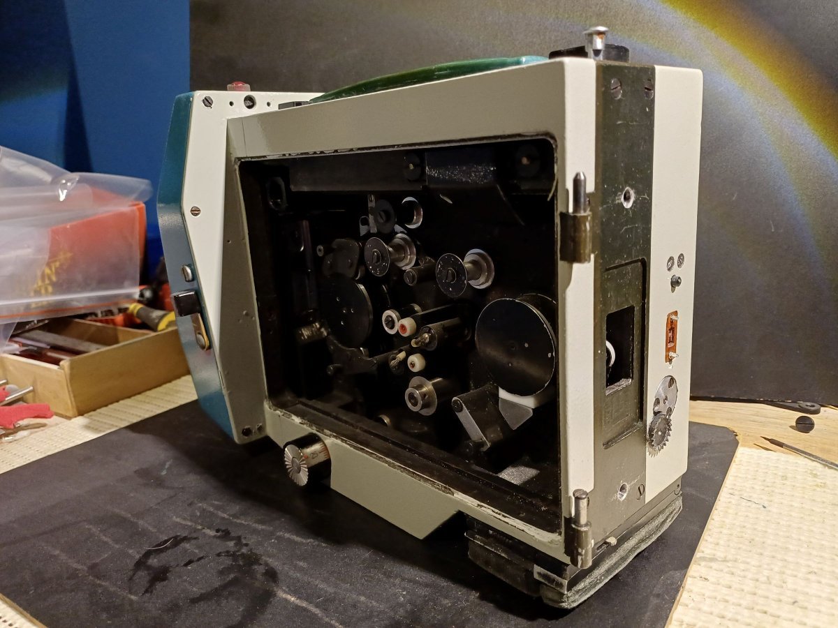

Gareth Blackstock Posted November 9, 2025 Author Posted November 9, 2025 I still have to clean and lubricate the film chamber rollers, et al....

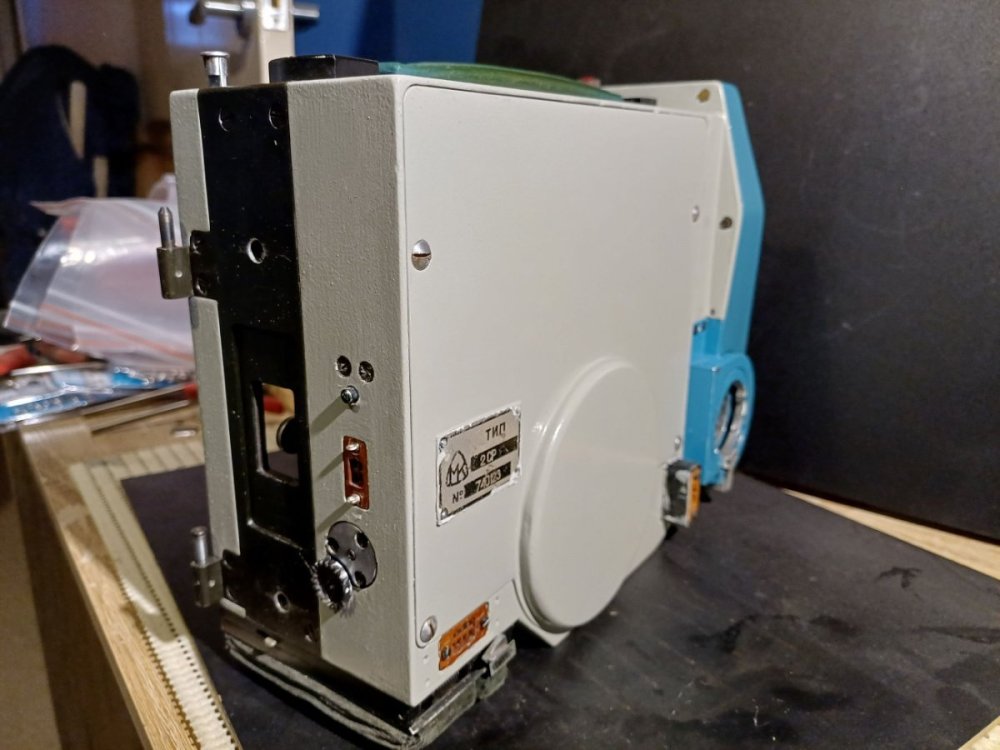

Gareth Blackstock Posted November 9, 2025 Author Posted November 9, 2025 And the final picture of the side panel. The whole side cover was stripped of paint to remove all traces of oxidisation.... I will be very cautious buying cameras in future made of magnesium....
