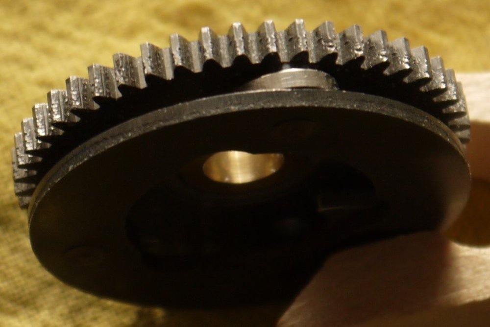

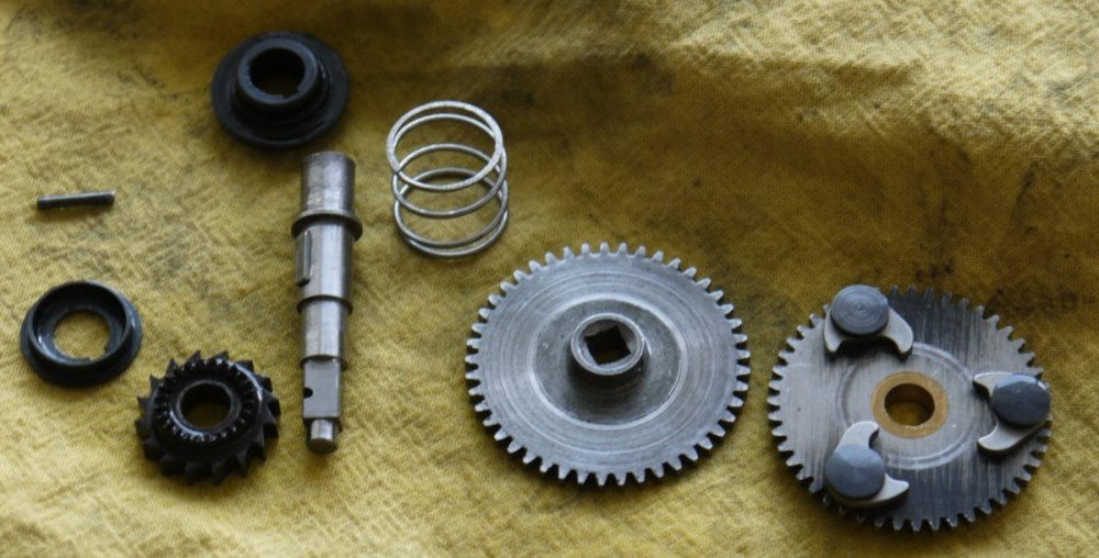

Premium Member Simon Wyss Posted August 16, 2025 Premium Member Posted August 16, 2025 6 hours ago, Tyler Purcell said: There are NO MORE wind up motors and they are not serviceable for the most part because the pin that holds the spring snaps over time. This pin can't be fixed, you need to basically weld in a new pin and it requires a lot of machine time. Yes, there are. The first batch of fresh mainsprings for younger Bolex-H cameras is nearing depletion. A next batch will be of better quality. Imagine, the knowledge about spiral spring making has been retrieved. It was never lost with clockmakers but movie camera drives changed from elastic steel to electric motors. The anchor you mean can be driven out the arbor and also be replaced. Nothing very complicated and expensive. Don’t weld. Work a headed bolt. To round this off, there are other spring-drive movie cameras. Some allow rewinding the mainspring during takes. Only the early Bolex H up to serial number 33200 do. 1
Premium Member Tyler Purcell Posted August 16, 2025 Premium Member Posted August 16, 2025 9 hours ago, Simon Wyss said: The first batch of fresh mainsprings for younger Bolex-H cameras is nearing depletion. Where is someone able to purchase newly re-built motors? I just don't have the time to rebuild them in-house, way too busy. I was told by numerous other techs, re-built motors are all gone. I have multiple people needing them.

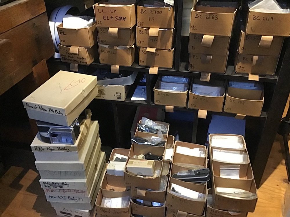

Premium Member Tyler Purcell Posted August 17, 2025 Premium Member Posted August 17, 2025 (edited) 18 hours ago, Dom Jaeger said: I have a stack of parts, as do other experienced...And I’ve been buying Bolexes for years to scavenge the parts I can’t make. It's grossly expensive to buy Bolex bodies in 2025 when the prices have skyrocketed in the last decade. Also, all the parts that get damaged like motors, start/stop assembly and optics of various kinds (amongst other things), they're worn out on any used body you'd get anyway. With good bodies going for $800 - $3000 each (depending on generation) you're basically investing in the hope you'd be able to re-build the components and make money. Some things like the motors, there are generational gaps which means, you basically have to re-build them yourself, which means you're not servicing cameras. 18 hours ago, Dom Jaeger said: I’ve made my own S16 gates and nylon backs, as well as other bits. Manufacturing gates means, you aren't servicing cameras. 18 hours ago, Dom Jaeger said: There were a lot of Bolexes sold over the years, far more than are needed now, so if it takes two cameras to make one that works, so be it. Well yea, obviously physically damaged cameras make great parts bodies, but they're very hard to come by. I have been able to purchase 3 in the last decade for parts at a reasonable rate that was worth while. All the good parts from them are long gone, just some shells and gears left. In the end, I probably lost money buying those bodies and selling the parts. This is why I don't advertise. 18 hours ago, Dom Jaeger said: The hardest part by far is knowledge. If you think servicing Bolexes is easy, you haven’t serviced many. Sure, it’s easy to learn how to disassemble and reassemble them. It’s knowing how to diagnose faults and properly tune them that’s the hard part. This isn't even an experience thing, it's a basic fundamental understanding of mechanics. If you don't have any understanding of mechanical things, you shouldn't ever touch a camera anyway. If you can't diagnose a problem by seeing the camera and trying a few things, then you probably shouldn't be a tech. There is no rocket science to wind up cameras. There are no electronic components to fail, no pechan prisms with fungus in them, no rubber parts that have fossilized or turned into gunk, no precision pulldown movement which requires careful tuning to be quiet, no perfect crystal speed requirements, no battery systems to deal with, no integrated light meters to deal with, no video assists to deal with, no rust and rusty components because Bolex for the most part, used treated screws. No magazines with their own host of problems from; rust, failed sound insulating, broken latches, bad seals, gunked light traps, scratch issues, bad counter and counter rollers, loud drive system and belts. Shit the only thing that really is shared between a Bolex and the stuff I do every day, is really down to the proper running speed, timing/pulldown, transport issues, scratches and light leaks. You can make a Bolex person's day by charging 1 hour of time to fix something simple, which are most peoples issues. With cameras like the Bolex or Beaulieu's, if I have to manufacture a new part, I'll back away. I have been burnt too many times with lower-end camera users not understanding the costs associated with fixing a $500 yard sale purchase. This is why again, I just don't advertise Bolex or Beaulieu service. Honestly I'm so busy, I'm really only taking commercial cameras today anyway. 18 hours ago, Dom Jaeger said: The manuals never really tell you that bit, even Bolex manuals which are among the best. Then there’s knowing the differences between the many models and which parts changed. I’ve been working on Bolexes for over 20 years, and I’m still learning. They are far from simple. Hubris is the one thing you don’t want in a camera tech. When I started my business a few years ago, I was intrigued by opening up a Bolex service department because so many people were struggling to get their cameras serviced, with long wait times and techs simply not responding to emails or calls. Having serviced them in the past with much success, I thought why not buy a few bodies, get re-trained a bit and start doing them as one of my main cameras. The first problem I ran into were parts, in the United States they were impossible to get. I quickly stripped my 3 junk bodies of all their good parts. The second problem was the cost of doing business was financially impossible when you're manufacturing/refurbishing components. It was a total waste of time because customers who own Bolex's for the most part, aren't expecting that type of bill. Then you look at mods, it makes no business sense to develop them all when so few people are requesting them and/or have that kind of money. In the end, your profits are very limited compared to working on professional cameras. At least with professional camera owners, they know exactly what they want, parts are easier to get a hold of and in the end, they have money. Even cameras with wildly complex electronic and mechanical issues, I feel confident if I bill them, they'll pay. Not the case with Bolex owners, at least state side, you just never know. After being burnt a few times, I just said it's not worth it and decided to not take Bolex cameras for anything else but CLA in the future. It's a shame, because I can do the work, it's just down to parts. If Bolex re-opened their offices and I could order parts, I'd immediately taken new cameras. So no, not hubris, it's called being a smart businessman. Edited August 17, 2025 by Tyler Purcell
Premium Member Dom Jaeger Posted August 17, 2025 Premium Member Posted August 17, 2025 32 minutes ago, Tyler Purcell said: . Also, all the parts that get damaged like motors, start/stop assembly and optics of various kinds (amongst other things), they're worn out on any used body you'd get anyway.. Everything you’re writing tells me you know jack about Bolexes. As usual, you pretend to be an expert in stuff you barely know. I can bring most Bolexes back to good working condition and make a business of it, and I’m operating in a market 20 times smaller than the US. By all means, please avoid Bolex service and stick to Aatons. Specialisation helps in this game. I don’t pretend to know about Aaton service despite having worked on quite a few, because I know how much experience counts. I was trained on Arriflex and Panaflex, with 20 years more tech experience than you, so you don’t need to explain to me how pro cameras are different to a Bolex. And despite the apparent simplicity I have found they are still quite difficult to master. Like horology. People reading this can make their own conclusions about your opinions. 1
