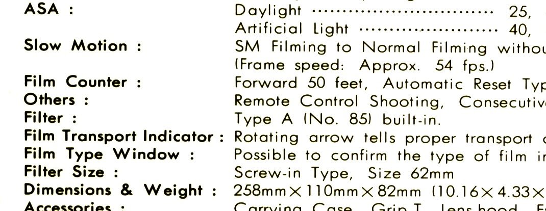

Premium Member Stephen Perera Posted August 21 Author Premium Member Posted August 21 (edited) BTW I have a Nikon R8. My Leicina died on me AFTER accepting to shoot this. I contacted Tyler Purcell for camera recommends but I could NOT get hold of good ones as they had fungus and haze on elements. Oh and I believe the Nikon R8 has an 85A filter in camera that kills 1/3 stop from my metering which will help with the 500T and 200T Edited August 21 by Stephen Perera
Joerg Polzfusz Posted August 21 Posted August 21 Hi! It‘s Super8, hence it’s always a Wratten85 or equivalent (=without A!). Therefore it’s a loss of 2/3 f-stop. When using an external light meter, remember that there are other factors on top that will reduce the amount of light: the camera’s semi-transparent mirror, … . Using an ND filter when shooting outdoors on a sunny day with the 500T is a great idea. Good luck!

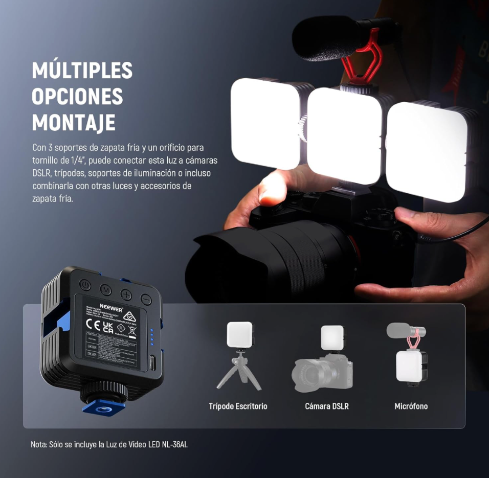

Premium Member Stephen Perera Posted August 22 Author Premium Member Posted August 22 I've ordered a little Neewer light to stick on the hotshoe for when the party gets going....I really like this brand they make good lights. I have a CB60B continuous light that I rate highly. Im gonna test it out see if I like it when it comes in from Amazon. The diffusion I can alter so lets see what its like....think 'shittyrigs' and thats my vibe hahaha
Joerg Polzfusz Posted August 22 Posted August 22 5 hours ago, Stephen Perera said: an 85A on the front thread of 52mm right? No! Use a 85 without A! https://www.kodak.com/content/products-brochures/Film/VISION3-200T-Color-Negative-Film-7213-TECHNICAL-DATA.pdf https://www.kodak.com/content/products-brochures/Film/VISION3_5219_7219_Technical-data.pdf
Mark Dunn Posted August 23 Posted August 23 Actually 85A is what's in the camera, to convert to 3400K, which Super-8 Kodachrome was balanced to. An 85B converts to 3200K, which is the professional standard for tungsten light. The data sheets fudge the difference. https://hoyafilterusa.com/products/hoya-85b So you want an 85B, although the difference will be slight since you're scanning and can correct anyway.
Joerg Polzfusz Posted August 23 Posted August 23 No! 85 without A in daylight! No! 85 without A in daylight! No! 85 without A in daylight! Check the technical data of the Vision3 200T, of the 500T, of the K40 (https://www.repaire.net/forums/attachments/k40-pdf.19075/ ) etc.. Also check the manuals of your cameras! It’s a „Type A“-filter (A=Kodak’s former designation for films designed for Artificial light), but its Wratten-Number is 85 without any letter! So far, the only Tungsten-balanced S8-film from Kodak, that didn’t need a Wratten 85, was the Ektachrome 64T. The E64T needed a Wratten 85B.
