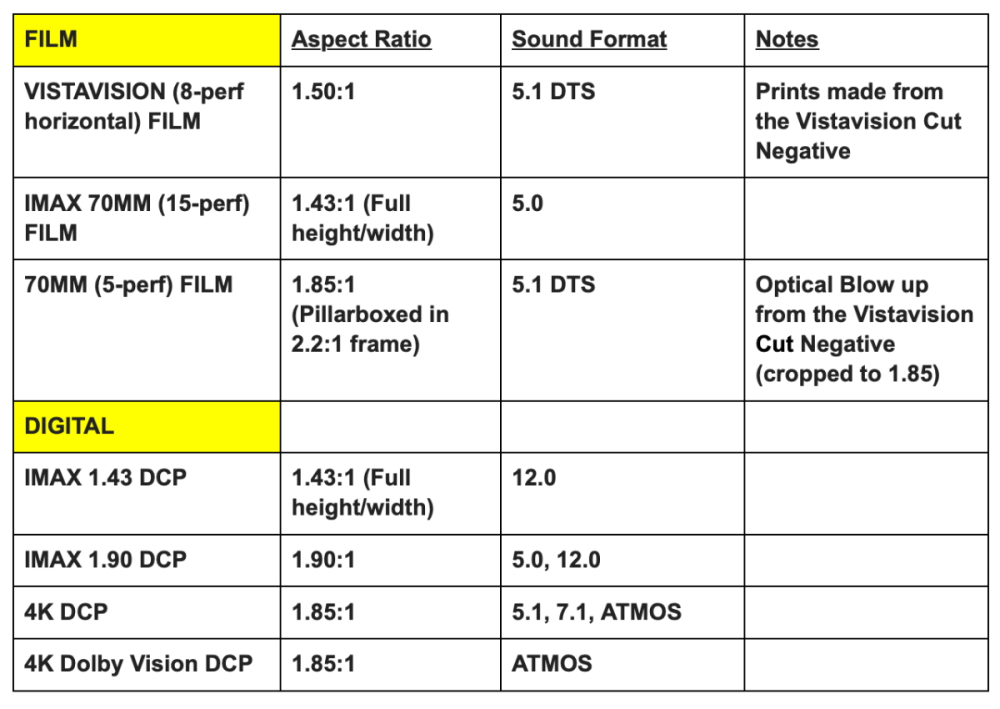

Giovanni Louisor Posted September 19, 2025 Posted September 19, 2025 The 5-perf 70mm version is presented in 1.85:1, pillarboxed within a 2.20:1 frame. https://www.indiewire.com/features/craft/how-to-watch-one-battle-after-another-vistavision-1235151416/ 1
Gautam Valluri Posted September 19, 2025 Posted September 19, 2025 Good to see this! So the film will have two major aspect ratios: 1.5 : 1 and adjacent (1.43) and, 1.85 and adjacent (1.9).
Premium Member Tyler Purcell Posted September 19, 2025 Premium Member Posted September 19, 2025 12 hours ago, Giovanni Louisor said: The 5-perf 70mm version is presented in 1.85:1, pillarboxed within a 2.20:1 frame. https://www.indiewire.com/features/craft/how-to-watch-one-battle-after-another-vistavision-1235151416/ * Note, it does look like the original information released by the studio was incorrect, this chart appears to be the updated and proper information. I hope they edit/fix the studio release information to match.
Jakob Wesner Posted September 19, 2025 Posted September 19, 2025 56 minutes ago, Tyler Purcell said: * Note, it does look like the original information released by the studio was incorrect, this chart appears to be the updated and proper information. I hope they edit/fix the studio release information to match. were exactly was this information officially released by the studio? as far as I know there previously was only one chart that said the 5-perf prints are 2.20 and that was fan-made
Premium Member Tyler Purcell Posted September 21, 2025 Premium Member Posted September 21, 2025 So this is the "new" graphic, straight from Warner. The original one looked like this, also from Warner. We have confirmed (from test screenings) The IMAX 15P prints are 1.50:1 with matte lines at the top and bottom The 5 perf are 1.85:1 pillerboxed similar to The Master. The IMAX digital will also be 1.50:1, not 1.90:1 as referenced in prior documentation direct from Warner. So clearly there were some changes made. The fact that PT went on the record and said the IMAX 15P prints were an optical blow up from the VistaVision negative is very fascinating. I have confirmed with the guys who made the print, it was recoded out. So there are a lot of interesting pieces of information floating around. The good news is that, there won't be much of a "crop' in any of the screenings and to me, that's the most important part.
Jakob Wesner Posted September 21, 2025 Posted September 21, 2025 6 hours ago, Tyler Purcell said: So this is the "new" graphic, straight from Warner. The original one looked like this, also from Warner. Both graphics were made by Adam Hlavac, the first one was not official, WB just likely saw that there was incorrect information on that chart and decided to collaborate on the updated one. Also were did PTA go on the record say that the IMAX 15P prints were an optical blow up? The Indiewire chart only says that the 5-perf 70mm prints are.
