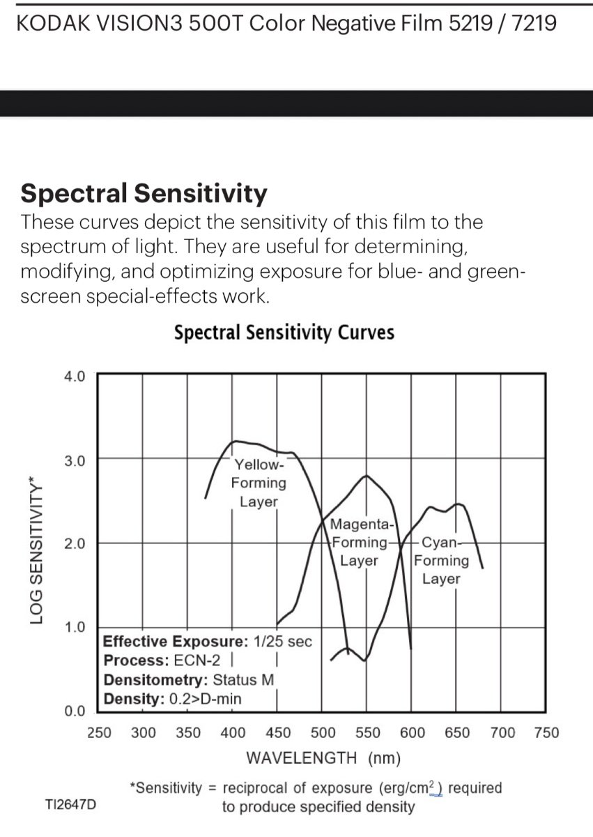

Premium Member Tyler Purcell Posted September 9, 2025 Premium Member Posted September 9, 2025 When Double X and Tri-X were less money than negative, it made sense to shoot black and white in order to save money. Now that Kodak basically charges the same for black and white as color, there really isn't any benefit. Converting color to black and white, isn't desaturating, it's also choosing the right color to enhance. Black and white film is very sensitive in the blue wavelengths rather than red. This is different than color negative, where the green layer is the most sensitive. So in post, you need to do a few tricks in order to mimic that look by enhancing the blue saturation a bit. I have converted color to black and white for years, several films were made this way because 500T is just such a versatile stock, it's hard to be stuck at lower ISO's with double-x when 500T actually has a better grain structure for a more "classic" old school look. I would practice on 35mm still film, using the techniques in Photoshop first. Then once you understand what you're after, you can just mimic that in Resolve, maybe even build your own lut. 2

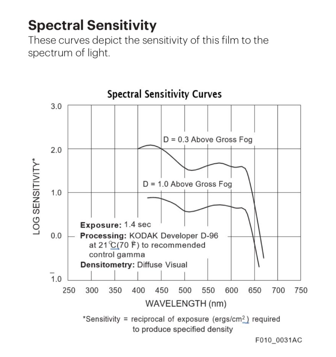

Joerg Polzfusz Posted September 12, 2025 Posted September 12, 2025 Hi! In still photography, when having large prints (e.g. 90cm*60cm aka 3feet*2feet) side by side hanging in gallery, a large majority of people would notice the subtle differences. But in motion pictures, where the spectators would concentrate on the story rather than on the film stock? I doubt that anyone would notice, especially when the final result gets projected digitally. The desaturated Vision3 would free you from the need to use all those „B&W only filters“ as you would have the full color information in your digital intermediate. And simulating the effects of different B&W developers will be just a click of the mouse. Etc.. So there are basically only two pitfalls: 1) recorded wavelengths: some B&W filmstocks are able to see more than the Vision3 (infrared or ultraviolet spectrum). The Double-X can „see less“ than Vision3. 2) „ditch“ post processing: With all those effects available in your editing software, it’s very easy to „overdo“ the conversion to B&W and to end up with „strange“ results. E.g. something like the yellow cabs in an otherwise B&W image: https://de.pinterest.com/pin/197876977364793922/

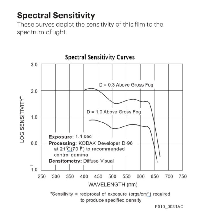

Joerg Polzfusz Posted September 12, 2025 Posted September 12, 2025 (edited) Double-X does not start at 375nm (also note the different log sensitivity that will also result in subtle differences): Edited September 12, 2025 by Joerg Polzfusz
