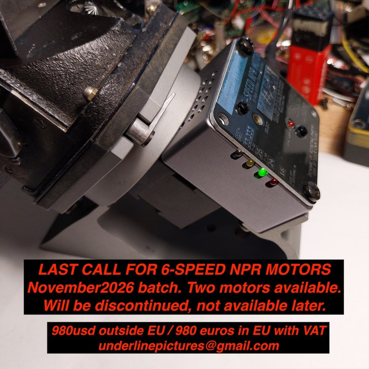

some photos from Tuesday's short film shoot! the prototype motor with Aaton Counter and my custom cheeseplate which holds the mini-vlock plate
I calculated that I can make another batch in October2026 where it is possible to order the motor without the lower part and power cable and it is considerably cheaper. If someone wants to order the motor this way, let me know. It is also possible to order a fully assembled motor too, will calculate the price if there is demand for them.

I have parts to make two extra motors in the batch. This 6-speed motor will be discontinued right after the batch is done so if someone wants to order this motor it needs to be ordered now.
Two available, after that not possible to get this motor anymore. Too expensive cnc parts and time consuming assembly, not going to make more.
Edited by Aapo Lettinen
Low production capacity from now on. Lots of business customers ordered large quantities of products so will take til mid December to be able to make more individual motors. I will also complete the already paid orders before assembling the new orders taken from now on.
I could make one or two NPR 6-speed motors in December-January if they are ordered in October2026.
