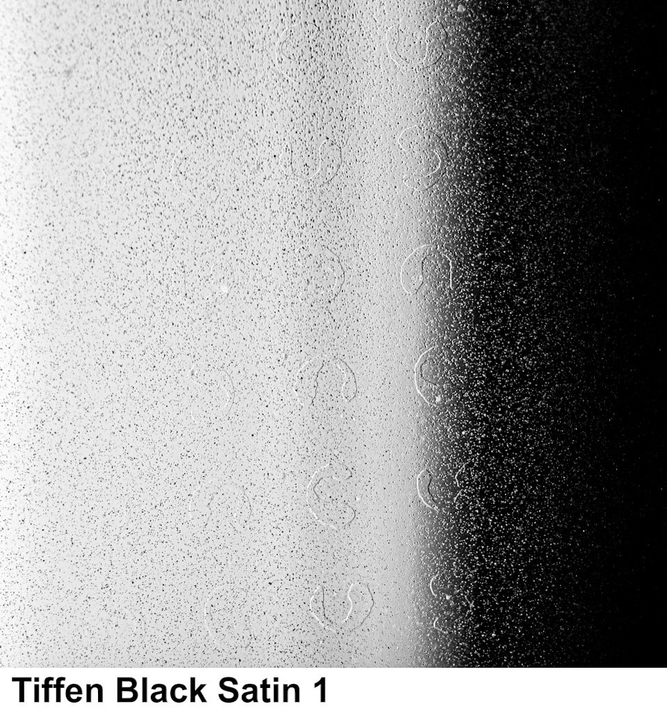

Premium Member David Mullen ASC Posted October 3, 2025 Premium Member Posted October 3, 2025 The Cooke S4 isn’t too soft unfiltered so you can adjust the softening by the degree of filtering. Using a sharper lens with heavier diffusion is just a different look, more for when you want the artifacts of diffusion like halation but want to keep more sharpness. Black Satins combine degrees of Digital Diffusion F/X with some base level of Black GlimmerGlass. So it’s two filters in one — meaning you can also use them separately like just use the Black GlimmerGlass if you want more halation but less softening or just the Digital Diffusion F/X (or try Black Diffusion F/X) when you want softening but no halation. ”The Crown” on Netflix used Cooke S4 lenses with GlimmerGlass. Here is a macro photo I took of the filter. The “C” shaped pattern is the Digital Diffusion F/X filter. The specks are from the Black GlimmerGlass.
Stefano Stroppa Posted October 5, 2025 Author Posted October 5, 2025 Thank you @David Mullen ASC That Black Satin macro photo is very interesting, I did not know about it. It's been ages since last time I shot with something like the Zeiss CP.3 (but definitely a cheap rental option around here, so it's worth considering it), I keep hearing people saying they are cold and dull, that’s the reason why I was considering going for something warmer and somehow softer. I want to keep it sharp, yet I definitely want to have the typical halation around highlights given by the filter, would fit very well with the story, with all the practicals, the interior and ext. shots, so maybe such Zeiss paired with an heavier density of the filter could work well. I definitely need to test. Appreciate the reply!
