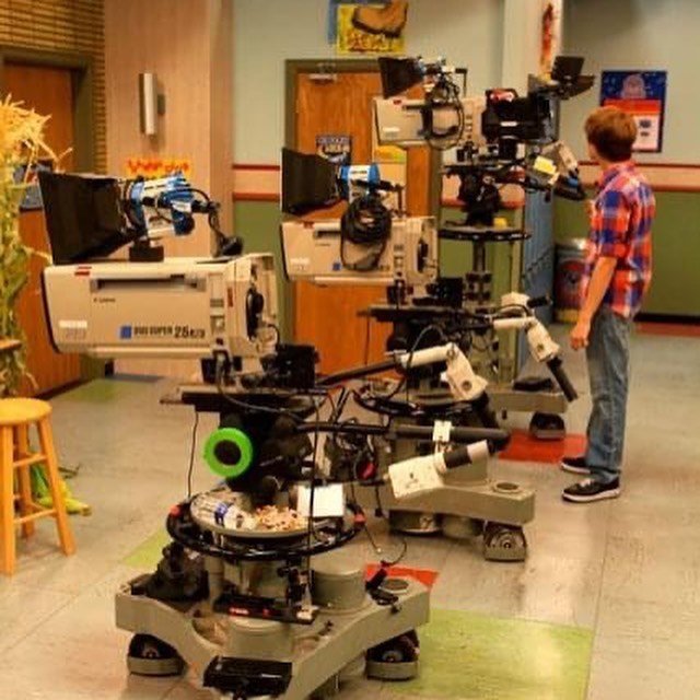

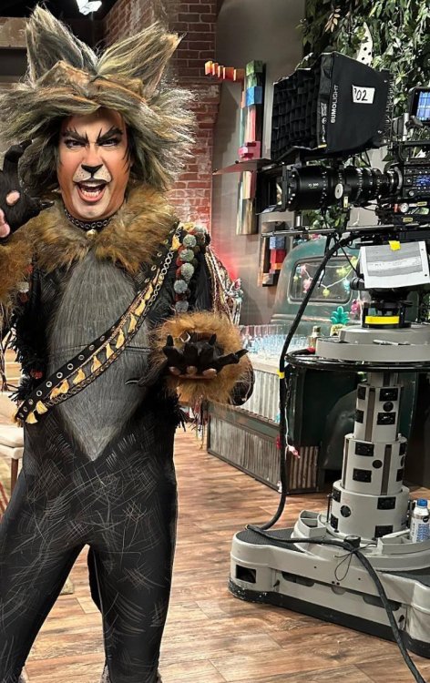

Samuel Berger Posted October 9, 2025 Posted October 9, 2025 Hey guys, I am attaching a picture of a Nickelodeon sitcom setup (specifically iCarly). I noticed they were using Sony HDC-1500 cameras and what looks like Canon Digi Super box lenses mounted on Vinten Osprey pedestals. But there appear to be small Arri lights mounted on the zooms. I found this to be a weird placement but I don't do broadcasting. Any idea what that is? Thanks in advance.
Mark Dunn Posted October 10, 2025 Posted October 10, 2025 (edited) I think they're Arri 300 fresnels. David M will tell you about bashers or obies. Edited October 10, 2025 by Mark Dunn 1
Premium Member David Mullen ASC Posted October 10, 2025 Premium Member Posted October 10, 2025 Yes, probably 300W ARRI tungsten fresnels just because they look in between the size of the 150W and 650W... 1
Samuel Berger Posted October 14, 2025 Author Posted October 14, 2025 On 10/10/2025 at 11:24 AM, David Mullen ASC said: Yes, probably 300W ARRI tungsten fresnels just because they look in between the size of the 150W and 650W... Hey thank you! I'm tempted to try this with an Aputure MC... I wonder what they aim for on these sets. Maybe f8? Those Sonys had 2/3" CCDs so I'm guessing the depth of field was there...

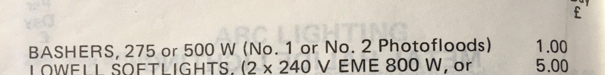

Mark Dunn Posted October 14, 2025 Posted October 14, 2025 (edited) It's been a while but I think more like 2.8-4 to keep the air conditioning demand down. Not such a factor nowadays. As you say DoF was not lacking. Lucien Ballard is supposed to have devised the eye light for his then wife Merle Oberon- hence "obie". Otherwise, from where it's mounted it's known as a "blimp basher." Presumably because it bashes away shadows. I don't think I've made this up but it's hard to find a reference. The Samuelson's catalogue refers to them with a photoflood bulb (275 or 500W) but the point is it's a small soft source- maybe those fresnels have a diffuser over the barn doors or in the slot. Edited October 14, 2025 by Mark Dunn 1
Samuel Berger Posted October 14, 2025 Author Posted October 14, 2025 8 hours ago, Mark Dunn said: It's been a while but I think more like 2.8-4 to keep the air conditioning demand down. Not such a factor nowadays. As you say DoF was not lacking. Lucien Ballard is supposed to have devised the eye light for his then wife Merle Oberon- hence "obie". Otherwise, from where it's mounted it's known as a "blimp basher." Presumably because it bashes away shadows. I don't think I've made this up but it's hard to find a reference. The Samuelson's catalogue refers to them with a photoflood bulb (275 or 500W) but the point is it's a small soft source- maybe those fresnels have a diffuser over the barn doors or in the slot. According to Jamie Hitchcock: "That is a light on each camera. An Arri LED to be exact. They were only used when the cameras were in tight quarters and some extra fill light was required. We just kept them on the cameras at all times so they could be turned on quickly if needed. They are commonly called “Obie” lights. They were named for actress Merle Oberon who had deep set eyes and the cinematographer found that a light mounted on the camera right above the lens helped fill her eyes during close ups."

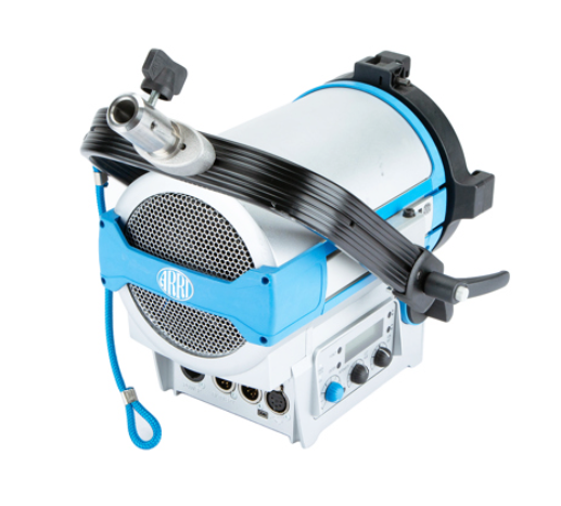

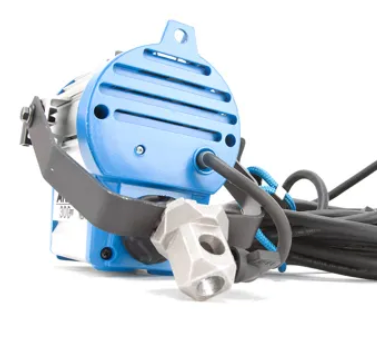

Premium Member David Mullen ASC Posted October 15, 2025 Premium Member Posted October 15, 2025 I hate to correct someone but those are ARRI tungsten fresnels, not LEDs. The heat vent grills on the back and sides are the main clue. Also, an Obie light is not a specific unit, it's any light mounted over a lens, sometimes for a key light not just for fill. The concept is named after Merle Oberon by her husband at the time, cinematographer Lucien Ballard. But whatever specific unit he used back then (late 1940s) is long-gone probably. Here is a photo of the back end of a small ARRI LED fresnel:

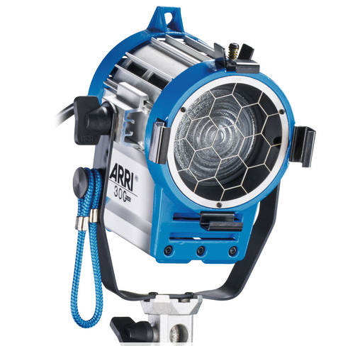

Premium Member David Mullen ASC Posted October 15, 2025 Premium Member Posted October 15, 2025 Here is the front and back of an ARRI 300W tungsten fresnel:
Premium Member David Mullen ASC Posted October 15, 2025 Premium Member Posted October 15, 2025 I'd also point out that the original "iCarly" was shot from 2007-2012 and the ARRI LEDs didn't even hit the market until 2011. And I suspect the reboot in 2021 was not shot on a 2005 video camera. 1
Samuel Berger Posted October 15, 2025 Author Posted October 15, 2025 12 hours ago, David Mullen ASC said: I'd also point out that the original "iCarly" was shot from 2007-2012 and the ARRI LEDs didn't even hit the market until 2011. And I suspect the reboot in 2021 was not shot on a 2005 video camera. Thanks, Dave! I've been thinking of getting an Arri Locaster for this function. Sometimes they go pretty cheap. I use a Sony F55 with Fujinon zooms. Any suggestions? Some ideas were the Aputure MC Pro, the Locaster 2, or even an Arri 300.

Mark Dunn Posted October 16, 2025 Posted October 16, 2025 (edited) 16 hours ago, David Mullen ASC said: I wouldn't mess with a hot tungsten light mounted over the lens these days for an eyelight/fill -- an Apurture would be a good idea but I'm sure there are a number of choices. Here's that page from the Sammy's 1980 catalogue. A 500W photoflood in your face lol. Edited October 16, 2025 by Mark Dunn

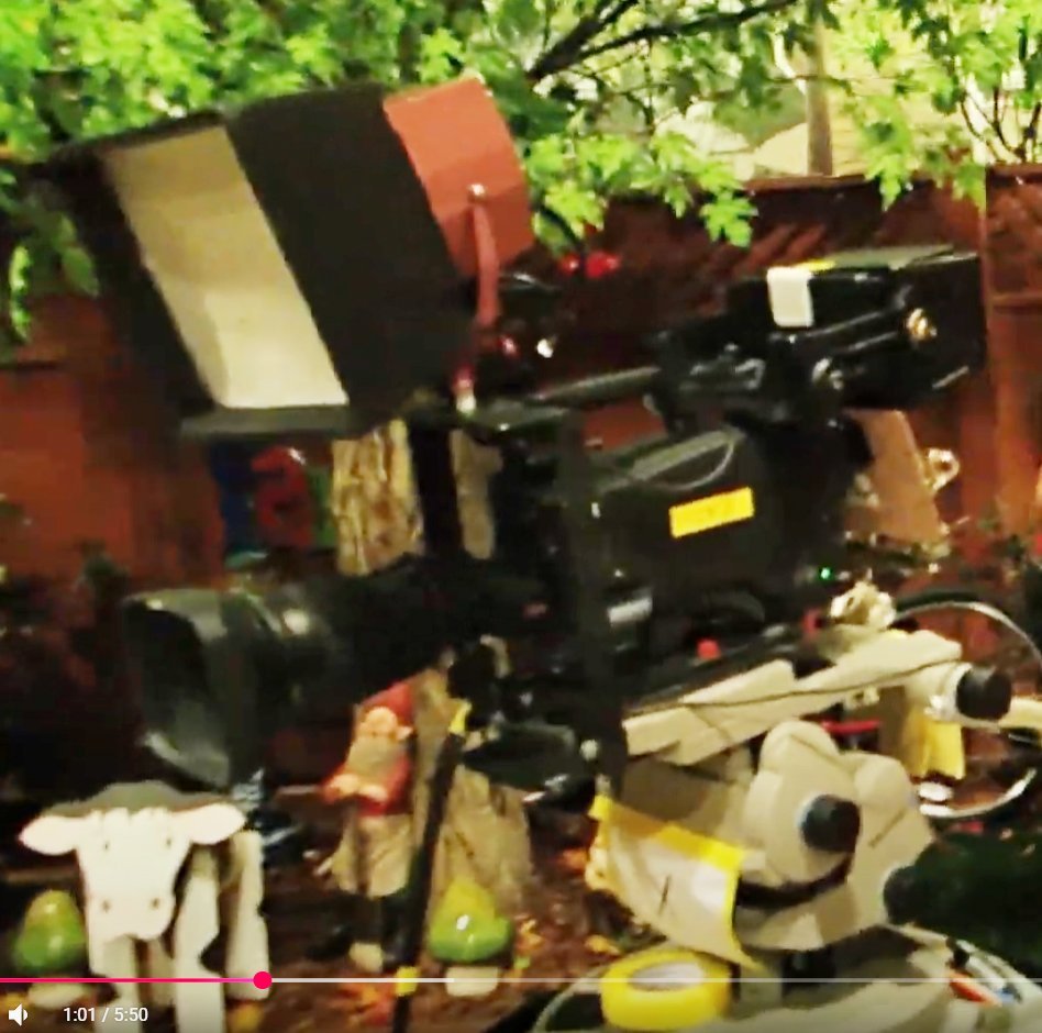

Samuel Berger Posted October 20, 2025 Author Posted October 20, 2025 On 10/15/2025 at 12:32 PM, David Mullen ASC said: I wouldn't mess with a hot tungsten light mounted over the lens these days for an eyelight/fill -- an Apurture would be a good idea but I'm sure there are a number of choices. This is the obie they used on Liv & Maddie. I can't for the love of me identify that fixture. Does it look familiar to you?
Eric Eader Posted October 21, 2025 Posted October 21, 2025 Looks to be a Mole-Richardson "Inky-Dink', or 'Dinky Inky' (300watt, maybe 650w, incandescent fresnel), with a built on soft box. Don't have their catalog from that time period anymore, so I cant be more specific.

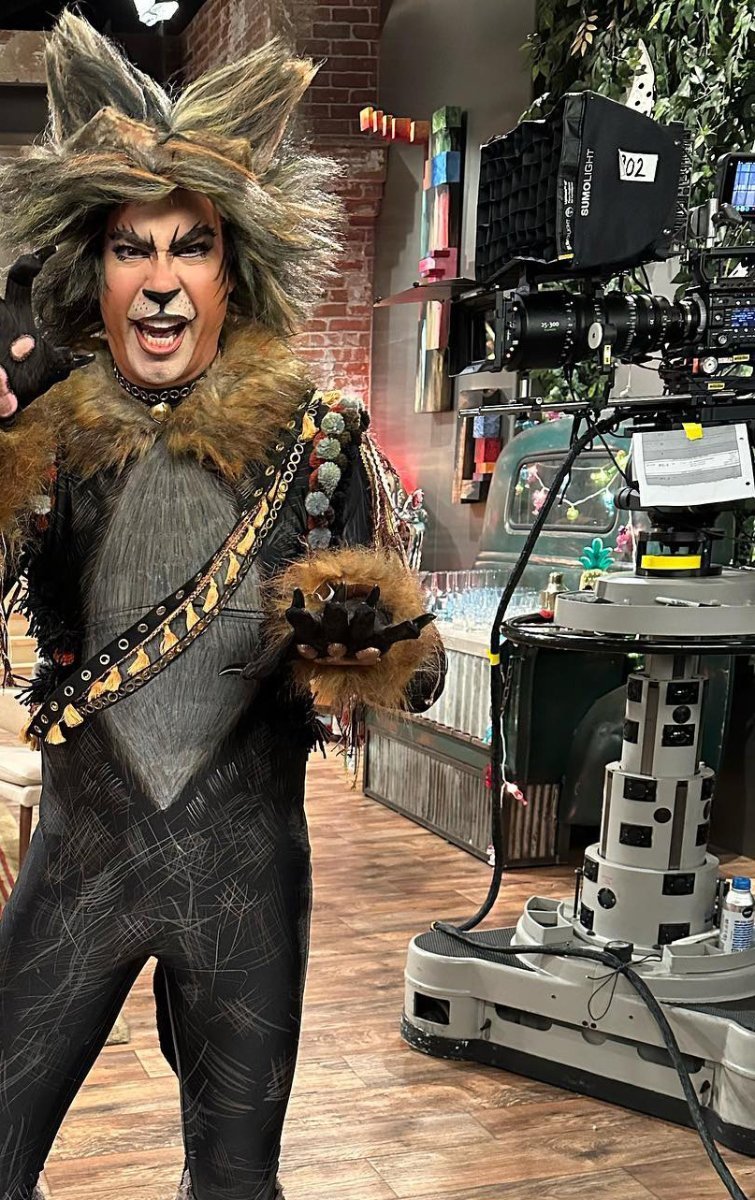

Samuel Berger Posted January 3 Author Posted January 3 (edited) On 10/14/2025 at 8:45 PM, David Mullen ASC said: I'd also point out that the original "iCarly" was shot from 2007-2012 and the ARRI LEDs didn't even hit the market until 2011. And I suspect the reboot in 2021 was not shot on a 2005 video camera. And you are correct. The iCarly revival was shot on multiple Sony F55s with the Fujinon 25-300 on Fulmar pedestals. I wonder what Obies they are using in that Sumolight softbox! Edited January 3 by Samuel Berger
Samuel Berger Posted January 3 Author Posted January 3 It turns out they were using a SUMOLIGHT Sumo100+ which is basically a glorified overpriced Amaran P60x.
