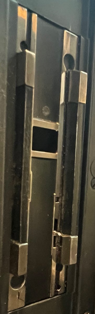

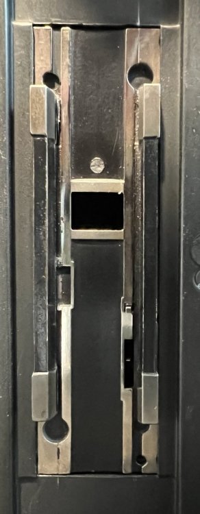

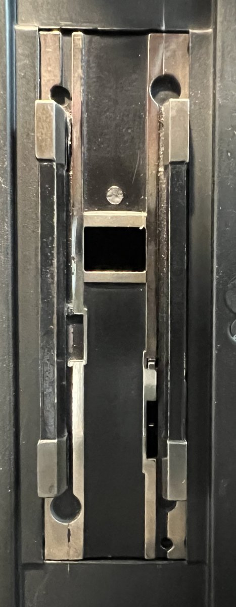

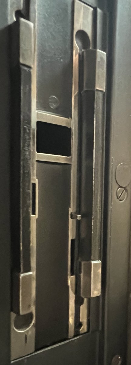

Premium Member Simon Wyss Posted October 13, 2025 Premium Member Posted October 13, 2025 Jordan, would you mind sending me a photo of the uncleaned, untouched camera gate, if possible? I can upload it to the forum. If not working via PM, send to my E-Mail address 1

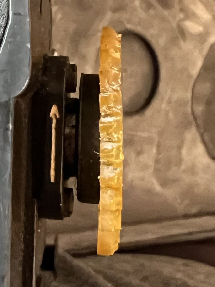

Premium Member Simon Wyss Posted October 14, 2025 Premium Member Posted October 14, 2025 Pictures from Jordan, only cropped for upload 1
Premium Member Aristeidis Tyropolis Posted October 14, 2025 Premium Member Posted October 14, 2025 Interesting, Is the pull-down claw side railing seriously scratched, or is it some sort of residue?

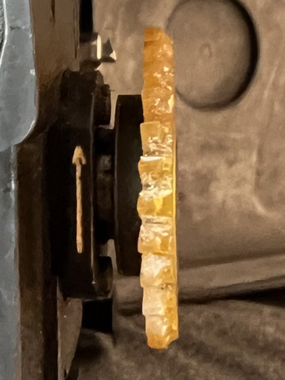

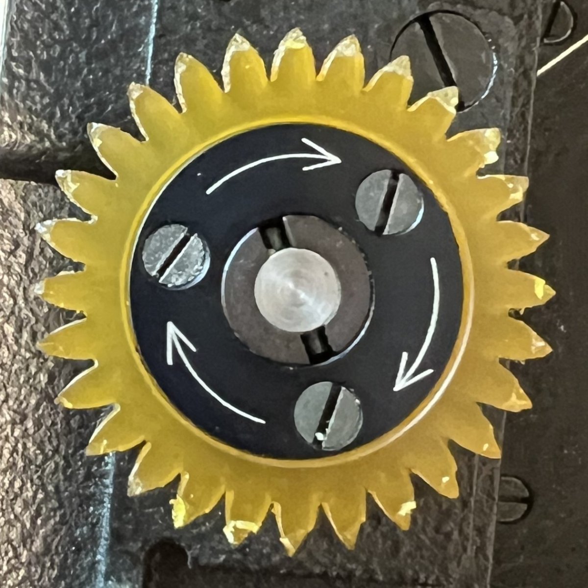

Premium Member Dom Jaeger Posted October 14, 2025 Premium Member Posted October 14, 2025 I’d say that mag drive gear is your problem. Each time a drive gear tooth slips the loop shifts internally. Eventually a bad loop causes film to chatter then jam. AM Camera might have spares. Might be worth having them check the movement after punching holes and being stressed over the duration of multiple mags. 1
Jordan Pellegrini Posted October 15, 2025 Author Posted October 15, 2025 Thank you all! I’ll have the camera taken in to get serviced and the drive gears replaced on the mags. 1
Vincent Wolfram Posted October 16, 2025 Posted October 16, 2025 That drive gear is definitely f-ed! Does anyone make replacements still? I wonder if I could art something up
Premium Member Tyler Purcell Posted October 16, 2025 Premium Member Posted October 16, 2025 4 hours ago, Vincent Wolfram said: Does anyone make replacements still? I wonder if I could art something up We make some really nice ones if you need any.
