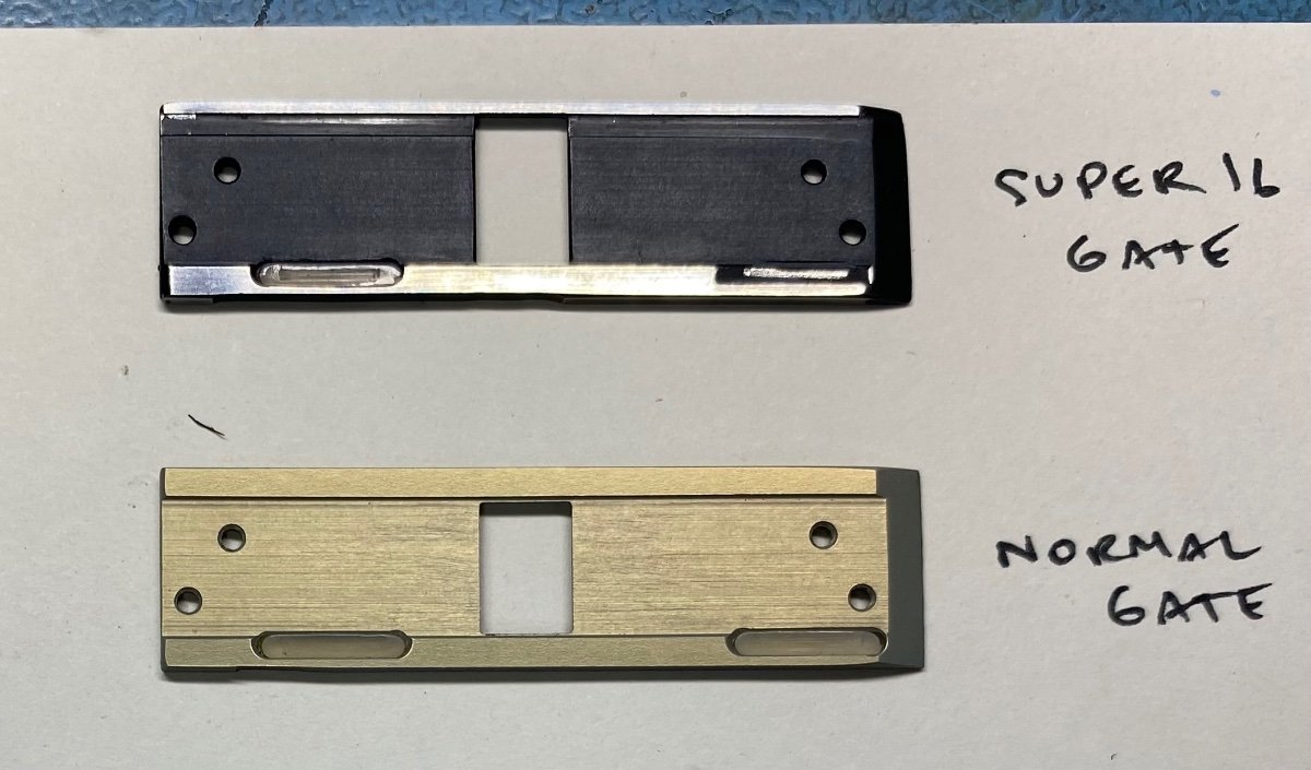

Premium Member Dom Jaeger Posted October 29, 2025 Premium Member Posted October 29, 2025 No that’s a H16 REX 1, with a 6x viewfinder. First model to have a variable shutter and automatic opening of the loop formers when the lid is fitted. REX 2 models have the 10x viewfinder. The serial number on the round base should give you an idea of the year of manufacture. The easiest way to check if it really has been converted to S16 is to remove the pressure plate and look at the gate. (Or if the seller doesn’t know how to remove the pressure plate just look at the shape of the gate opening through the front.)
Zach Mckinley Posted October 29, 2025 Author Posted October 29, 2025 36 minutes ago, Dom Jaeger said: No that’s a H16 REX 1, with a 6x viewfinder. First model to have a variable shutter and automatic opening of the loop formers when the lid is fitted. REX 2 models have the 10x viewfinder. The serial number on the round base should give you an idea of the year of manufacture. The easiest way to check if it really has been converted to S16 is to remove the pressure plate and look at the gate. (Or if the seller doesn’t know how to remove the pressure plate just look at the shape of the gate opening through the front.) Gotcha it seems like the film gate might have been converted but its hard to say! My base had a cover on it so I didn't notice the serial but you are correct! It looks like its a REX-1 from 1962! IMG_3445.jp2
Premium Member Dom Jaeger Posted October 30, 2025 Premium Member Posted October 30, 2025 Looks like standard 16.
