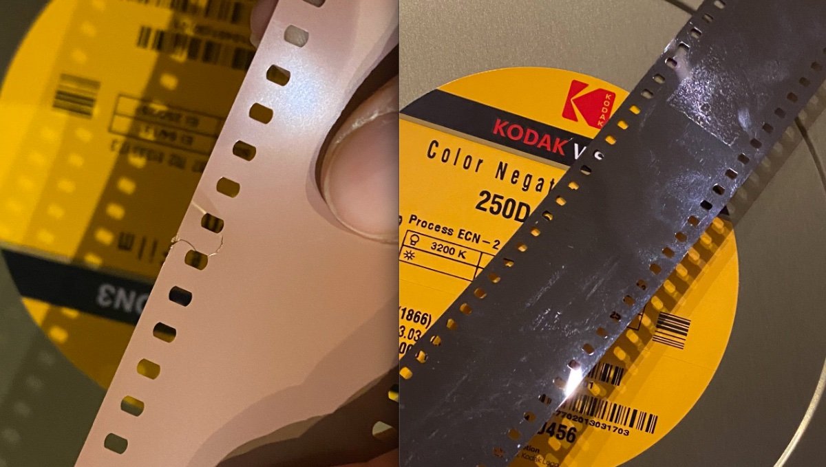

Elena Bertelli Bianchi Posted November 17 Posted November 17 Hello community, It's been 3/4 months since the AHU technology made its debut, what do you think about it? As cinematographers (or not), do you see any changes or differences? As a Loader I'm working with AHU since september and I noticed it feels a bit "softer", it tends to slide a bit more on itself than its predecessor when you load or unload it. Kodak claims that "The AHU stocks fall within the 5-micron range of low-to-high tolerances for remjet Vision3 thickness, with a differential of just 2 microns, a figure Kodak regards as immaterial." (American Cinematographer, august 2025) so I don't know if these 2 microns are responsible or if it was the rem jet layer that made the previous stock feel a bit more "stiff"... Regarding visual performance I don't have much to say, hopefully somebody here will share their experiences. The only noteworthy thing I observed during camera tests relates to shots that include strong in-camera light sources (for example, a night scene with streetlights, or a interior with a very bright window in frame, or a big flare). The halo produced by very bright objects (relative to the overall brightness of the scene) seems to impress onto the next/previous frame, depending on the light source's position into the image. Kodak film already had this issue but with AHU it looks definitely enhanced (unfortunately I don't have any reference img to share). Last but not least, has anyone noticed a slight general decline in quality control? I often find the beginning of the roll scratched or with broken perforations , the sticker that keeps the roll closed fully glued down or badly attached, and sometimes the tape that seals the can is damaged (in some cases to the point where I had to send the rolls back to the supplier). Of course this part of the roll is only for threading the camera and it's not meant to be shot, but still... I do not remember the remjet stock being like this... That's the last fresh roll I loaded today, I'm finding this kind of things a lot... scratches are VERY common (first meters of the roll only), the perf damage is less common but has happened to me 4/5 times in the last couple of months (and it had never happened before) Are you noticing the same issues or I'm just being unlucky? 1

Premium Member Marcel Zyskind Posted November 18 Premium Member Posted November 18 I'm shooting a film on 16mm with the new AHU stock at the moment with a 416 as A camera and XTR Prod and SR3 as B and C cameras. I find that on the 416 there is a lot more emulsion build-up and a lot more hair in the gate than previously. XTR and SR3 don't seem as affected, but are used a lot less. I'm mainly on the 416.

Premium Member Tyler Purcell Posted Tuesday at 07:18 PM Premium Member Posted Tuesday at 07:18 PM I just wanted to post a follow up. My initial post about the stock working was with my own cameras, which are very well tuned because we shoot a lot of stuff. Since my early post in November, I have received 4 cameras, two Aaton's and 2 Arri SR's with issues directly related to AHU stock. All 4 of them work fine with Remjet, zero issues. I tested them and they are flawless. With AHU stock, we get back side scratching on all of them. We also have instability issues within the Aaton cameras specifically. I have done more scratch mitigation work than I've ever done before on these cameras. It seems like perhaps, the AHU stock creates more friction. I have noticed the perforation holes also deflect easier, this is an issue I saw directly on the Aaton cameras with penetration on the lower side of the spectrum, something I use to do purposely to keep the quiet. Now you can't do that trick anymore, you have to run penetration up much higher. The AHU stock is thinner, not much but it is. I don't think the thickness is necessary the problem, but I do think the stock flexes MUCH MORE than the Remjet stock, you can feel it when you work with it as well, it just feels like a lighter weight material. I think the carbon coating of the remjet made the film deflect less. I will do more scientific studies on this shortly, but I purchased some AHU stock for testing these cameras and it took a lot of work to get them not to scratch. Now I need to test every camera with AHU, which is expensive because it has to be NEW stock.
Premium Member Simon Wyss Posted Wednesday at 02:39 PM Premium Member Posted Wednesday at 02:39 PM Misunderstood, Mark. Thank you Tyler, I think that the behaviour is clearly a function of the black backing no longer there. The soot-gelatine back coat is something different from the very thin anti-static protective layer which doesn’t consist of gelatine. Regarding the perforation it would be interesting to know whether Kodak punches intermittently or continuously. With 16-mm. stock, if Kodak notes REDUCED TOLERANCE PERFORATION, you know it’s step punched. With 35-mm. films we’re once more left in the dark. Hole edges can come out a little upset. Unfortunately carbide tooling is used on the drum perforators, not resharpened soon enough. These wear down as well as steel ones, only slower. Carbide can be topped up. 384 parts per heart, it takes Kodak a month to finish a heart. They have a number of them. A slower 35 Bell & Howell perforator has 8 punches and an 8-holes die. Plus the pilot pins. Refurbished within hours. 1
