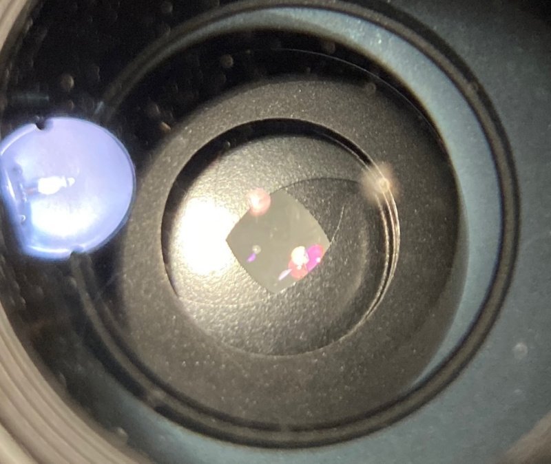

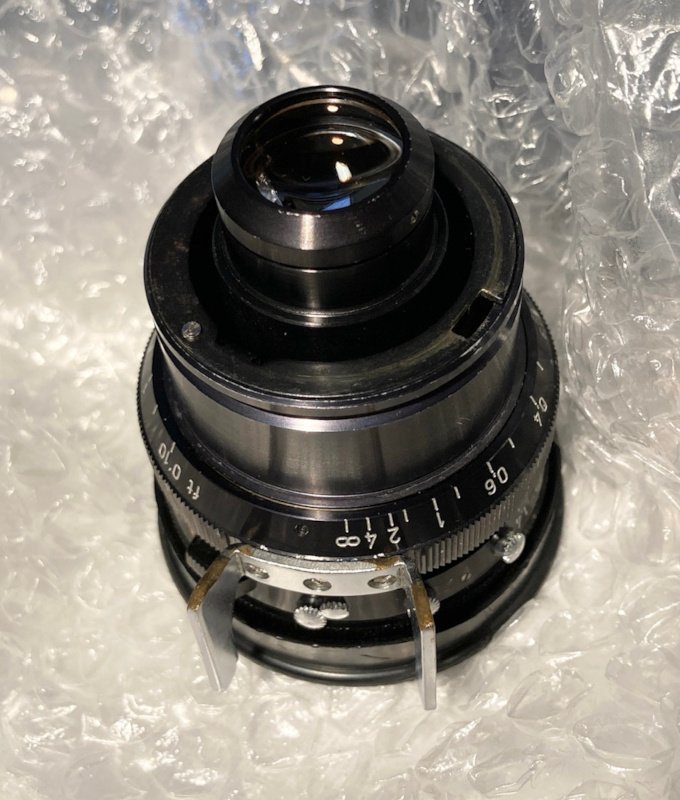

Marc Roessler Posted November 26 Posted November 26 I have a Schneider Cinegon 1,4/16 here, real nice condition, no lens damage, no haze etc... but it's always been quite a bit soft, especially when compared to it's 10mm and 25mm companions. It has the strange square shaped diaphragm opening, I've also been wondering what's up with that one (the f2 16mm Cinegons have a more "normal" one). In your experiences, by design, is this lens notably softer than the others when used at T2.0 or even wide open? Softness is not enough to be noticeable on the grainy Arri 16S ground glass, bit the difference is definitely there when looking at a print or a scan, and it's bugging me. By the way, is there anyone in Germany who still does checkup/service of these old lenses? Best, Marc

Marc Roessler Posted November 27 Author Posted November 27 Thanks for the input, Dom! What's puzzling to me: the accompanying 25mm is also an f/1.4 lens and is super sharp, same for the 10mm 1.8. But it may indeed be a problem with the lens design itself. Will try to do some more tests stopped down beyond f/2.
