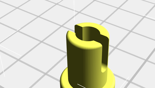

Premium Member Aapo Lettinen Posted February 8 Author Premium Member Posted February 8 Started to design the axle adapter for the 1:1 version. Ordered a test version to see how the fitting works with the current dimensions. Looks like the adapter can just be aluminium but will run tests. The motor will have a kind-of-secret-for-now slip disc design to protect the camera mechanics when the motor is stopped or if there is film jam etc. Working on the prototype and will show the final one when the time is right and it is tested and everything 🙂

Premium Member Dom Jaeger Posted February 9 Premium Member Posted February 9 3 hours ago, Aapo Lettinen said: Started to design the axle adapter for the 1:1 version. Ordered a test version to see how the fitting works with the current dimensions. Looks like the adapter can just be aluminium but will run tests. The motor will have a kind-of-secret-for-now slip disc design to protect the camera mechanics when the motor is stopped or if there is film jam etc. Working on the prototype and will show the final one when the time is right and it is tested and everything 🙂 Hi Aapo, In case you're not aware, the 1:1 shaft pin was changed to an asymmetric pin in 1968 (after serial number 240400 on RX5 models, something similar on other models, and on all bayonet models SB, SBM). This means the drive adapter needs a larger (at least 2.5mm wide) slot on the side corresponding to the red dot on the shaft, facing the front in the stop position, in order to work with most 1:1 cameras. As found in MST, ESM and other 1:1 motors.
