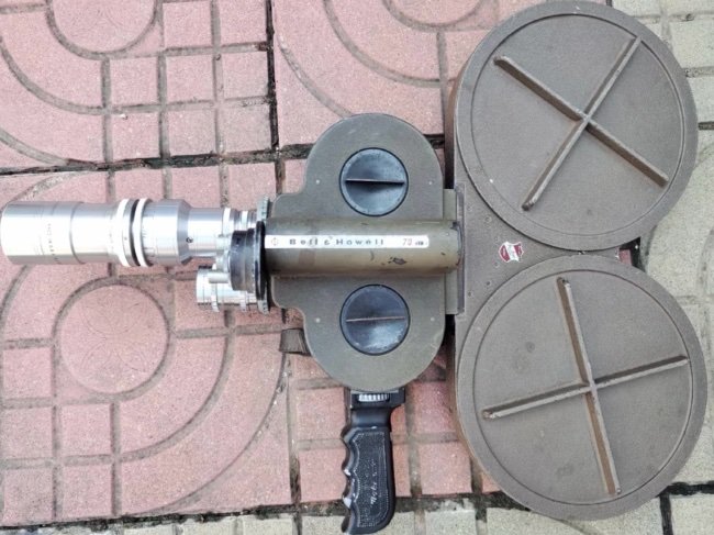

LEE HO TING Posted December 11, 2025 Posted December 11, 2025 Good day to everyone. I have recently found some Bell & Howell 70-HRs and 70-KRMs with 400ft magazines online, and I am interested in buying one. However, I would like to ask a questions before actually buying the camera, just to be safe. How to load the 400 feet magazine? Must the whole process be done in total darkness? Thank you. The attached photo is from one of sellers.
LEE HO TING Posted December 11, 2025 Author Posted December 11, 2025 I’ve also read that an electrical motor is needed in order to run the 400ft magazine. May I also ask, Can the motor for HR be used on KRM? How to install the motor? And, What voltage does the motor run on? (110V?) Thank you.
Premium Member Simon Wyss Posted December 11, 2025 Premium Member Posted December 11, 2025 (edited) 5 hours ago, LEE HO TING said: I’ve also read that an electrical motor is needed in order to run the 400ft magazine. That’s incorrect. You connect the magazine take-up pulley to the camera drive pulley by a closed coil spring. PS. Don’t buy a camera from someone that puts it down on mineral tyles in the backyard. Edited December 11, 2025 by Simon Wyss
