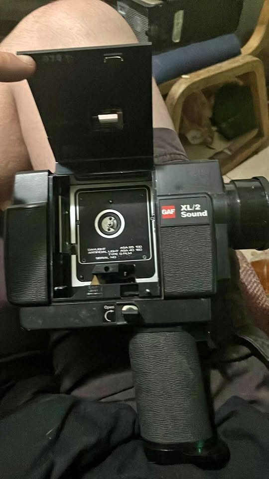

The first is a "GAF XL/2 Sound Super 8" according to the post. I've included a photo of it below, and here is a video. When I asked if it was operable, the seller told me: "Yes I believe it still works. Don’t have any film to try it out" which doesn't inspire a TON of confidence. The cost is listed at $35.

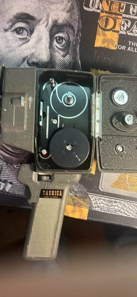

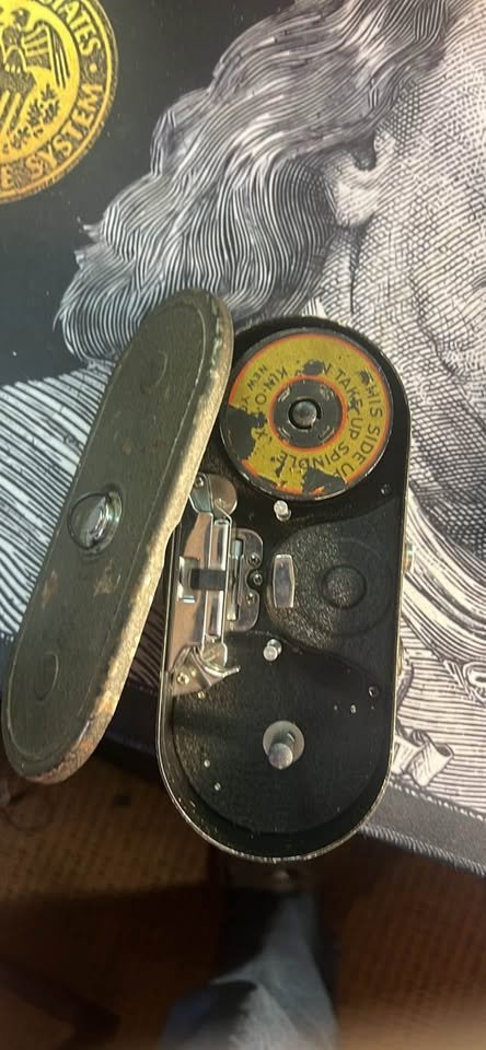

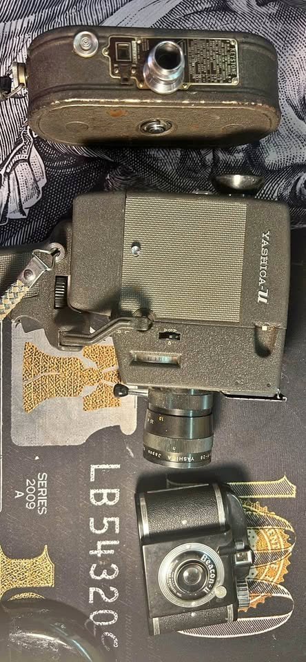

The second is actually a listing with multiple cameras and I've included some photos below. They're titled as "Keystone 8mm film camera, a Yashica-U film video camera and a Beacon II camera" and priced at $15. The seller said "The Keystone camera seems like it would work because it’s film rotation mechanism properly turns and than the rest of the job is just exposing the film. The smaller one at the end should also work because it’s all about just exposing the film too. But the bigger trigger one I don’t really know. It might need a battery."

b) There’s no pre-striped film anymore. Hence, avoid buying any sound camera - unless it’s a Fujica ZS400 that records sound as an optical soundtrack. (The recording part for magnetic soundtracks is now useless, but adds 500g and makes the camera more bulky and more prone to flaws. Etc..)

d) There are brands that are normally recommended and there are brands that aren’t. And even among the recommended brands, there are cameras that should be avoided. (Yashica is the only recommended brand in your list. But that specific model is not a Super8-camera.)
e) Avoid buying cameras with a selenium light meter (as they usually fail to work after only 50 years).
f) Avoid buying cameras that need a separate coin cell for their light meter. As a rule of thumb, these coin cells aren’t available as mercury batteries with the correct voltage anymore.
g) When buying a Super8-camera, ensure selecting a model with an automatic exposure that knows more than just 40 and 160 ASA (both Tungsten balanced). Otherwise, your selection of films will be limited.

Thank you so much for the detailed response! I truly appreciate it. I understand that these are completely different film formats. I figured, given the low price, I might be able to purchase the lot of three and see if any work, and then decide which I wanted to start with. Since you mentioned that the Yashica is the only recommended brand, it may be best for me to start with that one.
Thank you for explaining that it's not a Super 8 camera. I must admit that I didn't know the difference between 8mm and Super 8. If I were to buy the Yashica camera, would any sort of 8mm film work, or would a specific one be best? And, if I wanted to focus on Super 8, is there a brand or camera that would be best/easiest for me as a beginner?

Super 8 is the cartridge format, and 8mm is a film on reels. So if you see a big square hole for the film, that's super 8. If you see a take up spool, that's 8mm.  I suggest staying away from 8mm entirely, it's really just for people who are messing around with old stuff and the cameras for the most part, don't have any of the nice automated features which make super 8 such a step up in quality.
