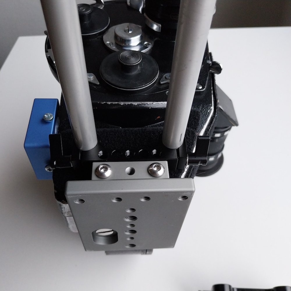

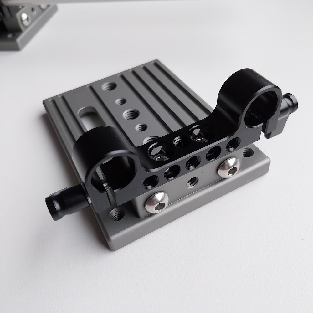

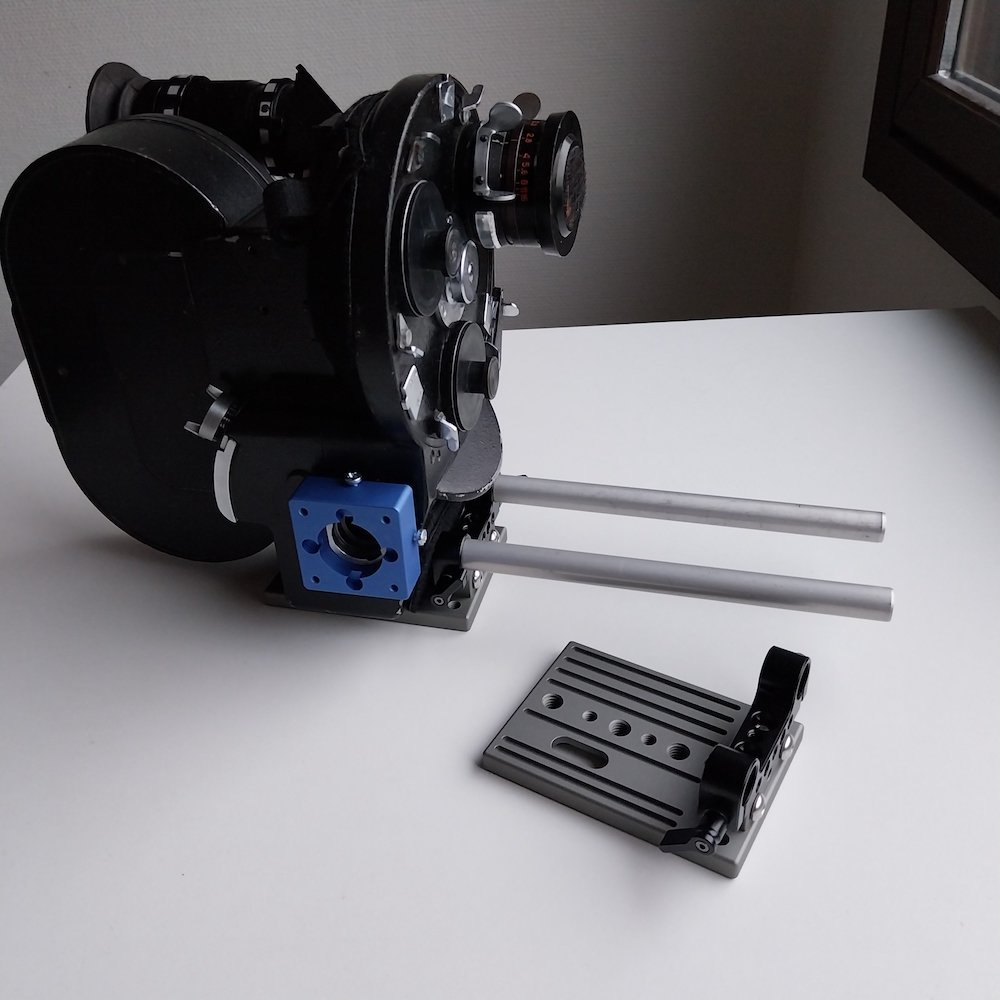

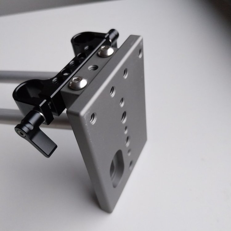

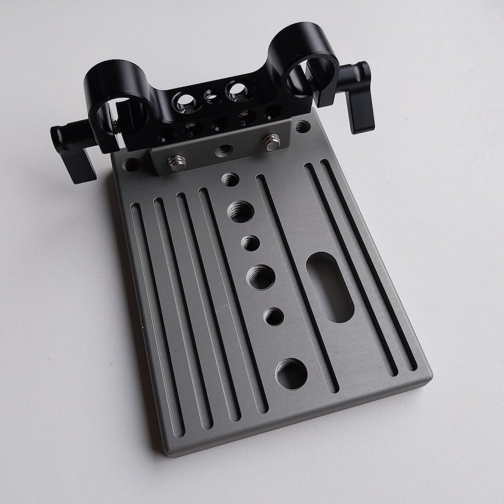

Premium Member Aapo Lettinen Posted December 16, 2025 Premium Member Posted December 16, 2025 Just designed this heavy duty plate for my Konvas 1M. 15mm rods at correct height and centering. The multiple tripod mounting threads on optical axis rather than the one offset thread the camera originally has. lots of extra 1/4" mounting holes to add heavy duty handles or a set of additional rods, or for rigging this to a car etc. The plate is fastened to the camera so that the rod mount is in contact with the camera's front part, thus preventing pretty well the plate from twisting even when it is only mounted with one screw to the camera body. Plate is mainly meant to be sold at very good package price with my Konvas motors but it is possible to purchase these separately too if needed. Probably will include a set of basic black aluminium rods with the plate but will see if getting orders for these. 1
