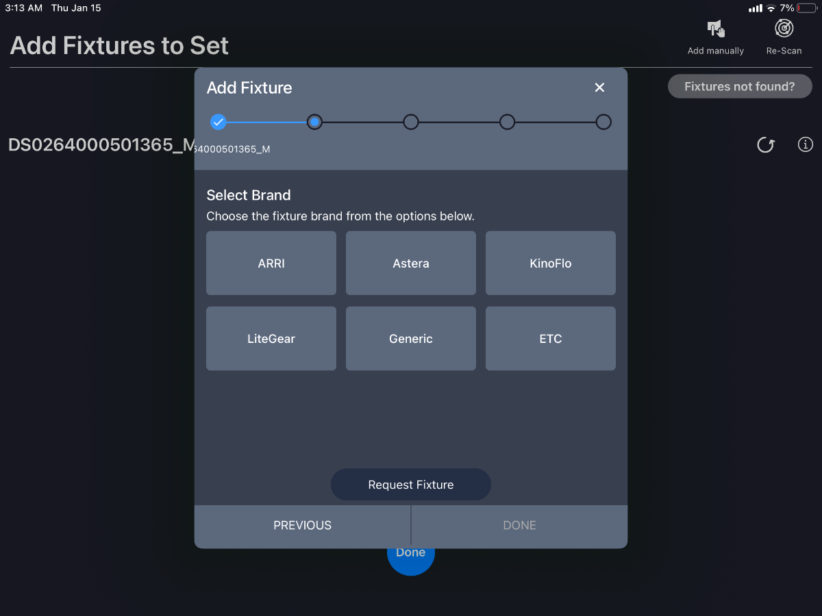

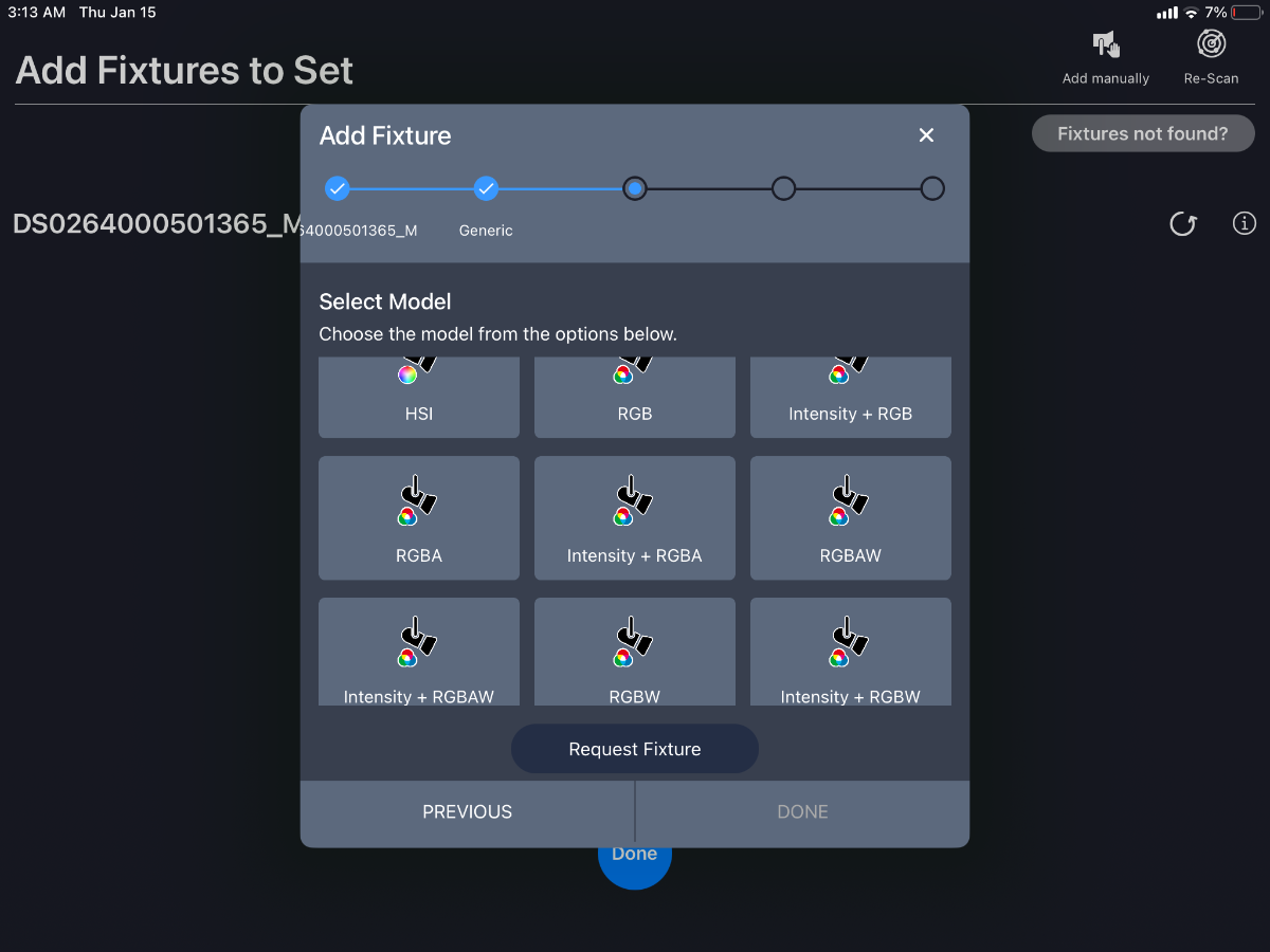

Brandon Obey Posted January 15 Posted January 15 11 hours ago, Bob Beresh said: If it’s any consolation, that Voyager could probably be used standalone and connected to Stellar. After hacking around a bit, I found that the profile which gave me the best response was iRGB 8. Think this is an ArtNet DMX protocol, but I’m talking out my ass mostly so it could be something else. Connect phone to the Digital Sputnik WiFi. Disregard the “no internet” message. Open Stellar and add a custom fixture. Too good a fixture to be sitting idle. Which profile are you selecting? See photos

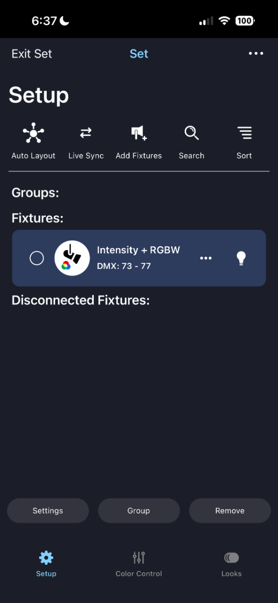

Bob Beresh Posted January 15 Author Posted January 15 3 hours ago, Brandon Obey said: Which profile are you selecting? See photos For the DS-1 series I have, I selected “Generic” then “Intensity+RGBW” and had a play around with the correct DMX channel and universe number to match the setup on the fixture’s display.
Brandon Obey Posted January 15 Posted January 15 2 hours ago, Bob Beresh said: For the DS-1 series I have, I selected “Generic” then “Intensity+RGBW” and had a play around with the correct DMX channel and universe number to match the setup on the fixture’s display. Copy will give it a try. Also heard of a way to use them using the Luminar app also
