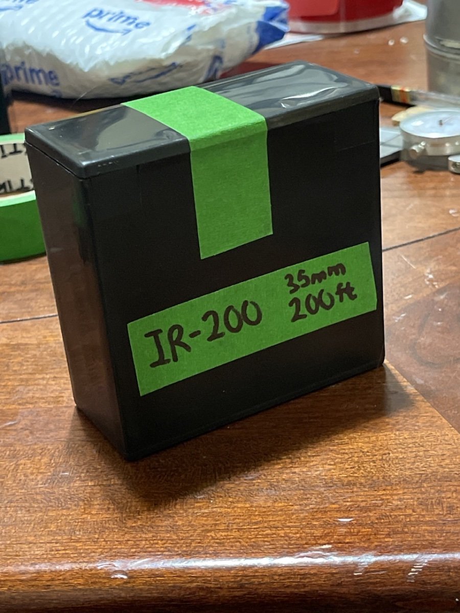

Logan Harmon Posted February 21 Author Posted February 21 The film is here! It’s on a metal spool and I put about 10 ft extra on for threading. Hopefully that’s enough to get 2 minutes of usable footage. Recently learned that apparently you can use tape-spliced leaders with these cameras, would love to do that, but unfortunately I just can’t justify spending $100+ on a tape splicer at the moment… oh well. Hopefully I’ll get the camera sometime this spring. Wish me luck! 1

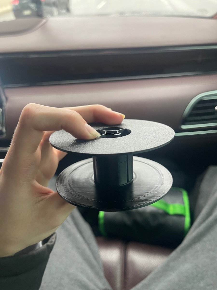

Logan Harmon Posted May 9 Author Posted May 9 (edited) I thought you guys might be interested in this, but I wasn’t sure if it really deserved its own thread, so I’ll just put it in here since we were talking about spools anyway. I made a 3D model of an Eyemo spool using ISO specifications and a couple of metal spools that I have access to, and I had my school print it out of black Bambu ABS on their X1E. The print came out extremely well, no warping, dimensions are accurate, and the flanges are light tight. In theory, you should be able to spool 100 feet of 35 mm film onto this and treat it as a normal Eyemo roll. I might publish the 3D print files at some point once I know for sure that it does work in the camera, as I have not used it in an actual camera yet. I don’t see any reason why it wouldn’t work in a camera, but you never know. Hopefully I will have a camera in about two weeks. Edited May 9 by Logan Harmon
