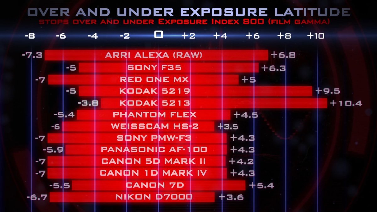

Karim D. Ghantous Posted March 4 Posted March 4 21 hours ago, Tyler Purcell said: If there was a subject close to the lens, you'd see it immediately. I have the same lens, it 100% distorts on 16mm with close subjects. As it should! As all lenses should (save for a type called 'rear telecentric' which I don't think we can use for photography). 7 hours ago, Tyler Purcell said: 50D is nice, but it doesn't have the detail in the blacks of 250D, so if I'm shooting indoors and have enough light for daylight stock, I generally shoot 250D. It really captures way more shadow detail. If only Zacuto tested 5203. But you are onto something because 5219 and 5213 are arguably over-rated by maybe two stops or more. I wonder what 5203 would show. From 2011: 1

Premium Member Tyler Purcell Posted March 4 Premium Member Posted March 4 (edited) 14 hours ago, Karim D. Ghantous said: If only Zacuto tested 5203. But you are onto something because 5219 and 5213 are arguably over-rated by maybe two stops or more. I wonder what 5203 would show. From 2011: 19' has the most middle ground dynamic range, more akin to a digital imager. However, the middle grey is shifted down slightly compared to 200T, which means it has less highlight retention. I think nearly all the color negatives have the same amount of physical dynamic range. The difference is really just where the optimal middle grey is. Some stocks put it higher up on the dynamic range chart than other stocks. 50D for instance, if you over expose it a bit, like 2 stops you can easily retain more black detail and make the stock perform more like 250D. If there is nothing in the shot that would be clipped by doing this, then it's a win-win for the filmmaker. However, with 250D, you don't NEED to do that. If you expose perfectly, you can still nail the blacks. That to me is the biggest difference and the game changer when shifting to 250D. You don't have to worry AS MUCH about the blacks. The tungsten stocks work the same way, 200T is more like 50D and 500T is more like 250D. I use 500T very sparingly on 16mm, I generally use the daylight stocks for everything unless I'm completely stuck like when I need to use night time practical lights. I also only use 250D when I know 50D won't cover me for whatever reason. Even my last shoot in the snow, we started rolling at 7am in a snow storm, with cloud cover and I was at 2.8. So the only time you really need faster "daylight" stock is shooting indoors or in substantial shadow areas like forests. So most of my 16mm work is 50D with the occasional 250D or 500T. I know the color science of 200T is very nice and smooth, I have shot with it a bit, but I just prefer the crisper 250D with better black retention. I also prefer not to run filters, I will bring the right stock for the job. That's the nice thing with quick change mags, if you need to quickly change stocks, just swap the mag. On 35mm, I shoot 250D or 500T mostly, tho my last personal 35mm Love, Frog we got a few cans of 200T and I used it for nearly all of the interior scenes. I regret the decision, but at the time we didn't have any options as I overshot my 500T stock and couldn't afford more. Edited March 4 by Tyler Purcell 1
