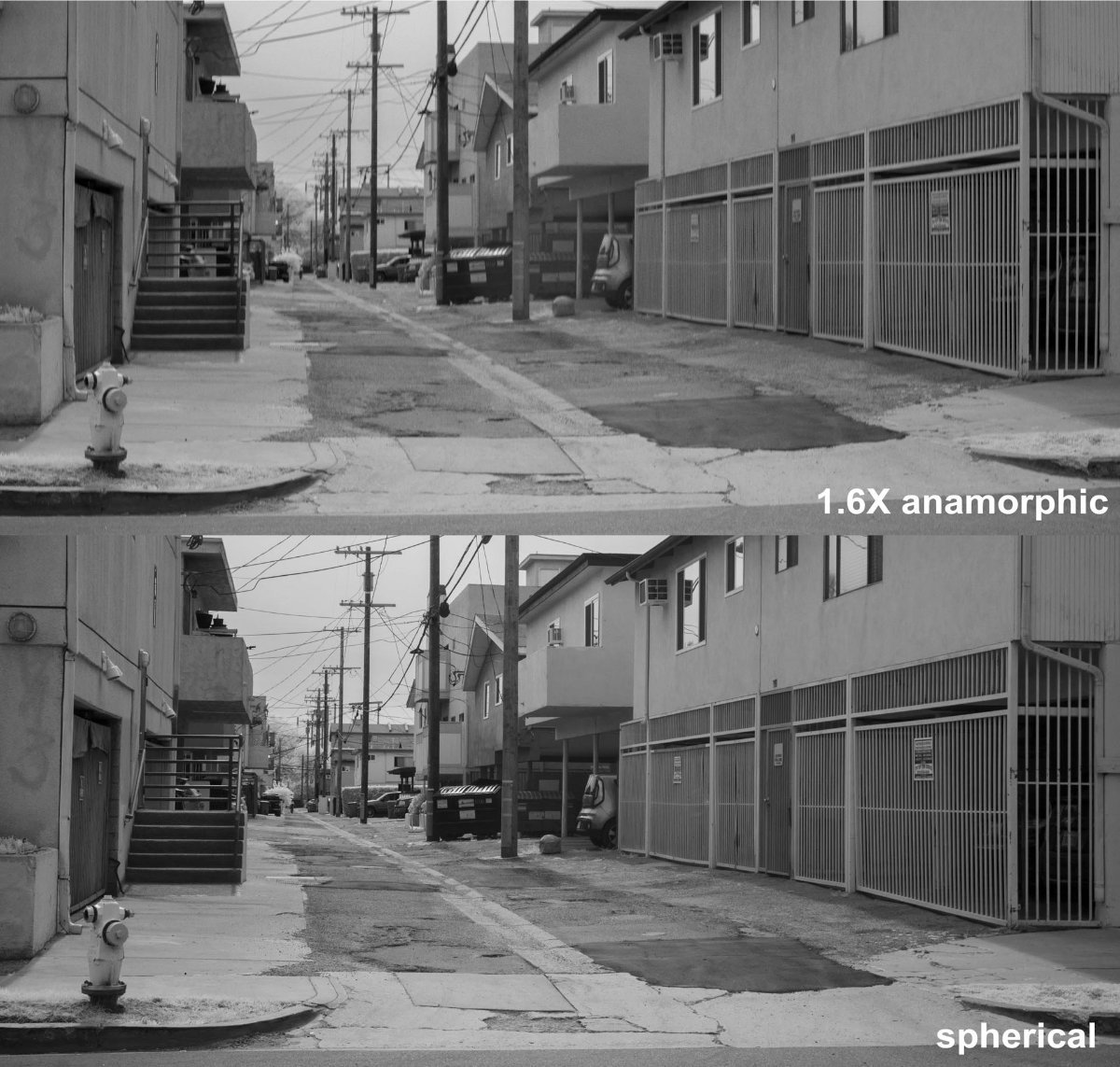

Premium Member David Mullen ASC Posted April 5 Premium Member Posted April 5 Tried to find something online to show you that the two match
Premium Member David Mullen ASC Posted April 5 Premium Member Posted April 5 I have a 50mm 1.6X Sirui e-mount lens but now I only have an infrared Sony to put it on... but here is a comparison where I eyeballed the spherical zoom lens to around 32mm to match the 50mm 1.6X anamorphic. But I had to crop the spherical lens image vertically to match aspect ratio. You see that the horizontal and vertical information are roughly the same.
Pete Huffman Posted April 6 Author Posted April 6 Oh wow... Thank you so much for your time on this. I really appreciate the extra work you did to show me this visually. I need to rethink how i go about this. I like the extra character that anamorphic gives, but it looks like my original idea is not accurate. This brings me to another question. When hollywood went anamorphic (to compete with the 4:3 TVs that were popping up in everyone's home, from what i have read), how come they went this route instead of just using wide angle lenses and cropping the top and bottom off. I think some people did this on 35mm without an anamorphic lens. Why all the fuss with squeezing and then de-squeezing?

Pete Huffman Posted Wednesday at 08:39 PM Author Posted Wednesday at 08:39 PM Thanks David, I tried a test, But it was close as i only have a 35mm Anamorphic (1.6X) and a 24-70, so i couldn't get down to 22mm but i can see what you are saying. Kinda bummed. But it looks like i can save some money on a quest for wide field of view by just getting a wider lens. And i can dedicate that time to learning how to edit better. Thanks for your time and explaination. Pete
