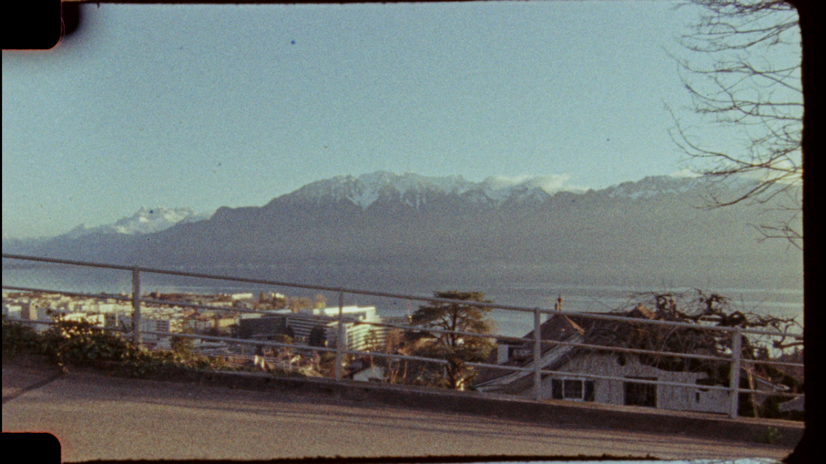

Premium Member Aristeidis Tyropolis Posted April 9 Premium Member Posted April 9 (edited) Hello all, As promised I am posting my film test on the NC200. Personal impressions: FIlm looks like from 70's, so nice and weird but alot of grain. Film has a "blue" tendency? A lot of color "breathing". Stability is good, haven't noticed any back and forth. Compared to something like 50D, or 250D it is of course as if coming from the stone ages. Overall, I'd definitely use it again and probably will order some more as I really enjoyed how it looks it that context. Apologies for alot of shakey, non-focused shots it really was done in difficult circumstances. Edited April 9 by Aristeidis Tyropolis 2

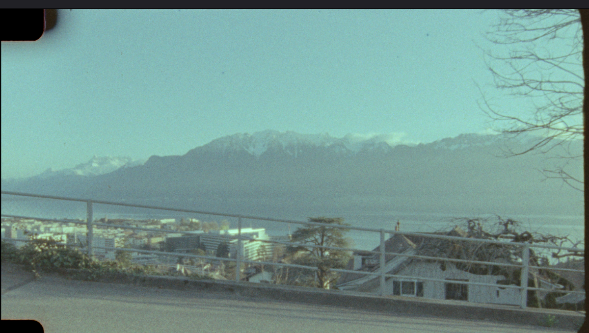

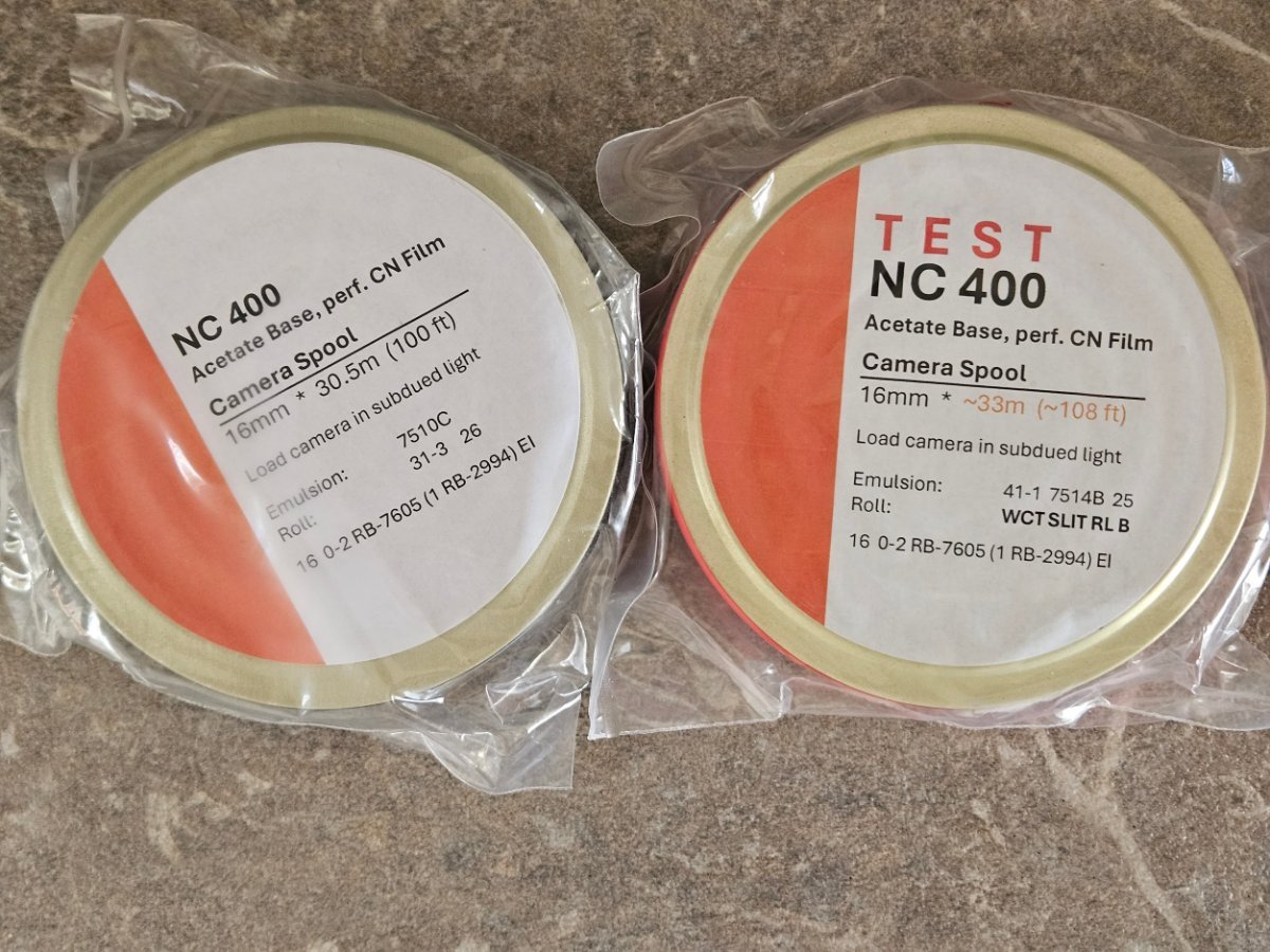

Premium Member Tyler Purcell Posted April 9 Premium Member Posted April 9 Looks like whoever scanned your film, didn't balance it properly in the scanner. I found with NC500 and NC400, the scanner needed to be setup entirely differently than Kodak. Every other NC200 test I've seen, is BY FAR the best version of their color stock, but your footage doesn't look anything like the scans I've seen. I've also included my NC400 test which looks way better. https://umbrella.style/blog/2025-10-16-orwo-wolfen-nc200-first-impressions/ 1
Premium Member Aristeidis Tyropolis Posted April 9 Author Premium Member Posted April 9 11 minutes ago, Tyler Purcell said: the scanner needed to be setup entirely differently than Kodak. Probably, since I also have NC500 footage, It needed a bit of extra color balancing as well (not as much as the NC200), but it's ok really, this is just like a quick color grade, so in the end if you sit and balance it yourself it doesn't matter all that much. No need to put the scanning people through all that trouble for maybe minor improvements vs balancing myself, I didn't even tell them anything = my grade still has a bit of turquoise in the sky, which I found interesting, but you can tweak that further to your liking as below: I think it's a film that doesn't try to be exact in any way, so it kind works itself out.
Premium Member Aristeidis Tyropolis Posted April 9 Author Premium Member Posted April 9 (edited) This is how it looks in a Davinci YRGB Color Managed timeline completely ungraded Edited April 9 by Aristeidis Tyropolis

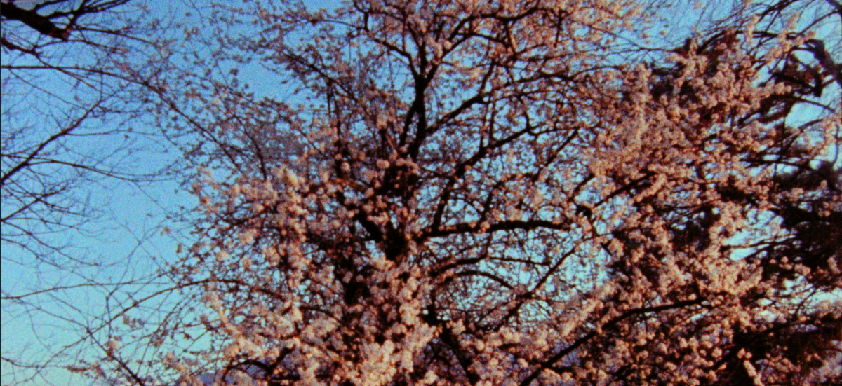

Premium Member Aristeidis Tyropolis Posted April 9 Author Premium Member Posted April 9 And then the grade: So now that's different again - whilst being similar in some fundamental ways.
Premium Member Aristeidis Tyropolis Posted April 9 Author Premium Member Posted April 9 I updated the video to reflect that color management, as I think it's a bit more "neutral" overall to what the stock wants itself to look like. 1
Premium Member Tyler Purcell Posted April 9 Premium Member Posted April 9 (edited) The turquoise color was baked into the original scan. They must have set the color based on the first frame and walked away. Edited April 9 by Tyler Purcell
Premium Member Tyler Purcell Posted April 9 Premium Member Posted April 9 2 minutes ago, Aristeidis Tyropolis said: I updated the video to reflect that color management, as I think it's a bit more "neutral" overall to what the stock wants itself to look like. Much better! 1

Premium Member Tyler Purcell Posted April 11 Premium Member Posted April 11 (edited) 7 hours ago, Mark Wiggins said: We’ve had this debate before.🙂 And we had different results from our testing I seem to remember. Yea, the film manufactured on their coater in Germany, seems to pretty good. I don't believe they are coating everything on that machine, only small batches for testing. So the pre-release stock, seems to have a totally different feel to the final release stock as a consequence. Also, if the film is getting X-Ray damaged when shipped outside of Europe, that's a major problem. 7 hours ago, Mark Wiggins said: I think ORWO are a work in progress. I think they are moving in the right direction. I particularly like their black and white stock UN54. Coating black and white vs color is like going to near earth orbit vs going to the moon. 7 hours ago, Mark Wiggins said: Also the stability issue seems to be more about the fact that the stock is thinner than Kodak stock (and I’m talking microns) which is what was causing the stock to weave in the gate. Na, we measured the film, the width changes. That's why it works on pin registered 35mm cameras, but not non-pin registered 35mm cameras that use the side edge for registration. 16mm pin registration doesn't account for left and right weave, so SR's will still struggle. The thin film should only have more float, which means a bit more nose. I've run 2 x 400 of NC500 and 2x 400 NC400 through my XTR Prod and Beaulieu R16. Results of both stocks had similar issues. Edited April 11 by Tyler Purcell
