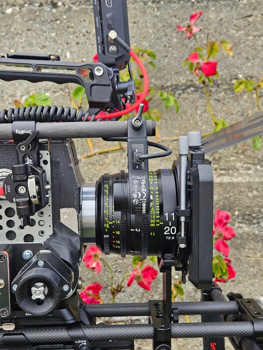

Premium Member Aristeidis Tyropolis Posted May 24 Author Premium Member Posted May 24 (edited) Part Three Shooting is continuing normally, interviews and b-roll at different times. A few changes: I decided to switch the main lens used from the Tokina 11-16 (which is now for sale) to the Tokina 11-20. I was really mostly happy with it but I was missing a bit of extra throw and better flare control. I am really happy with its operation and have shot quite alot. footage is not processed yet, so let's how it looks when everything is said and done, as I have alot of footage to dispatch this week. Following up with a bit of "meditative" stuff that was really just me testing various film stocks, camera and configuration. I think I am really liking 50D after shooting 400' of it. All audio is recorded on location and music is mine: (Stocks are 050D, 250D, 200T, Wolfen 200) Edited May 24 by Aristeidis Tyropolis 1
