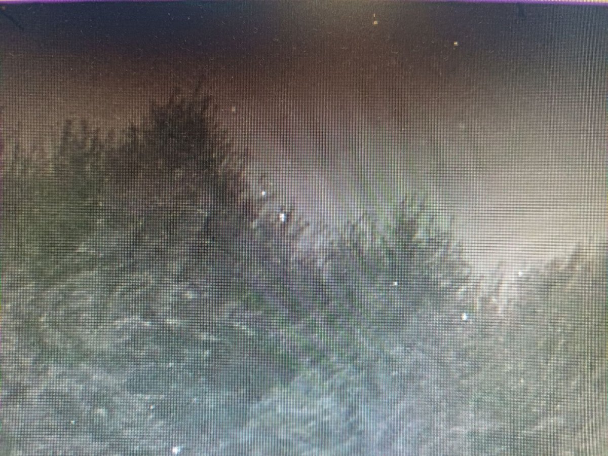

Thanks for the positive comments.  I received some scanned film back today of the film I processed, it is a low res rush curtesy of Kritikem (formerly Neglab in Sydney) .  I added the link: https://youtu.be/gDHxZf-jm7A
I am happy with the result, the development appears consistent, no issues that indicate poor processing, developing, fixing, washing, etc.  I did however see lots of tiny white specks throughout, I reckon this indicates my wash vats have dust (dev and fixer are filtered) and possibly my drier vat is allowing dust in.
Despite this, I am confident I am close to a professional result.
