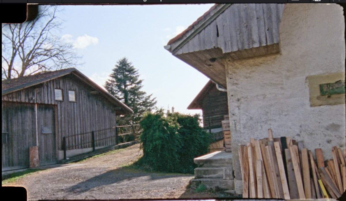

Premium Member Aristeidis Tyropolis Posted May 22 Premium Member Posted May 22 (edited) 3 hours ago, Tyler Purcell said: I have never once seen ultra 16 without scratches of some kind in the picture area, but again in a 4k workflow. 4K ProRes on 27' Wide Gamut. Three different shots Not seeing it Tyler. If I need a loupe to find AFTER seeing it in 4K on a proper monitor and can't find it, it's a Schrödinger's scratch and the scratch exists in some quantum superposition and needs investigating - I will survive. Edited May 22 by Aristeidis Tyropolis
Premium Member Tyler Purcell Posted May 22 Premium Member Posted May 22 What was it scanned with? Some scanners with diffuse light and/or IR pass, can hide light scratches in the scan.
