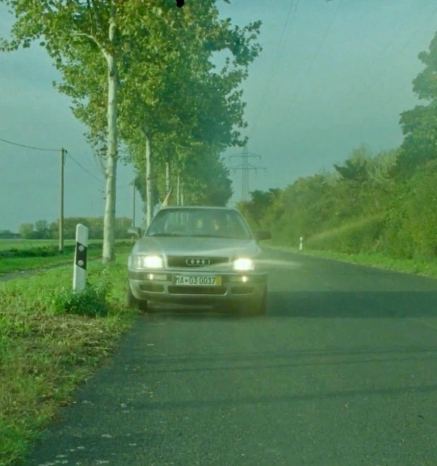

Daniel Schurr Posted May 12 Posted May 12 Hi everyone, my name is Daniel, I’m 21 and pretty new to shooting film. I inherited an Arriflex 16BL together with an Angenieux 12-120mm, and I’ve been shooting on Kodak Vision3 200T. I’m running into a problem with very strong halation/blooming around bright artificial light sources like spotlights, practicals, headlights, etc. The glow can get pretty extreme. Since I’m a complete beginner, I’m not sure if this is normal for the lens/film combination, if something could be wrong with the lens coating, or if I’m doing something incorrectly. Does anyone have tips on how to reduce it a bit? Would using a different lens help, or is this mostly just the nature of the older Angenieux zooms? I’ve heard people recommend the Zeiss 10-100mm — would that make a noticeable difference? Any advice would be greatly appreciated. Thanks! Daniel

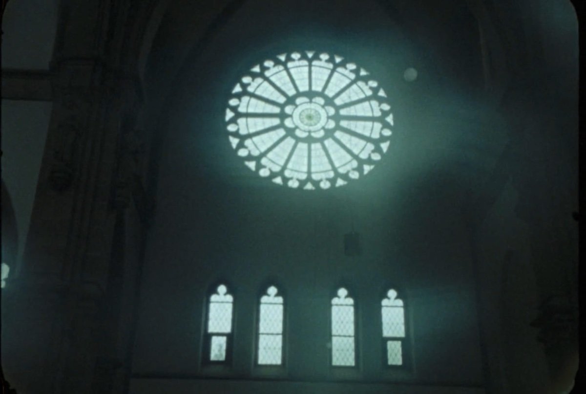

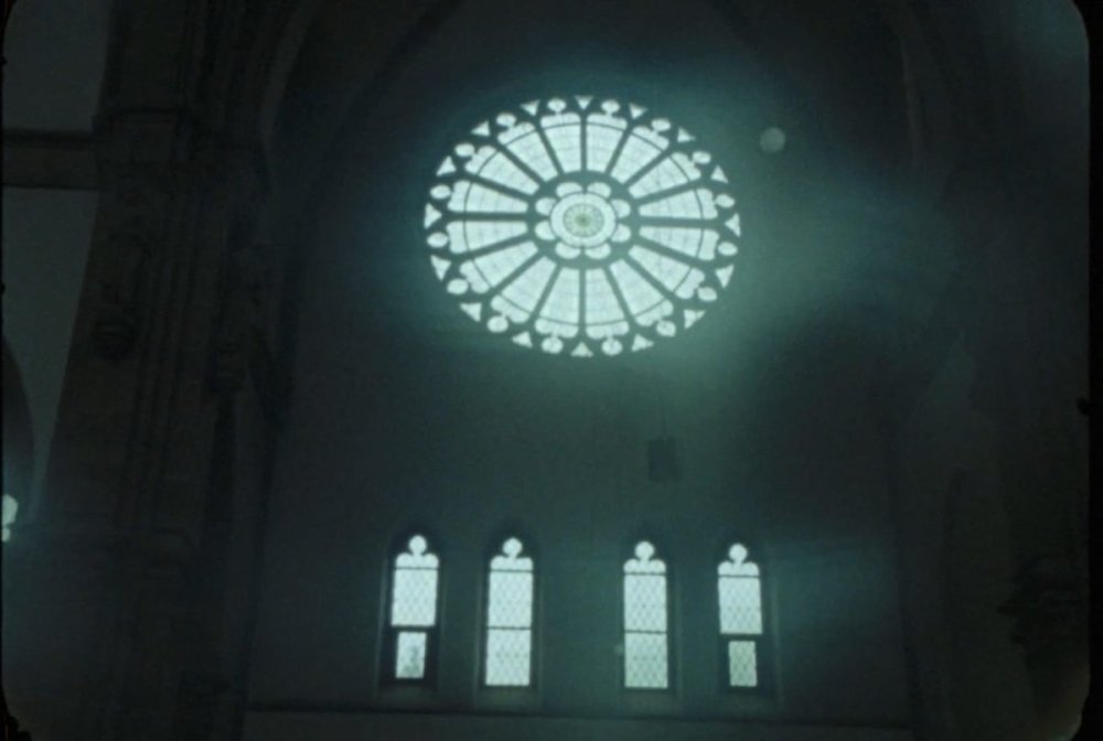

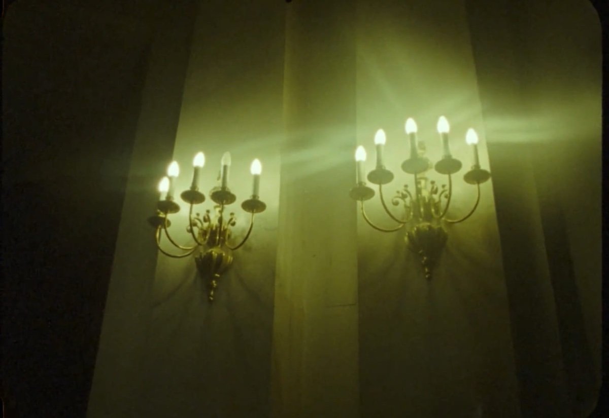

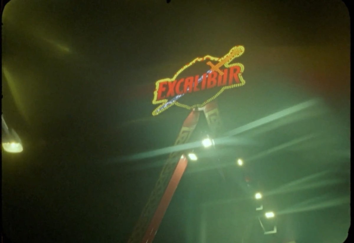

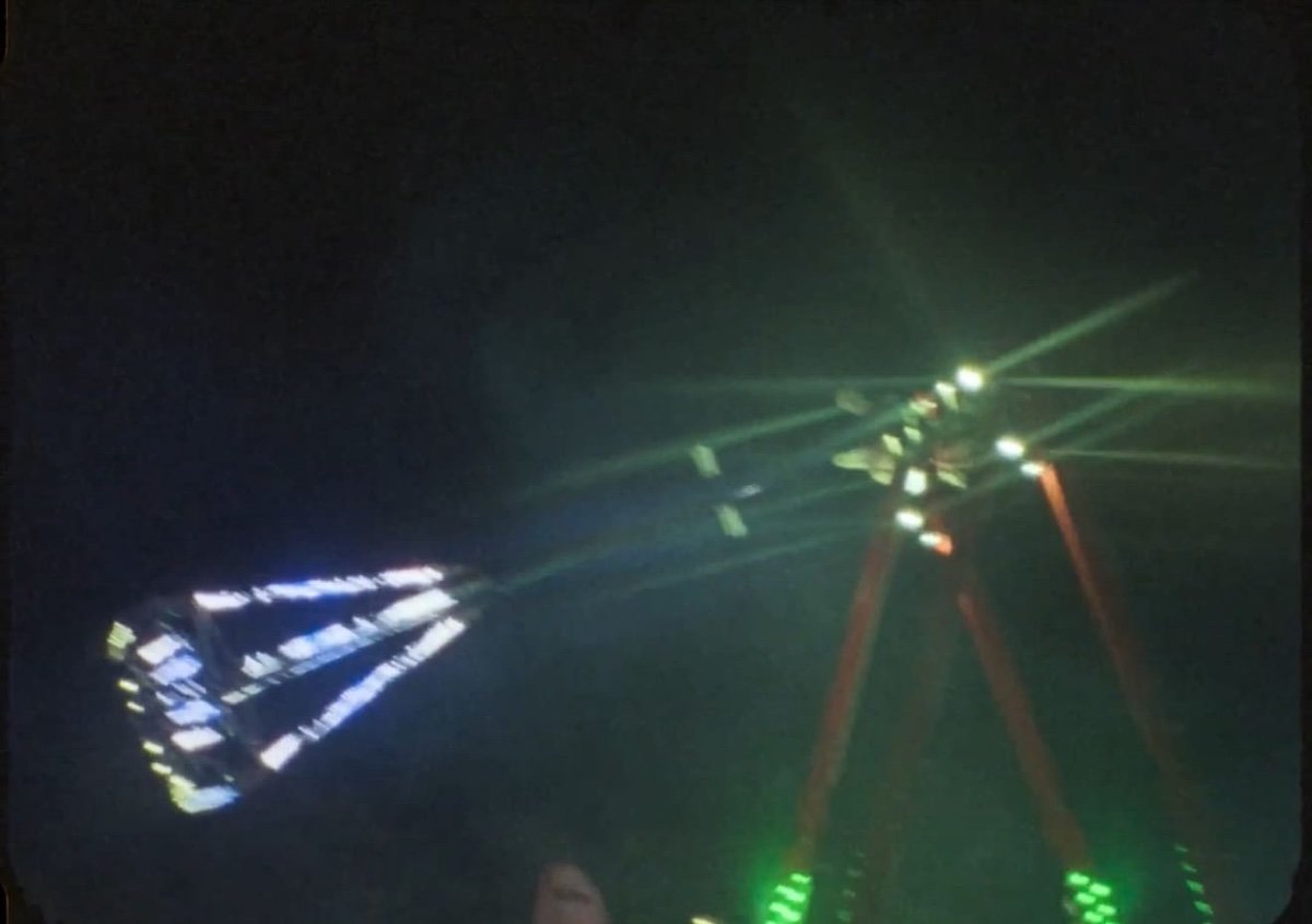

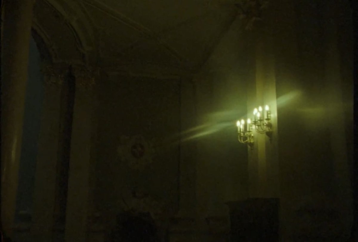

Daniel Schurr Posted June 19 Author Posted June 19 I’ve attached a few screenshots. Please excuse the poor image quality, but the issue should still be visible. I’m a complete beginner when it comes to filmmaking, so I’m not sure whether this is normal or not. The lens is clean and was professionally cleaned by a specialist a few years ago. Thanks Daniel
Mark Dunn Posted June 19 Posted June 19 The 12-120 isn't the best lens in the world but this isn't normal. The flare is asymmetrical to the right so I think a lens element is displaced. Could be some of the black paint is missing, but it seems worse than that. I'm no expert btw. You'd expect some flare in most of your images but the exterior with the car is particularly bad. Those streaks simply shouldn't be there.
Premium Member David Mullen ASC Posted June 19 Premium Member Posted June 19 Some of it looks like a lens that has been roughly cleaned too many times and is abraded across the surface, like a vaseline smear effect - or it is actually an oily smear across the front or back element. I'd hold the lens up against a light and look carefully at the front and rear surfaces.
Daniel Schurr Posted Wednesday at 07:02 PM Author Posted Wednesday at 07:02 PM Thank you very much for your comments. I checked the lens again very carefully, but I couldn’t find anything wrong with it. I am planning to replace it with a Zeiss 10–100mm lens in the future
