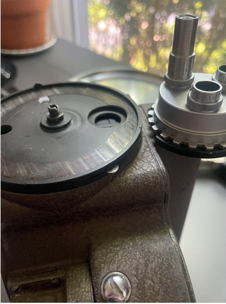

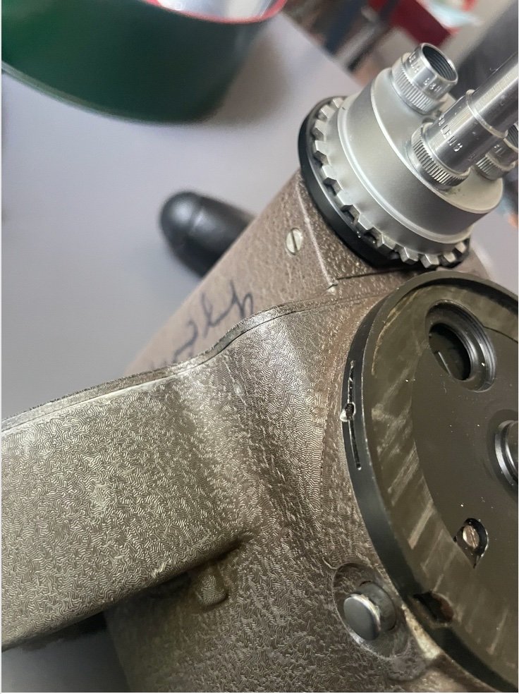

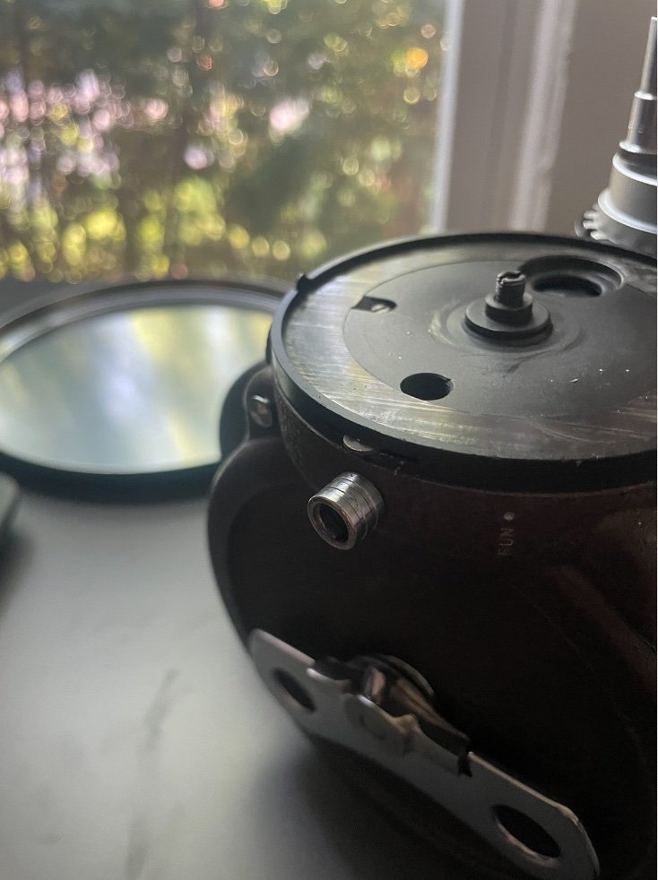

Cole Seidl Posted May 18 Author Posted May 18 4 minutes ago, Dom Jaeger said: It must be quite a deformation if the gears to the finder disengage, they're several mm thick. Surely you could see that? A picture might help. If the turret is deformed, it's very hard if not impossible to get it perfectly flat again. And of course the turret controls flange depth, which should be accurate to 0.01mm. So you won't be able to trust the lens focus marks. But Filmos are pretty tough, so I'd be surprised if it really is that bent. Here's a gallery of 4 pictures: https://postimg.cc/gallery/51gSMcV You can see the black that is normally covered by the turret exposed at one point, but the more I turn the turret the more the black is hidden. I've also included two pics to show where the gears are engaging/disengaging based on where the turret is in its rotation. And yes, this looks much more extreme than the turret disk does by itself when separate from the camera, which is where some of my confusion comes from. Maybe there's something else damaged that I'm missing?

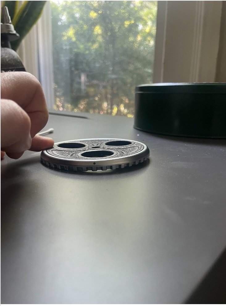

Cole Seidl Posted May 19 Author Posted May 19 A few things I've observed. The turret certainly seems a bit bent. I've added an image of me laying it flat on a surface. Also there appears to be a small missing metal disk that should be holding the turret in place a bit more. There are 3 slots, and two of them have the disk protruding, but one is missing. I think possibly this is making matters worse
