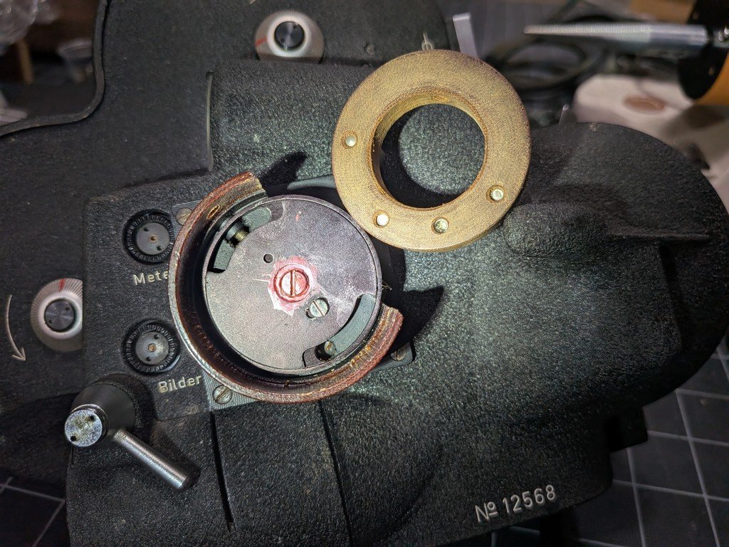

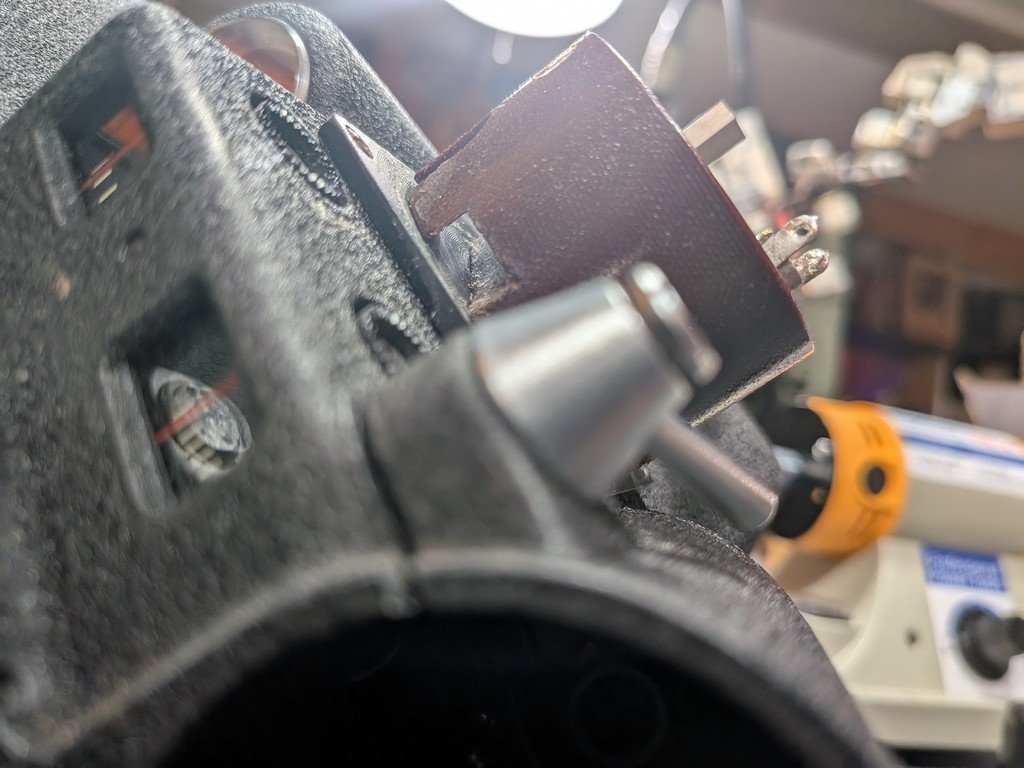

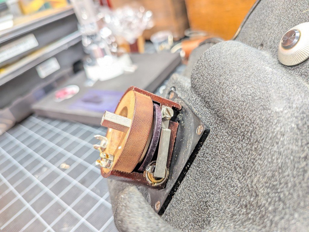

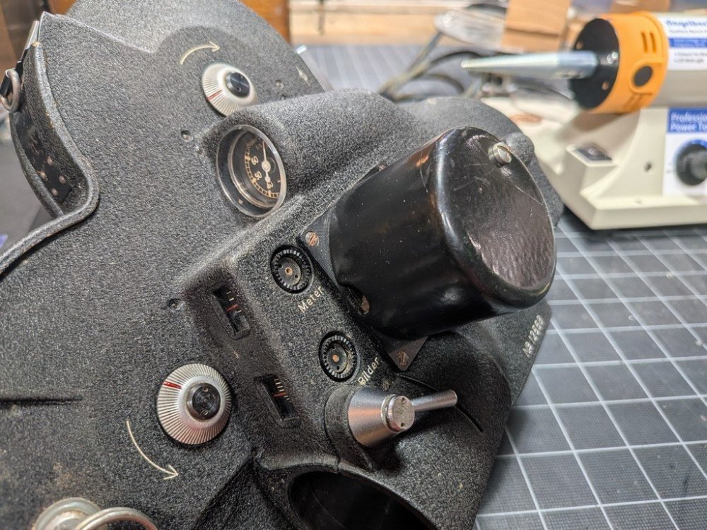

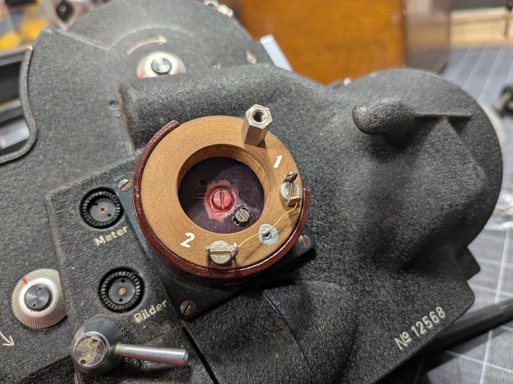

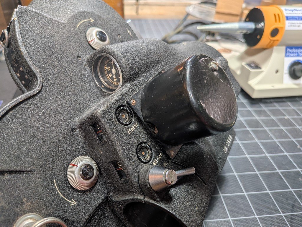

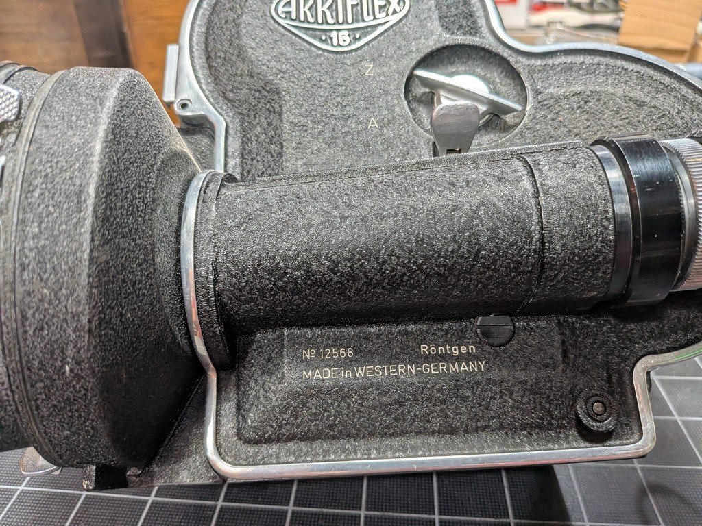

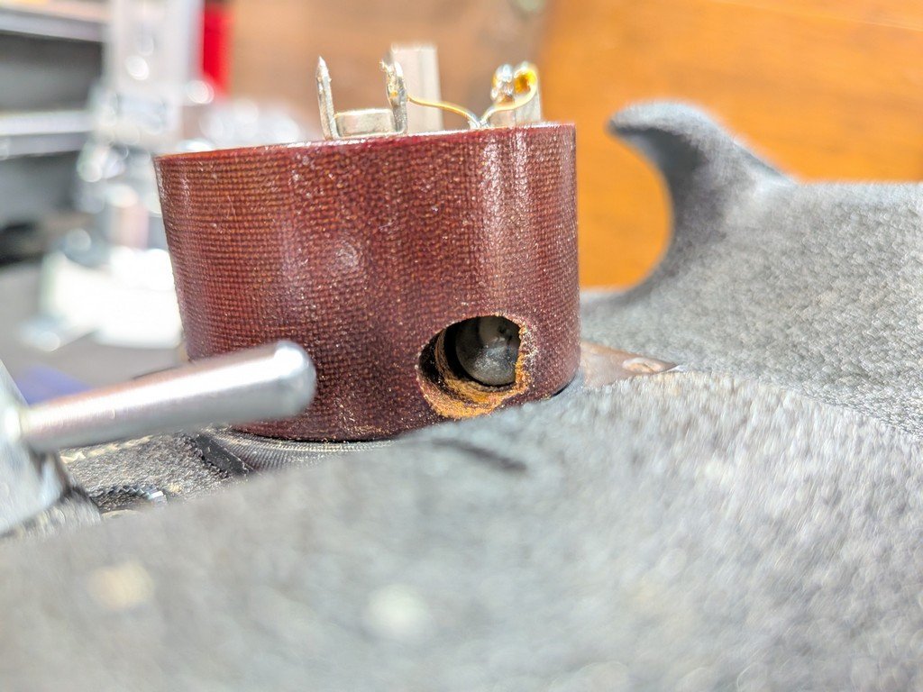

Premium Member Sean Charlesworth Posted June 2 Premium Member Posted June 2 (edited) I have an ARRI ST labeled 'Rontgen' - I know that usually means they were for medical/scientific use. It also has an odd side attachment I have never seen. It looks a lot like a sync generator and runs off the camera transmission as well. It has a opening on outer edge that leads into a square hole in the device. It also has a lamp, spinning shutter and what looks to be some type of photoelectric? sensor in the top ring. Curious if anyone can identify this guy. Edited June 2 by Sean Charlesworth 2 1

Joerg Polzfusz Posted June 3 Posted June 3 (edited) I only found information about the 35mm versions: From some Arri brochure (https://www.munichimaging.de/wp-content/uploads/2020/03/Brochure_ARRI_Medical_Surgical-Imaging_German.pdf ) In der Medizintechnik war ARRI bereits 1970 tätig. Die analoge Kamera ARRITechno 35 war eine der meistverkauftesten Kameras für den OP. Sie war die erste und einzige Röntgen-Filmkamera, die in Zeitlupe bis zu 160 Bilder pro Sekunde aufnehmen konnte. Weltweit wurden 13000 Kameras in der Angiokardiografie eingesetzt. Translation: ARRI had already been active in the medical technology sector as early as 1970. The ARRITechno 35 analogue camera was one of the best-selling cameras for the operating theatre. It was the first and only X-ray film camera capable of recording in slow motion at up to 160 frames per second. A total of 13,000 cameras were used in angiocardiography worldwide. ——————— More information: https://cinematechnic.com/arri-35iic-rontgen-medical-camera/ No clue whether the 16mm version also has been integrated into some X-ray unit and whether it was also designed to shoot at 160fps… Edited June 3 by Joerg Polzfusz
Fabian Schreyer Posted June 3 Posted June 3 The interesting thing is that the well known 35mm Röntgen (X-ray) versions do not have a viewfinder installed. This one has though. I can only imagine that it is a single unit that they built for a customer. Also, for some reason the buckle witch override button is not installed on the door.
Premium Member Sean Charlesworth Posted June 3 Author Premium Member Posted June 3 (edited) Yeah and typically they would be painted gray. The removal of buckle is odd as well. Otherwise the camera appears to be stock but will know more once I open it up. 3 hours ago, Fabian Schreyer said: The interesting thing is that the well known 35mm Röntgen (X-ray) versions do not have a viewfinder installed. This one has though. I can only imagine that it is a single unit that they built for a customer. Also, for some reason the buckle witch override button is not installed on the door. 5 hours ago, Joerg Polzfusz said: I only found information about the 35mm versions: From some Arri brochure (https://www.munichimaging.de/wp-content/uploads/2020/03/Brochure_ARRI_Medical_Surgical-Imaging_German.pdf ) In der Medizintechnik war ARRI bereits 1970 tätig. Die analoge Kamera ARRITechno 35 war eine der meistverkauftesten Kameras für den OP. Sie war die erste und einzige Röntgen-Filmkamera, die in Zeitlupe bis zu 160 Bilder pro Sekunde aufnehmen konnte. Weltweit wurden 13000 Kameras in der Angiokardiografie eingesetzt. Translation: ARRI had already been active in the medical technology sector as early as 1970. The ARRITechno 35 analogue camera was one of the best-selling cameras for the operating theatre. It was the first and only X-ray film camera capable of recording in slow motion at up to 160 frames per second. A total of 13,000 cameras were used in angiocardiography worldwide. ——————— More information: https://cinematechnic.com/arri-35iic-rontgen-medical-camera/ No clue whether the 16mm version also has been integrated into some X-ray unit and whether it was also designed to shoot at 160fps… Edited June 3 by Sean Charlesworth
Joerg Polzfusz Posted June 3 Posted June 3 One question is: Is 16mm X-ray good enough for medical purposes? Or was this more for industrial purposes, e.g. X-raying goods on an assembly belt for quality checks? (120m of 16mm = more than 1400 single photos)
