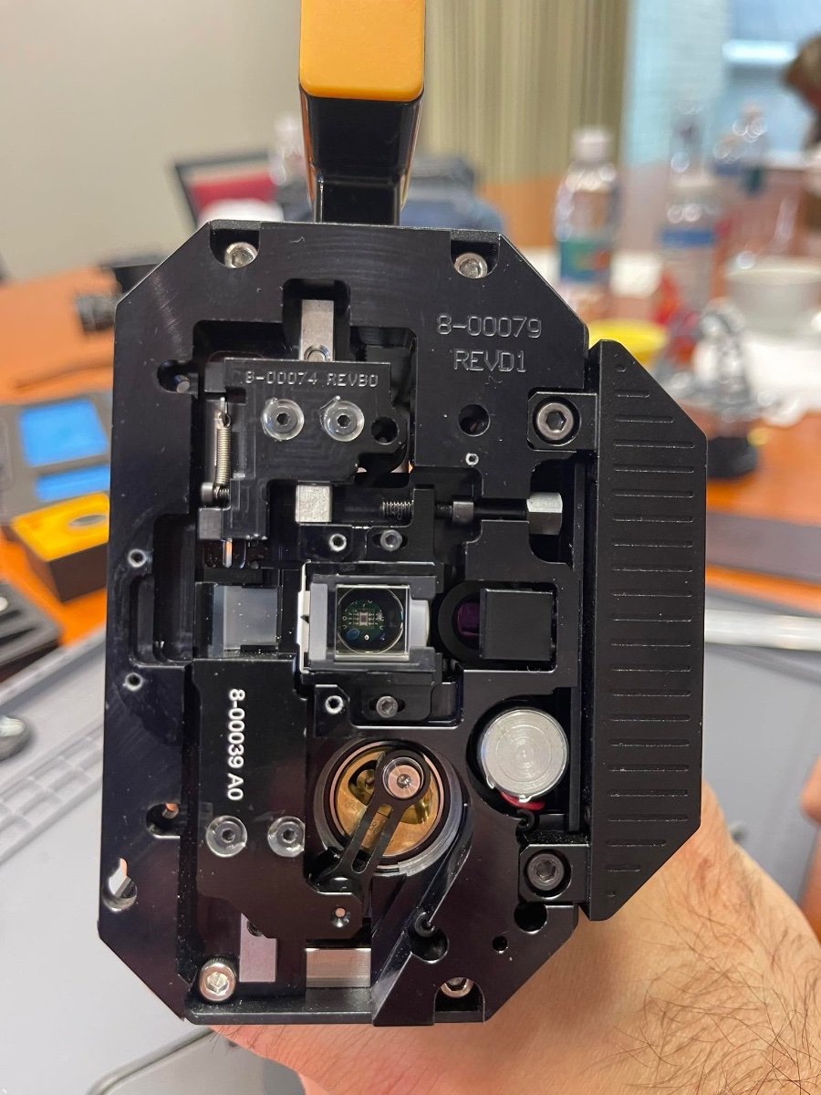

Brandon Paterno Posted June 5 Posted June 5 this would be awesome without a digital sensor. the digital sensor takes the place of an optical viewfinder. the digital stuff seems to be the main focus and the magazine looks a bit like an unsightly growth. like holy shit! that gate is so deep inside the camera body. bet that’ll be fun wonder what sensor they’re using/who they’re contracting. i love that they’re throwing in some little film gimmicks like hand crank emulation, even if 99% of everything shot with it will be going straight to a hard drive. at rental house prices how will they get people to trust its reliability?

Gautam Valluri Posted June 8 Posted June 8 21 hours ago, Robin Phillips said: he real question is did anyone get to check it out at cinegear? Here's an interview with one of the founders of cinelux, I didn't quite understand what he said about the double capture. Is he saying that he replaced the groundglass with a digital sensor? So the film part of the camera is filming it off of a screen of some sort? Does that mean you could slap a LUT onto it and then film it on 16?
Robin Phillips Posted June 8 Author Posted June 8 interesting. at 1min 24 sec you can see there is a sensor reflected in the shutter. so no ground glass
Jon O'Brien Posted June 8 Posted June 8 So it looks like a conventional film camera, with a spinning mirror deflecting light onto a sensor, where the groundglass would normally be. Surely a sync sound timing difference between the film and digital capture would be an easy fix in post. It's a clever idea. Regarding making a camera quiet, I've loaded and run a Panavision Millennium XL-2 and it was so quiet while running at 24 fps that you had to lean your ear right into the body, just inches away, to hear a thing. I was amazed at how whisper quiet it is.

Brandon Paterno Posted June 9 Posted June 9 (edited) watched the interview, the film side just doesn’t seem to exist yet. they’re aiming for a launch late next year. ergonomically the thing looks questionable, but with proper sound deadening/mechanical isolation i’d assume the whole things gonna balloon up a bit, maybe for the better. it seems like they’re selling to those that won’t stand for an image pickup traveling through ground glass optics? the sensor is 3k because it is quite literally cropped only to pick up a super 16 area over a 4:3 sensor. it will be interesting to see if they leave the option of opening the digital gate to the entire sensor width. regardless, hopefully they continue their campaign and continue to build traction/buzz. Edited June 9 by Brandon Paterno

Premium Member Tyler Purcell Posted June 14 Premium Member Posted June 14 17 hours ago, Simon Wyss said: Kodak has the same arrangement with its latest Super-8 camera, a mirror shutter reflex system in combination with a digital sensor. The Kodak camera works like a standard motion picture camera, with the video assist shooting the ground glass. The new camera does not do this at all, it's entirely different. The video camera is at the same focal plane as the 16mm imager, no ground glass, no optics outside of the mirror shutter. Thus, the film gets 100% the same image as the digital imager and visa versa. This has never been done before on ANY motion picture camera.
Steve Switaj Posted June 14 Posted June 14 16 hours ago, Tyler Purcell said: The video camera is at the same focal plane as the 16mm imager, no ground glass, no optics outside of the mirror shutter. Thus, the film gets 100% the same image as the digital imager and visa versa. I wonder why they went with a spinning mirror? Yes, it's traditional , but it's going to make things more complicated for a camera that wants to be equally good at delivering a digital or film image. First, it's going to affect your exposure timing, you're going to get 180 degrees max minus whatever the shutter "clearing time" is over the gate. It looks like a vertically running shutter and a 16mm frame is only about 7.6mm tall, so that may not be a big issue, but it will prevent you from going over, say, 170 degrees while running film. Second, you're trying to make a high-quality digital image off the moving mirror parh, which, in my experience, is usually not the best optical surface in the world. I feel like every film camera I've ever handled eventually develops some sort of damage to the mirror. It's usually slight, but it's there. Dust gets into the port when you change the lenses, bits of stuff get stirred up by the air currents in the box because of the spinning mirror, some of this dirt clings tenaciously to the mirror, maybe because of static. Sometimes the AC's get a little to enthusiastic about cleaning in there. The front-surface mirror is insanely easy to damage and almost impossible to clean well without something exotic like CO2 dusting. You get the idea. Even in normal service with conscientious operators the mirror eventually shows some defects, and you can often see it through the finder as you inch the camera slowly. This does not matter in normal operation, since the finder image is just for the operators, but if you're trying to make a for-real picture with it... it's probably going to show. Tyler, I suspect this might be the right place for your pellicle camera to shine. Beamsplitters have their issues, and we've talked about them here, but in this application the trade off might be worth it. A beamsplitter would have the same problems with dust and dirt and scratches as a mirror, but a well-designed system could make a pellicle swap-out for a fresh one quick and straightforward, something you could do at the camera truck. The Fries R35 conversions did this successfully back in the 90's. A beamsplitter would also decouple the timing requirements between the film and video sides, not to mention how much more straightforward the mechanical design would get. 1
