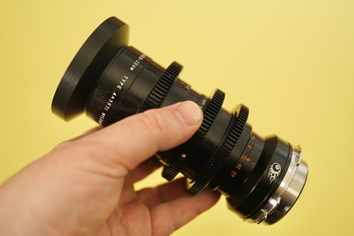

Premium Member Daniel J. Fox Posted Wednesday at 07:13 PM Premium Member Posted Wednesday at 07:13 PM Hi Daniel Of the three lenses you mentioned • Cooke Speed Panchro Series III 25mm f/2 • Angénieux Type LA2 35–140mm f/3.5 • Zeiss 85mm f/2 I've used / owned all three. You're looking at three of the classic cine lens brands, all which have their own look and feel. The Zeiss is the cleanest, the Angenieux zoom has the most "character". Of the three I have the most experience with the Angenieux 35-140mm, which was the first zoom made for 35mm cinematography back in 1958. It's so small you'd swear it was made for 16mm - light weight and with lovely rendering. To have decent resolving, you need to stop it down a bit and it's weak at the 140mm end, but it's really a lovely compact zoom. I had my copy modded with a shimmable PL mount by BurningEye AV in the Netherlands, with custom gearing and we use it alongside rehoused Angenieux cine primes.
Premium Member Daniel J. Fox Posted Wednesday at 07:15 PM Premium Member Posted Wednesday at 07:15 PM The rendering especially at mid range distances is really beautiful, just don't expect good close focusing, for that you will need a prime.
