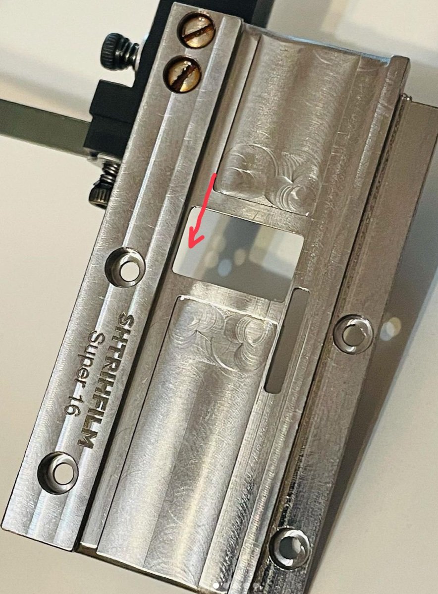

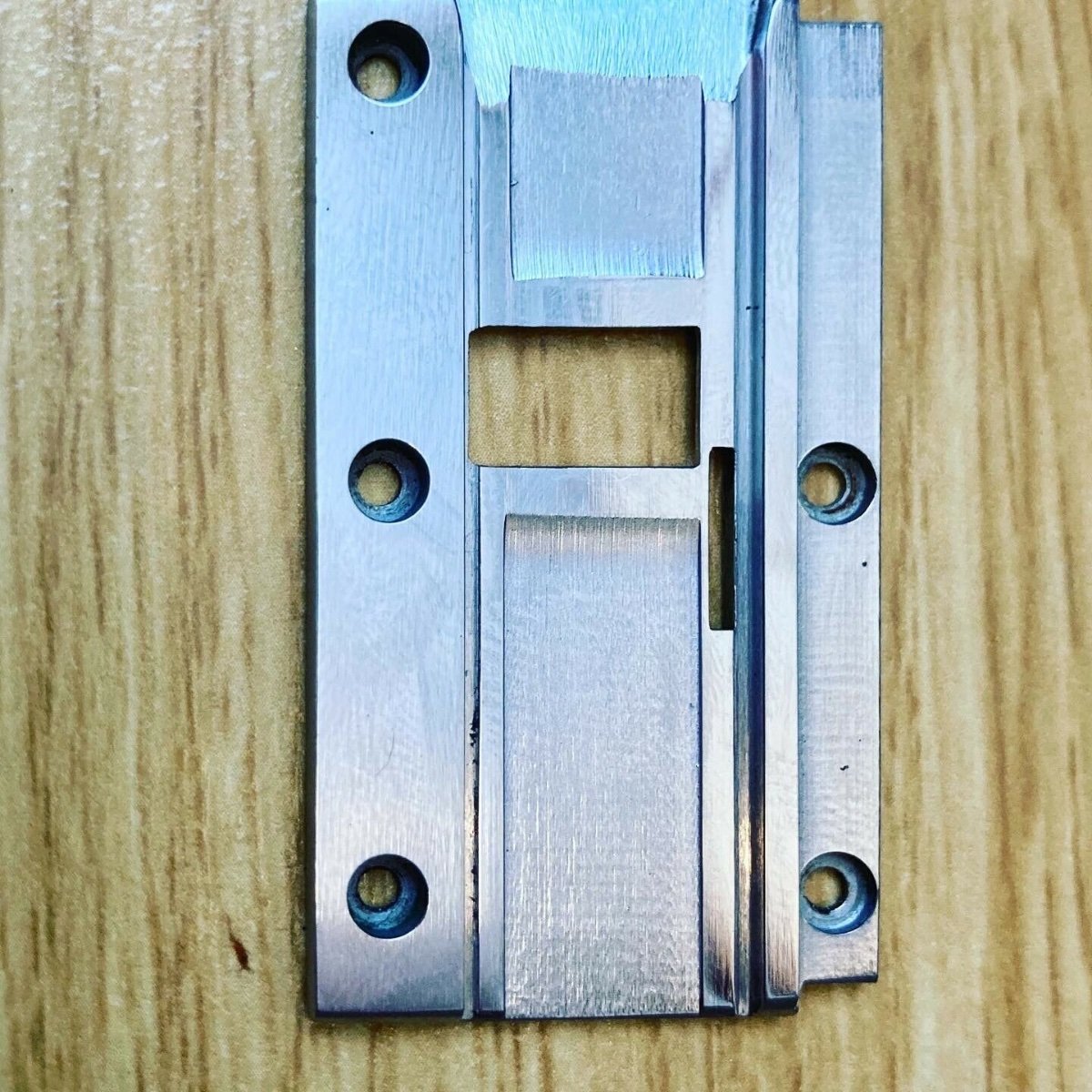

Premium Member Dom Jaeger Posted July 28 Premium Member Posted July 28 1 hour ago, Aapo Lettinen said: The proper S16 conversions of the K3 use newly made gate plate which entirely replaces the old N16 one. The original gate is really difficult to modify to S16 without making it scratch wildly. One can order the newly made gates from couple of FSU country sellers and if they modify the cameras then they usually install a newly made gate. Yes, the channels on the sides means the original gate modified to S16 looks like this: The support rail on the left just stops then starts again on the other side of the gate opening. Some of the “newly manufactured” S16 gates for K3s aren’t much better: This one has the expanded area of exposed image sliding on the gate support rail.
Premium Member Aapo Lettinen Posted July 29 Premium Member Posted July 29 10 hours ago, Dom Jaeger said: Some of the “newly manufactured” S16 gates for K3s aren’t much better: This one has the expanded area of exposed image sliding on the gate support rail. yes and that machining quality is just depressing... Cheap Chinese places do better on similar kind of parts and I honestly think that it would be better to just design one's own replacement gate than to try to live with these half-working Russian thingys. Like, a gate with properly dimensioned support rail for the S16 area and a side pressure bar to get more stability? it is not much really, takes some days to design properly and couple of tries to get the machining quality right. The Chinese can machine it precise enough if paying for the extra work accordingly and one can manually polish the remaining tolerances out if needed.
