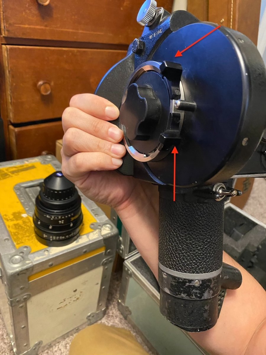

Paulo Arellano Posted July 31 Posted July 31 Hey guys Im trying to fit an Arri Ultra prime on this 2C I got but the lock on the PL mount wont allow the lens to go all the way in, its hitting the aperture ring. Lens fit fine on my Arri BL-3. Does anyone know a place where I can buy a smaller lock? I can see that they can be unscrewed and replaced.
Steve Switaj Posted August 1 Posted August 1 Assuming you only wan to use this lens once in a while, you could probably just remove the ears, put the screws back in, and use it that way for a while
