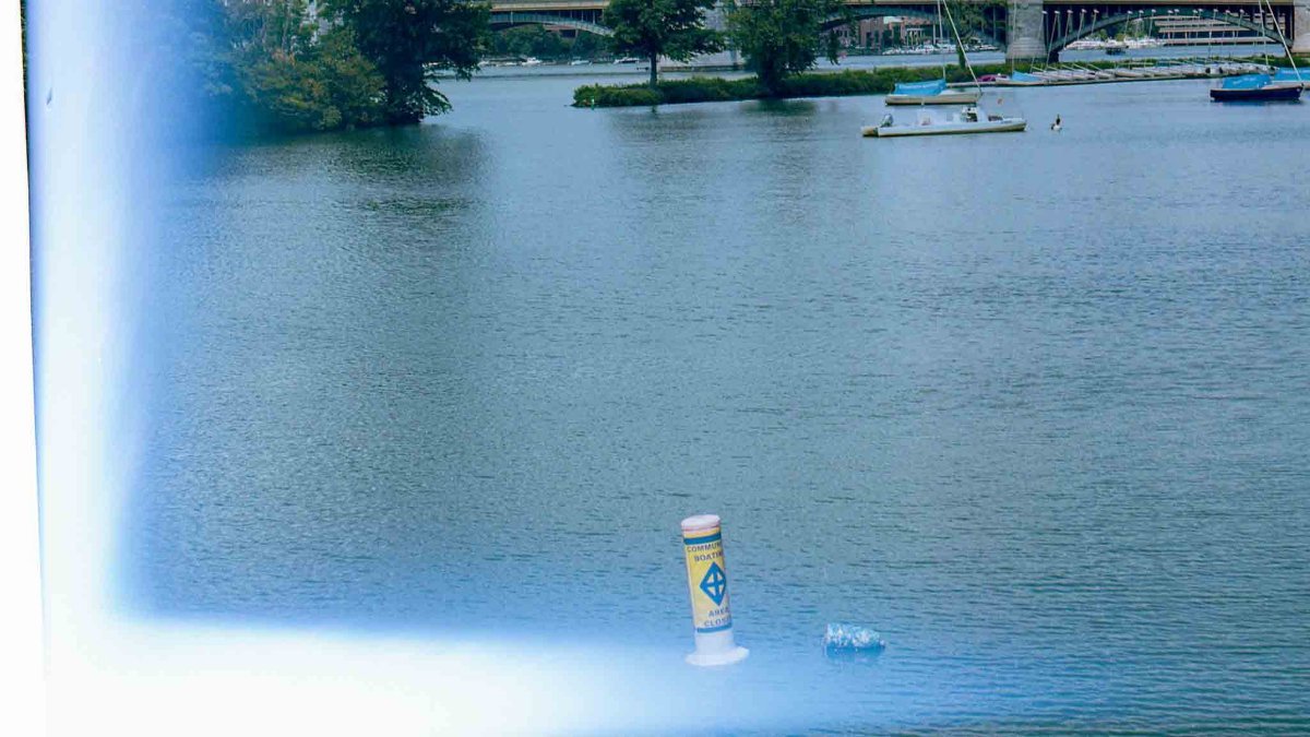

Gabriel Hong Posted August 30 Posted August 30 Getting consistent light leaks and inconsistent spacing on my 6x6 Kiev 88 camera. I'm only able to get 10 pictures out of a 120 roll. Does anyone know how to fix these issues?
Mark Dunn Posted August 30 Posted August 30 (edited) Failed light traps around the dark slide- in your case on the right hand side. The flock/foam material can be replaced, but I eventually had to replace some leaky old 60s Hasselblad backs with newer ones. But you won't have that option as there aren't any newer ones. This sort of thing. https://www.amazon.co.uk/eTone-Pre-cut-Sponge-Replacement-Hasselblad/dp/B0F8NCW35Z?source=ps-sl-shoppingads-lpcontext&ref_=fplfs&psc=1&smid=AOO3IH49XJSPO Edited August 30 by Mark Dunn
Gabriel Hong Posted August 30 Author Posted August 30 9 hours ago, Mark Dunn said: Failed light traps around the dark slide- in your case on the right hand side. The flock/foam material can be replaced, but I eventually had to replace some leaky old 60s Hasselblad backs with newer ones. But you won't have that option as there aren't any newer ones. This sort of thing. https://www.amazon.co.uk/eTone-Pre-cut-Sponge-Replacement-Hasselblad/dp/B0F8NCW35Z?source=ps-sl-shoppingads-lpcontext&ref_=fplfs&psc=1&smid=AOO3IH49XJSPO Thank you for this!
